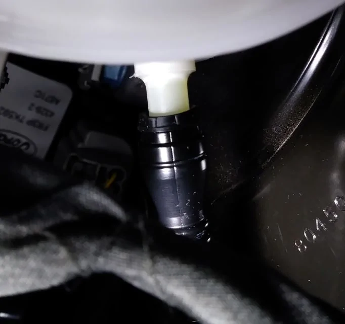

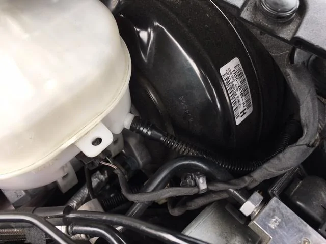

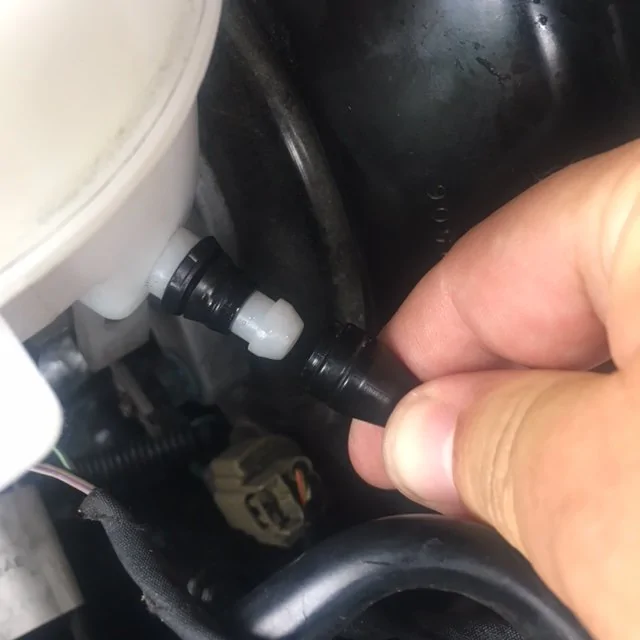

Please look at the following photos for clarification.
Please Inspect Your Mustangs ASAP.
This is the feed line from the brake master cylinder to the clutch master cylinder. This is a quick disconnect fitting/line assembly. If any of you are familiar with Truck Air Brake Systems, Industrial Pneumatic Systems etc. you understand how these fittings work.
The fitting uses a locking ring (the very outer ring on the end) to lock the hose in position. Typically you push this lock ring in towards the hose to release it. (We are not doing that so please don't try it)
What we found tonight was the fitting was almost all the way off the stem of the master cylinder reservoir. I grabbed the hose and it immediately leaked brake fluid, so I pushed it on all the way and it is now locked in position as it should be.
This was verified by [MENTION=14941]apex15stangPP[/MENTION] who was kind enough to provide a picture (First Picture) before he pushed his back into position with the same result, fluid leaking out.
Why this is important to check:
1. If it falls off it will empty a large portion of your brake fluid.
2. If it leaks fluid out when you touch it that means that every time you press your clutch in you potentially could be drawing air into your clutch hydraulic circuit.
This will cause you to never fully bleed your clutch, the more you pump the more you are possibly bringing additional air into the system.
If you have shifting issues, either gear nibble or just really poor gear changes in general, this may be part of the cause. It may not be the MT82 directly.
If you have had a transmission or clutch failure it may be related to a poor release due to the air in the system as the root cause and the contingent damage is the clutch or transmission.
What you want to do:
1. Inspect it, if it looks like the second picture you should be good. Lightly (Everything is Plastic Hercules) pull on the line to see if it is locked into position. DO NOT USE EXCESSIVE FORCE
2. If you find yours looks similar to the first picture, simply grab the hose about 1" from the end and GENTLY push it back onto the stem of the master cylinder. It should look like the second picture. Now perform Step 1.
3. Have a bottle of water handy to rinse off the brake fluid that may leak out so it doesn't damage the paint etc.
If you do not feel comfortable doing this, don't. Bring it someplace (Ford perhaps) and have them check it/repair it.

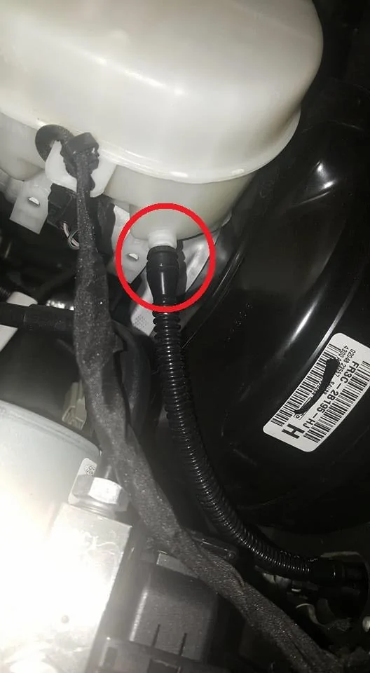

2015 5.0 gt. Mine was like the first pic. I pushed it back in but will try tomorrow to pull it out and see if it comes off or leaks. Going to bed and didn't want to have to clean up a mess. Thanks for the heads up.

Mine was pulled away somewhere between the distances in the first and second pictures. It's kinda hard to tell how long the plastic tube is that's sticking out of the reservoir. I pushed mine in a little more, but it seems like the hose isn't quite long enough to push it in like the second picture shows.

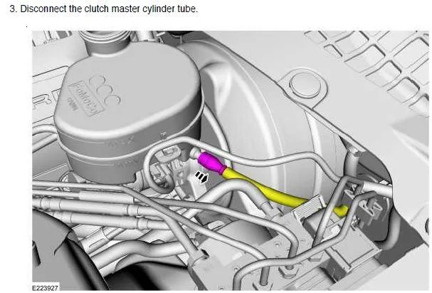

I just checked mine. I pushed on the end of the tube pretty good to see if it would slide any farther on to the nipple, but it didn't seem to move from what I could tell. In fact, it even seeped a very tiny amount (no drips) of brake fluid around the rubber seal on the end of the tube from pushing on it. I could see the rubber seal on the very end of the tube flex a little as I tried to push it farther on the nipple. I measured from the end of the tube to the lip on the nipple and got 8 mm.
I don't see any kind of locking/release mechanism at this connection. The shop manual simply shows that it pulls off and pushes on (see attached).
I suggest people don't pull on it to see if it comes off the nipple, because if pulled hard enough it will pop off ... then you're going to have a mess with paint eating brake fluid.
If anyone does pull the feed tube off, please take a photo so we can see how long the nipple is and if there is some kind of flange on the end to help retain the tube. I have a feeling there's a flange that the rubber seal has to expand and slip over to get the tube on & off the nipple.

Be careful messing with this tube. I pushed on mine pretty hard - enough to make the rubber seal at the end of the tube flex some and seep a little brake fluid - and the tube didn't move any more on the nipple. It's possible that pushing way too hard breaks something which allows it to slide farther onto the nipple than it really should.

Mine was as in pic #1, no fluid leak but there's no slack in that line to push it either.

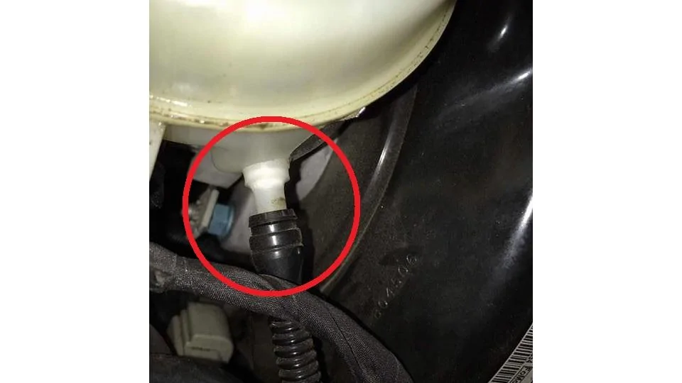

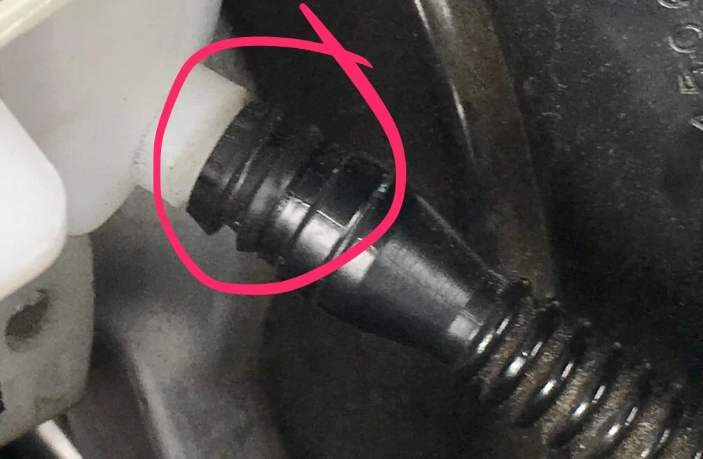

Be careful. Since my car was already down from the slave failing I figure I'd check this. I could see some seeping and barely touched the connection it it came right off. It appears the outer hose is coming loose from the underlying rubber seal. I had to slide the smaller rubber fitting off of the nipple, put it back inside the hose, and re-install. It's definitely tight on the nipple now compared to when it came off.
In the first pic you can see where the outer hose has begun to come loose from the inner gasket/seal/whatever it's called. Just a slight pull and it came right off the nipple, leaving the rubber portion behind.
EDIT: To be fair - I've had my master cylinder replaced by the dealer so my specifics may not be the same as assembly line issues, but it certainly seems awfully similar.

Mine was like the first picture and it took a considerable amount of force (relatively) to get it back up to the top as if the line was too short or something. I've added this to my checklist of stuff to check before each autocross event.... also going to add the oil "cooler" (heater) lines too since there is a recall on some Mustangs made in the later part of 2015 that have problems with hoses coming off or something!
