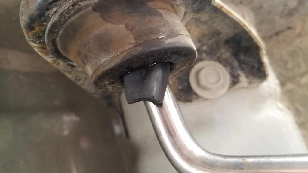

I'm going to do it to my Mustang today because my passenger side sags as well after putting on the SLP LM2 axle back. I'll try and snap some pics if I end up being successful.

Thanks, pics would be great if great if you can. I'm tired of looking at my lopsided exhaust.
Ok here's an update. I tried with the hose clamp, but I expected the exhaust hangers to be different rather than the bolt on type with a bushing. I did get it to bring up the exhaust a tiny bit, but I felt like I was going to cut into the bushing...and the clamp exploded from being tightened to the max basically.
So $5 method does not seem to work. I'm going to try something else though in just a few minutes and will once again report back.
Here's an update.
I just took a rigid vacuum hose, split it down the middle and just smashed it into the bushing of the hanger, obviously you want the hose to be under the metal muffler hanger. It helped a little bit better than the hose clamp, but it's still off by 1/4" from the other side. Temporarily this will work especially if you find a thicker hose. Not sure how long it will kast before the hose flies out but seems to be ok.
Otherwise probably best to have a shop adjust/weld and call it a day. I'm not sure they sell stiffer exhaust hangers for these cars I haven't looked but that's still something to consider.
