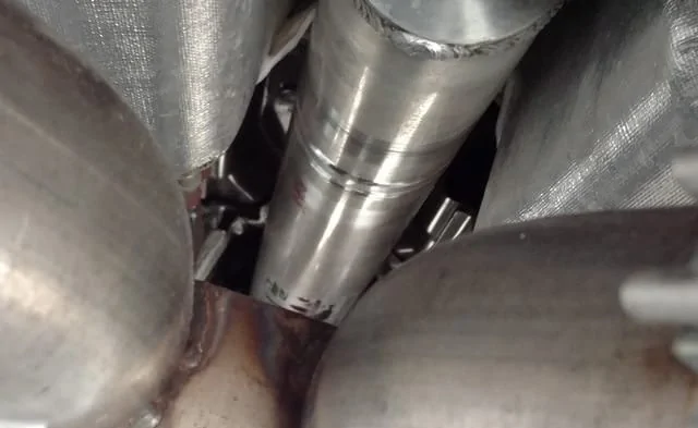

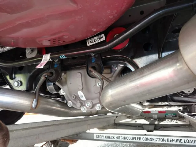

the rear bolts that hold the diff to the IRS cradle sheared off, which are 10.9 grade bolts, the front bolts bent. this caused the rear of the diff to sag ALOT. pitching the front of the diff upward, causing the driveshaft to ride high in the back, high enough that the driveshaft ended up getting 2 grooves wore in it from some bracing that is in the rear part of the tunnel. having the diff in the position it was also caused the halfshafts to ride on the IRS cradle, cutting through the inner boots and causing damage to the inner joints.

the diff and mounting points/bushings in the rear

grooves in the DS
