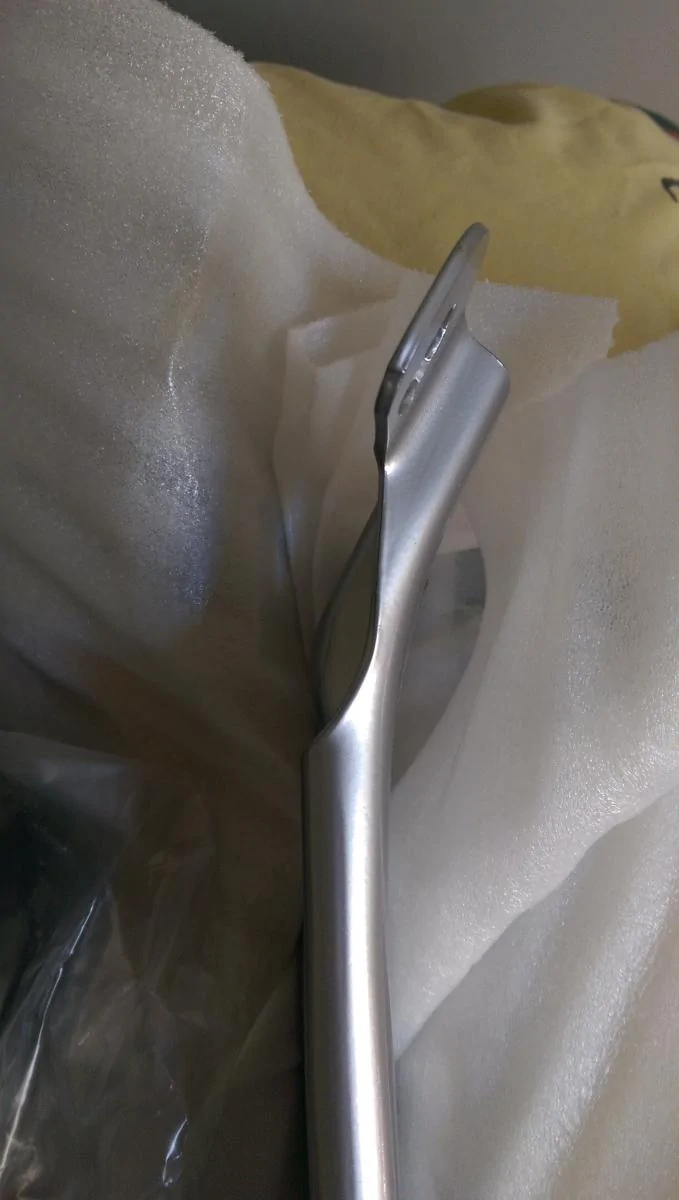

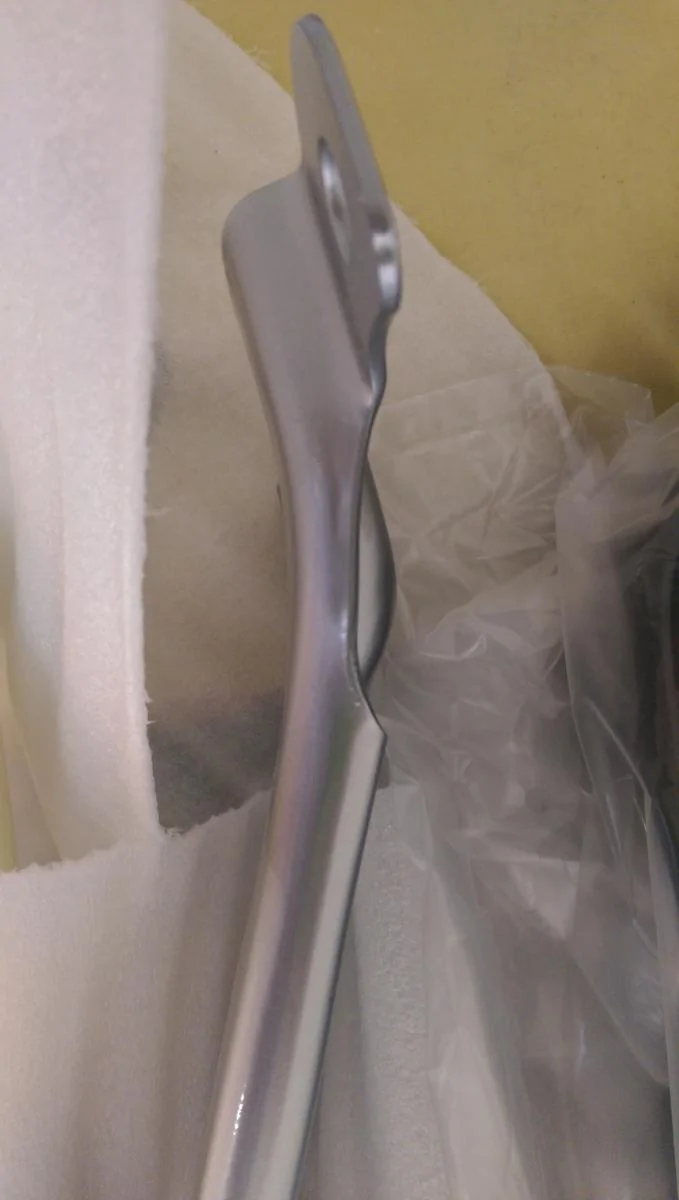

I think I may have found the cause of this problem.
Look at the cutouts on the back of the brace on the left and right sides. One is larger to accommodate the K brace on LHD vehicles.
I think the fix will be to grind the other side slightly to match the profile on the left, which should allow correct clearance around the RHD K brace.
