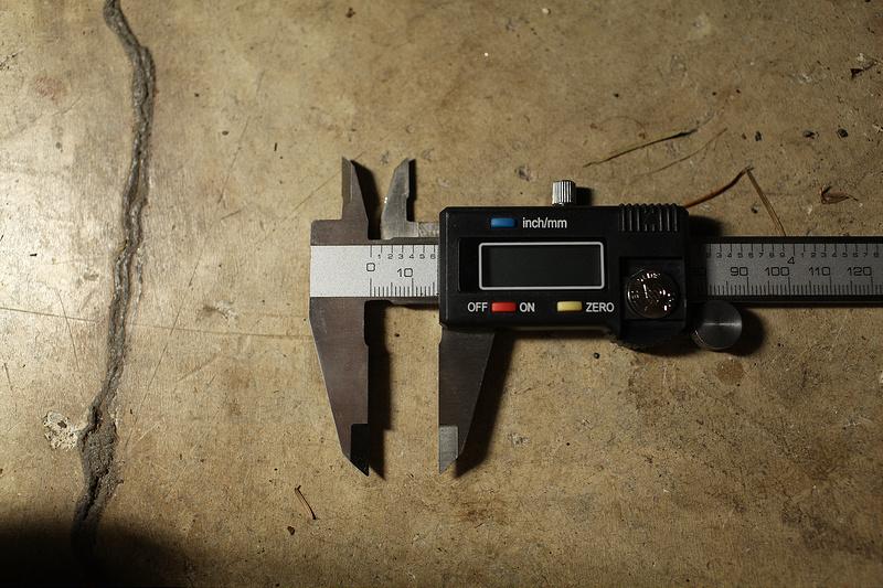

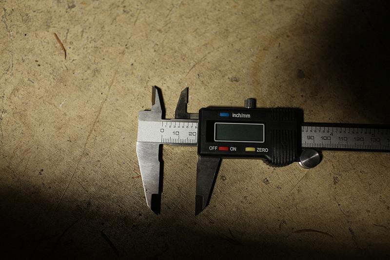

Finally received my GT PP on Friday - so I spent some time test-fitting wheel/tire combos leftover from my wrecked '13 GT Brembo car on the front. I'd heard that there might be issues with barrel clearance for any cast 18" wheel, while 19" shouldn't be a problem. Here are the results:

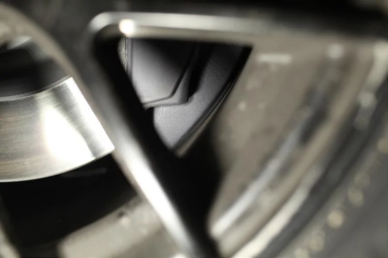

18x9 +35 and 18x10 +43 SVE Drift
Does *not* fit. Caliper interference with the barrel, unable to mount.

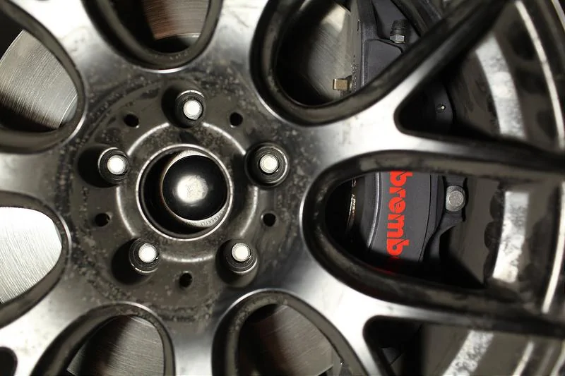

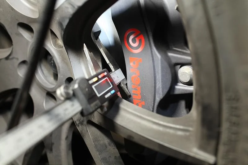

19x9 +42 OEM Brembo Package
Fits. 13mm clearance.

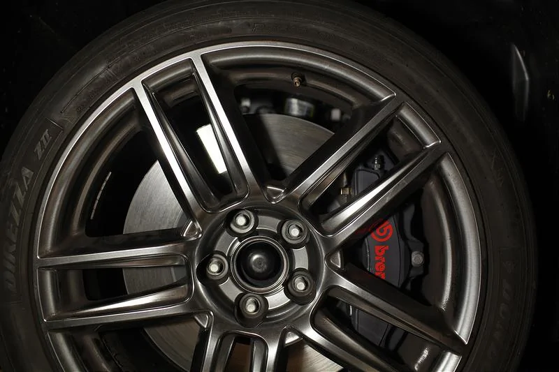

19x9 +42 Boss 302S Replica
Fits. 16mm clearance.

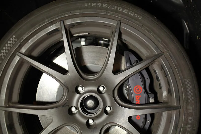

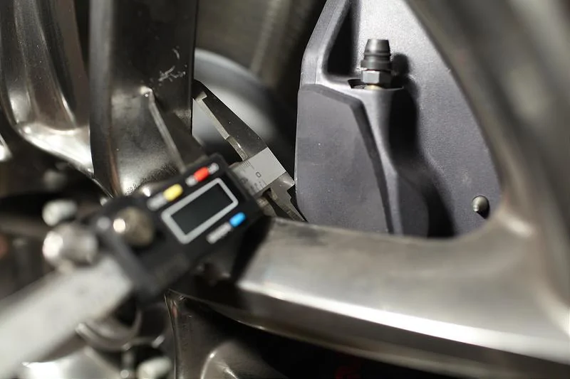

19x9 +36 Forgestar CF5V
Fits. 21mm clearance.

Off subject, but what size Direzza are you running on those B302 wheels?

275/35R19 - slightly pinched, but the stiff sidewalls of the ZII handled the 19x9 just fine (and i raced on them for a season and daily drove them afterwards without issue).
