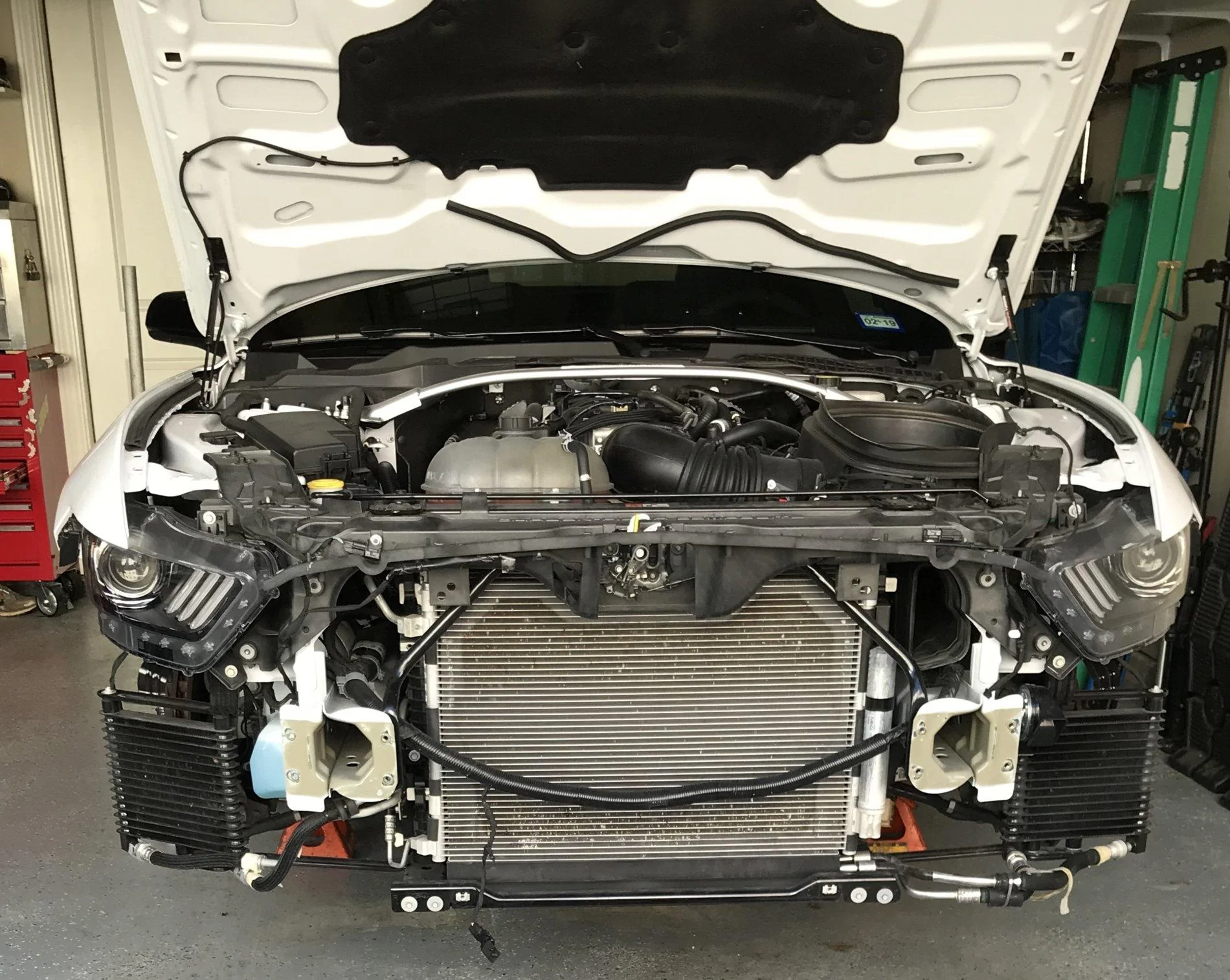

I have one installed in the front center of the car. I had to drill the crash bar which is Hardened Steel and I had to use Cobalt drill bits. Took about 2 hours to do the job.

I installed the Ford Performance front hook. Had to drill two holes in the cross bar. Don't worry about the front end being completely off. It all goes back together easily.

Thanks. Do you have any pics? I was looking to get the one which mentions no drilling required. It's oriented to the left side of the lower grille rather than the center.
I don't think there's a Ford Performance option for regular GTs. Yours is a GT350 I'm guessing.
