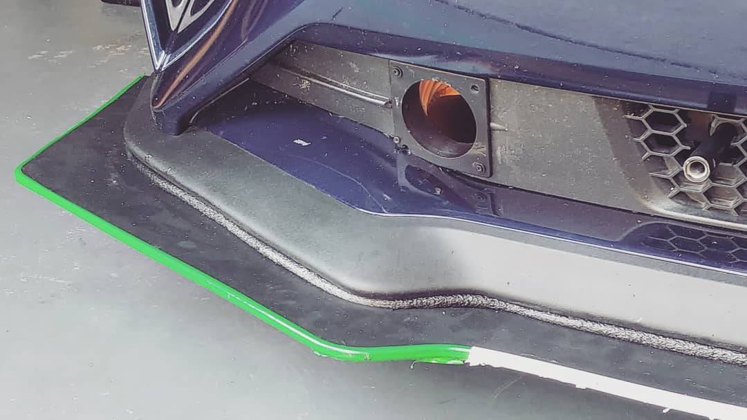

@Flyhalf Just curious what is that foam like substance between the lip and the ZL1 splitter? Im assuming it prevents any air getting in between?

Correct.
It also help to give a better angle of attack. After I put that i added the rods cause I see a better downforce. Paired witht he hood vents

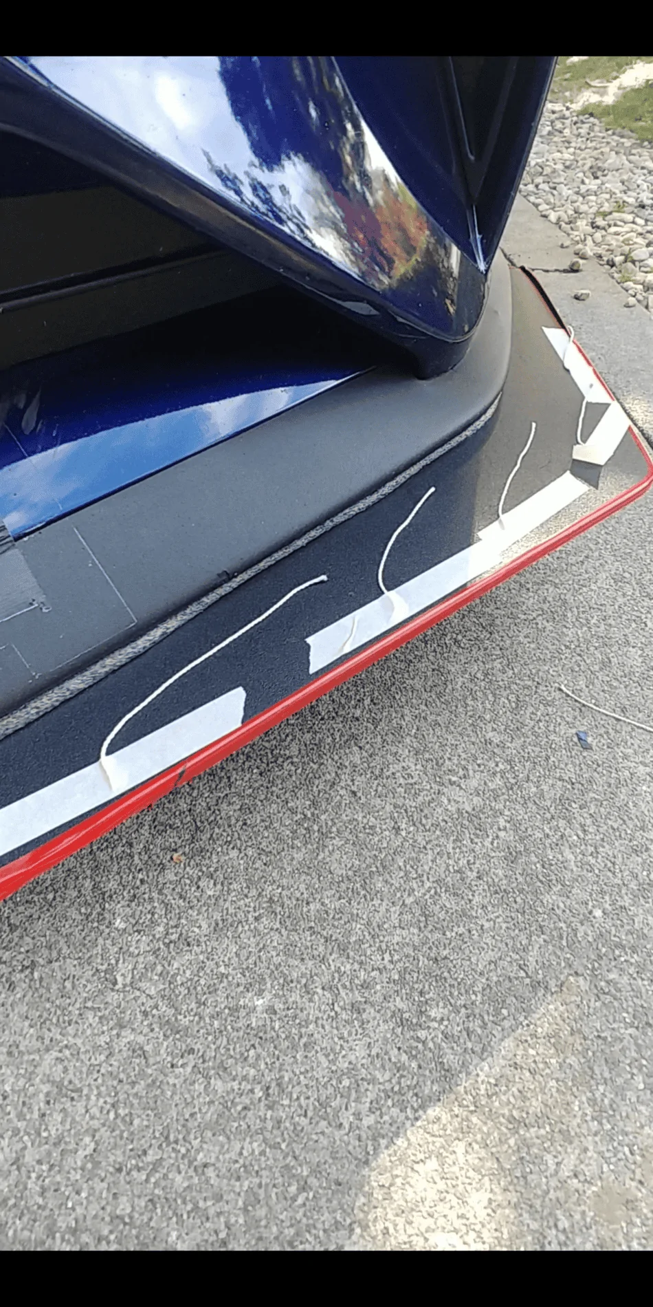

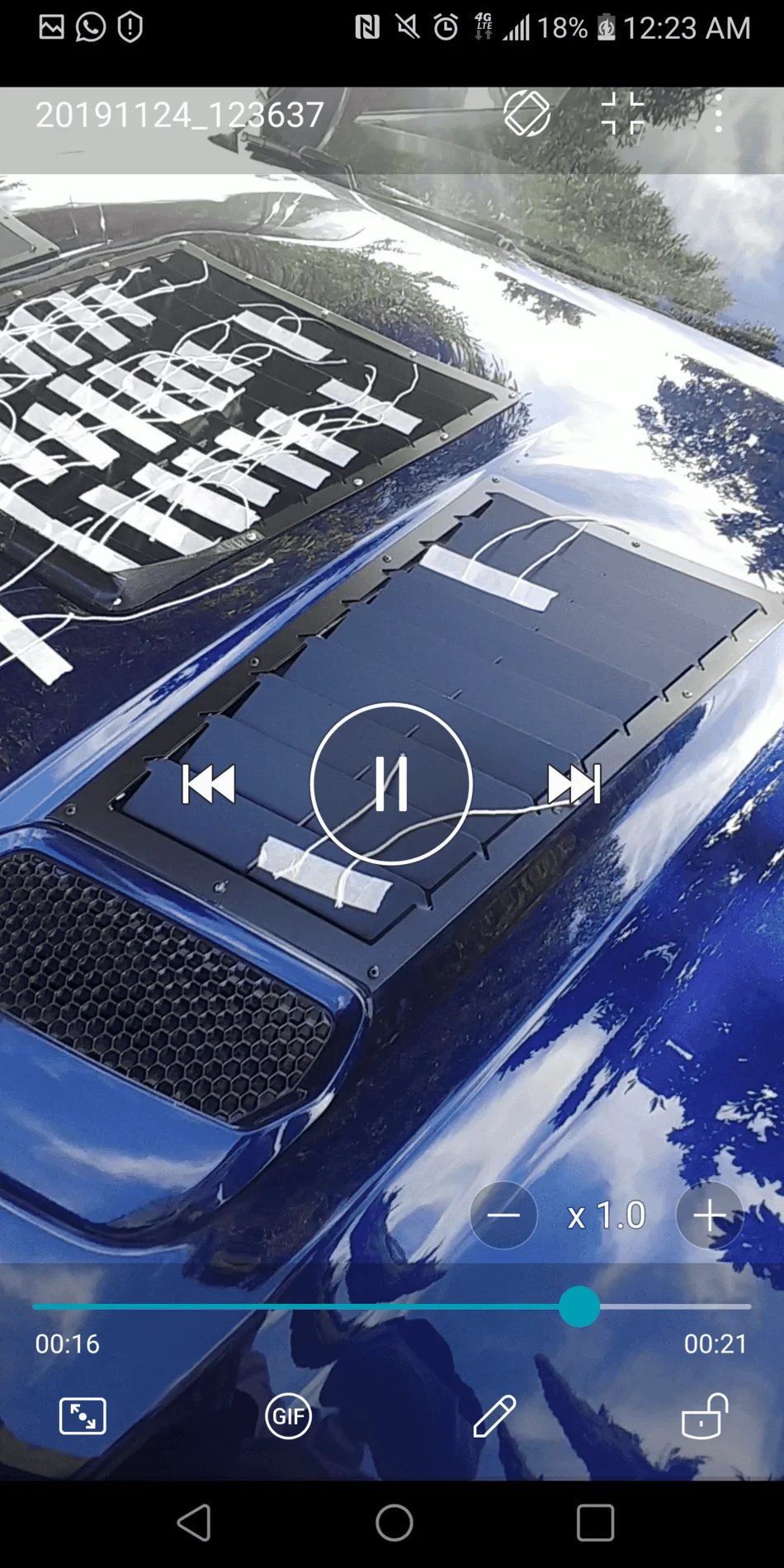

Today testing
Dynamic of the air flows :)
