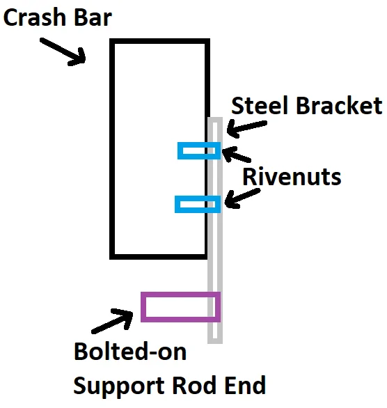

I plan to get some larger L brackets from Home Depot and Rivenut the brackets to the crash bar. Then bolt the support rods to the brackets. I'll be sure to make a write up here whenever I do pull the trigger on this.
This method still likely won't support 200+ lbs but it doesn't need to. If it withstands 100 lbs, I'd be happy. I doubt it would generate much more downforce than that anyway. The splitter itself protrudes more on the corners than it does on the very front of the car which from a CFD analysis, the generated downforce starts to drop off on the corners as the air speed picks up.

Here's an extremely quick-and-dirty diagram of how to mount to the crash bar. This would be a cross section view
You might be able to mount the support rod ends directly to the crash bar as well, now that I think about it...
