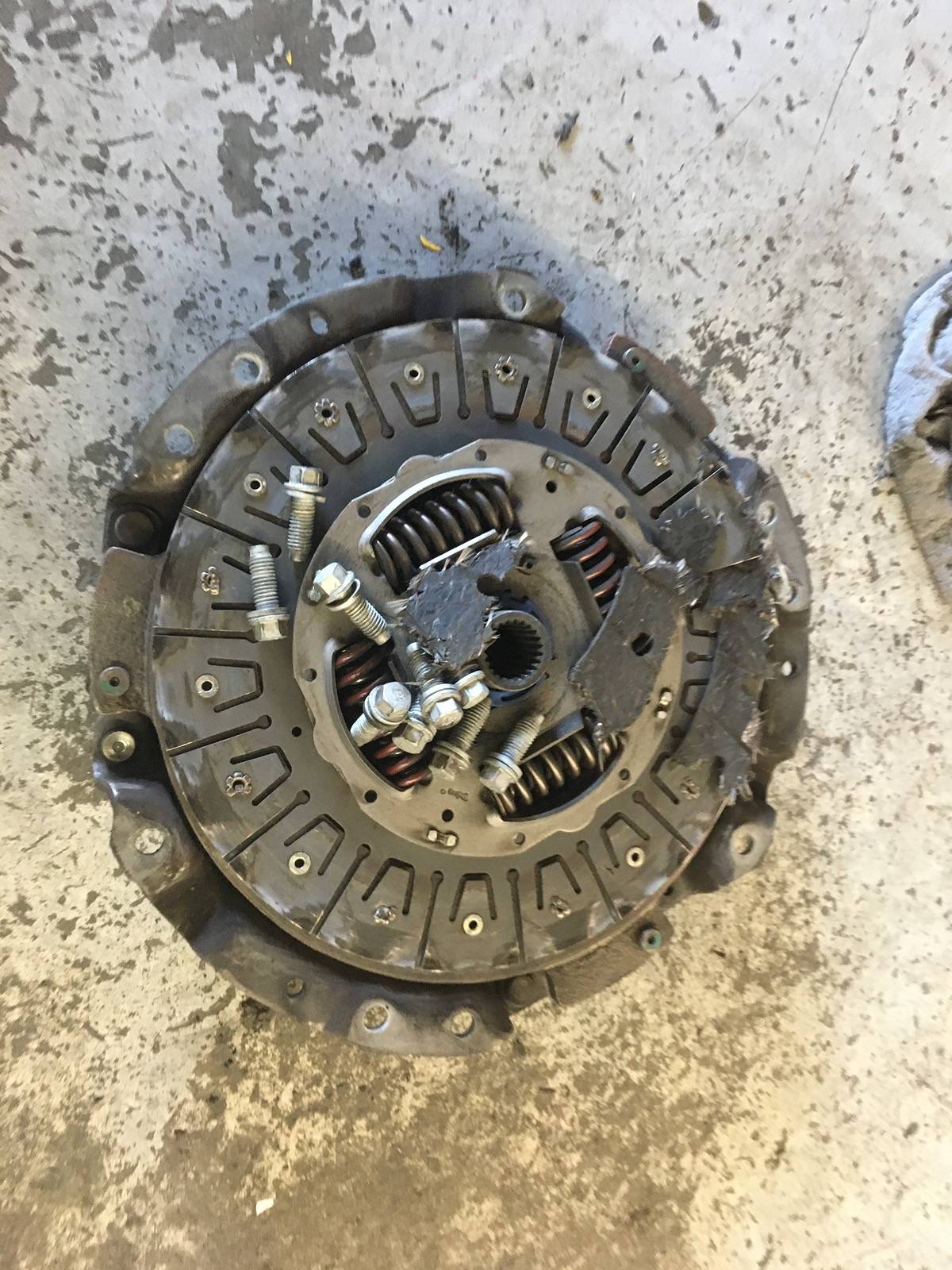

Blew 2 factory clutch in my 17 track car
They can’t handle high rpm’s shifting and explode
So aftermarket is good
OH! Wow, good to know, thanks!
