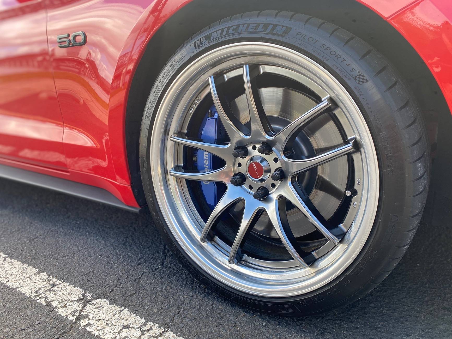

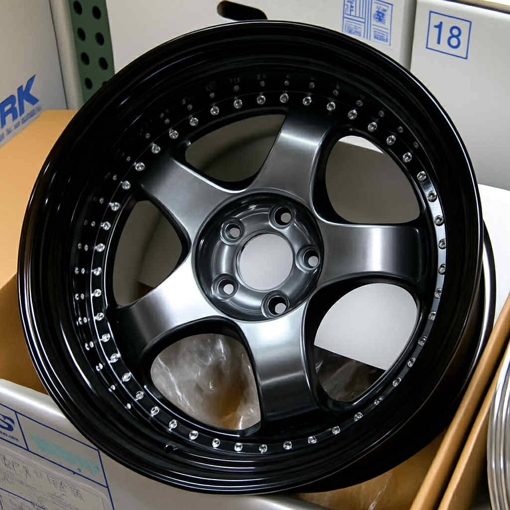

I have loved the wheels but I did go with the CR2P in the end. Years later i find myself now wanting to go proper 3 piece meisters. I would like to do 19’s but I have no idea still if they would clear the brakes. I’d probably have to take measurements and send them to my wheel shop for order. Otherwise I would just order similar specs S above but more aggressive front offset, likely a +33 or so.

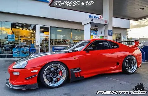

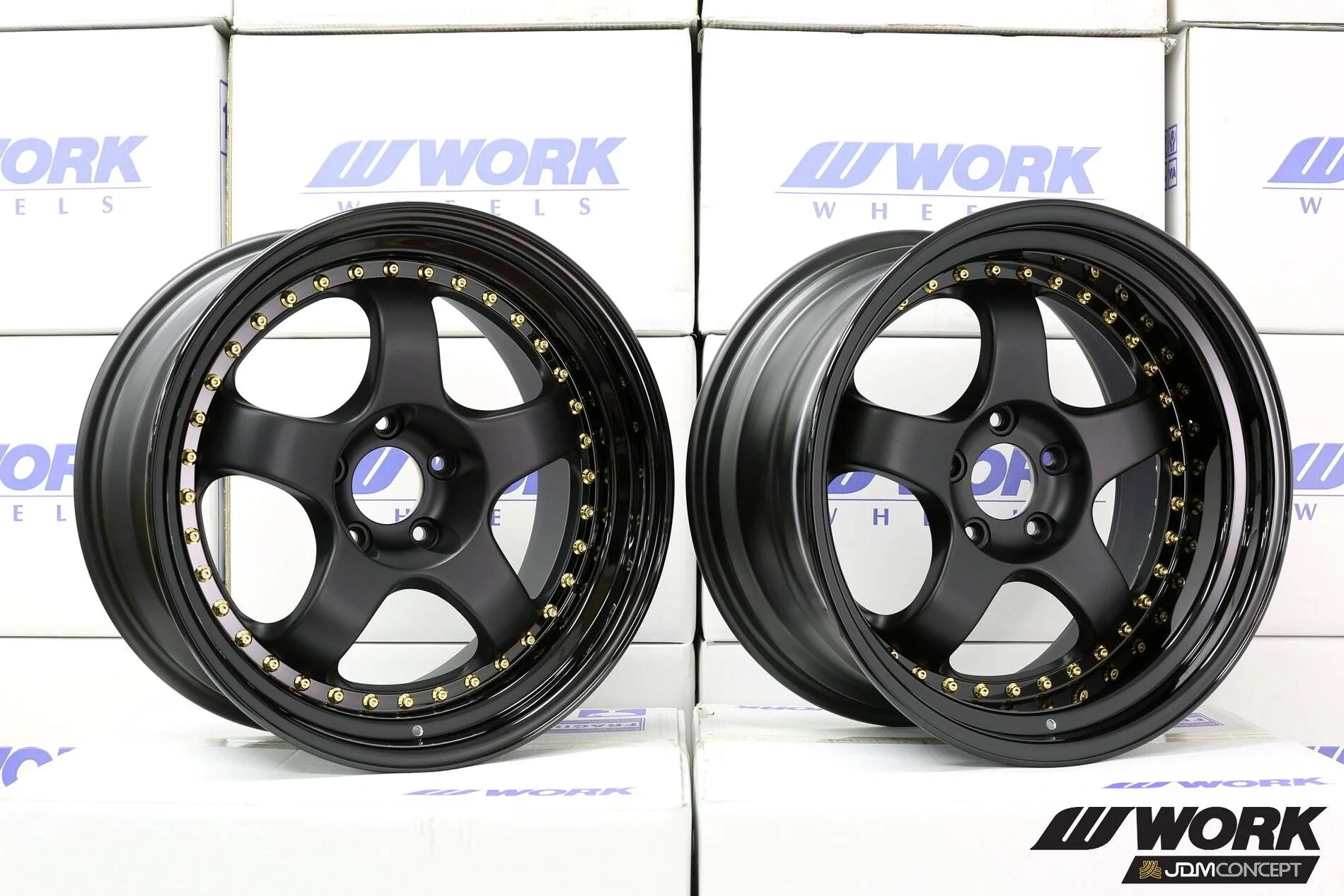

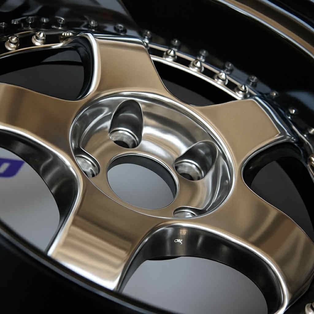

If I order a different set I’d want something different. I like striking cars inspired by JDM car styling. I’ll post some examples, wish I had photoshop to mock up so I could see what would look good in my car:
thoughts?

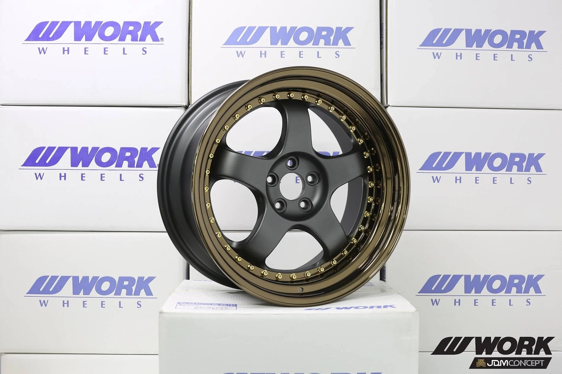

Snipped a few pics out to opine that the two tone black and bronze-ish (or is that black chrome?) would look killer on your ride. The black ones are way cool, don't get me wrong, but there's something about the two tone - and on a red car it'd be striking for sure.

Black/bronze lip meisters would be awesome on your red s550....

It is the gloss bronze in that first pic!
It will be phase 2 of the car! Started off red and silver/polished….a bit old school….
then meisters + cowl hood and a max effort NA motor.
The black and bronze is easily the most unique. Gold riv nuts!
