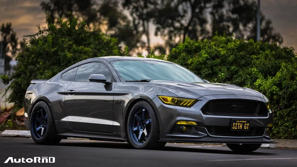

Then there are 20x10 te37 Ultras that will also work
These are 18x10 TE37RT on my old car
http://www.mustang6g.com/forums/showpost.php?p=1650352&postcount=129
These are 20x10 front and 20x12 rear on my old car as well(20x12 is disconinued but a few new sets still exist.)
http://www.mustang6g.com/forums/showpost.php?p=1650351&postcount=128
And to note.
18s and 19s need to have the lug holes drilled out to fit over the oem studs or switch to arp 1/2 studs
20s require no modification
