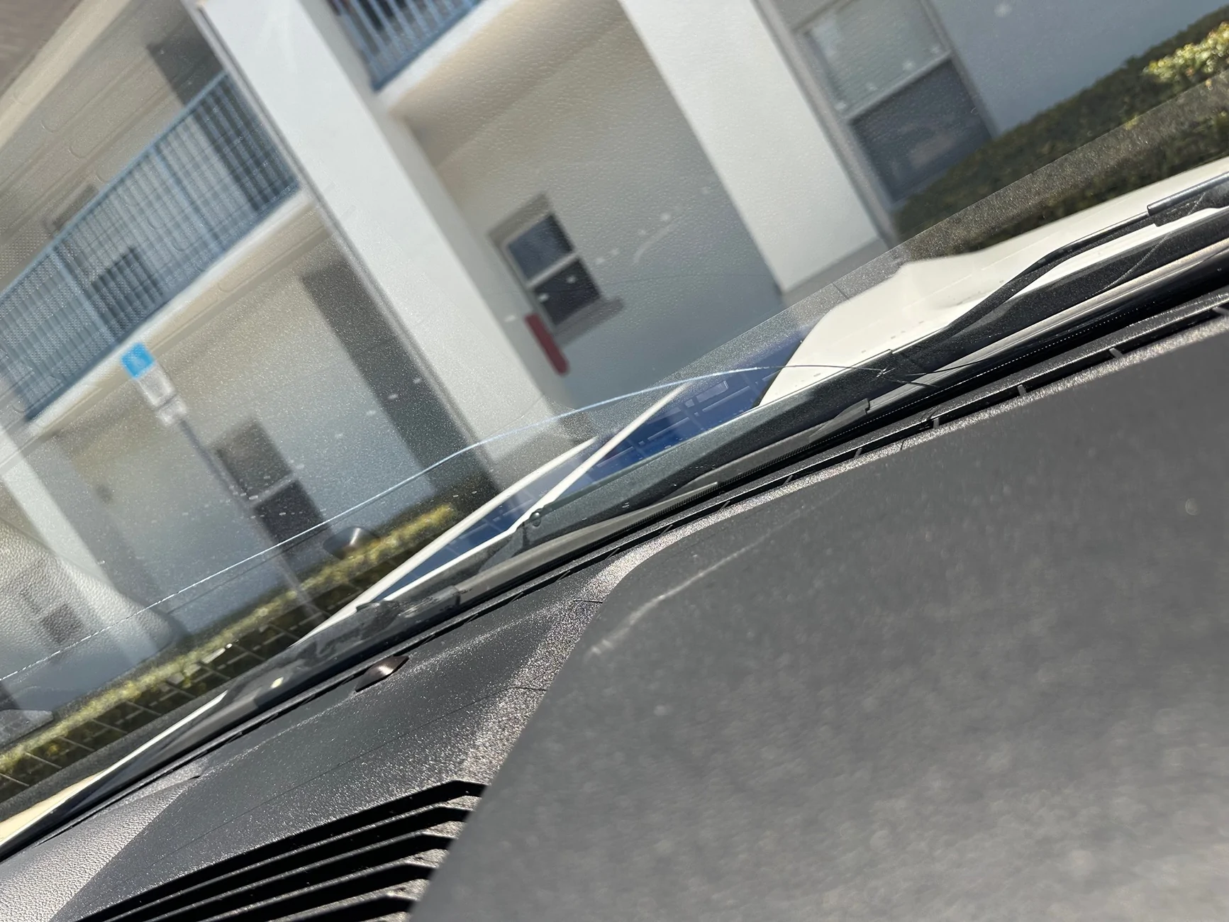

For the past few months, when I would get into the car and first start moving, I would hear a loud crack from the dashboard area. Sounded like plastic flexing and shifting. I figured it was the heat and the chassis flexing a bit when I first get in causing the dashboard to shift. It happened almost daily.
Then today it happened, and I watched my windshield crack along with it. Only thing I can think is that it was the window cracking the entire time.
I want to say it’s the heat, it’s a Florida car. But NEVER have I had this happen and I have had dozens of cars.
Maybe it was a small rock chip I couldn’t see?
I’m baffled. This is a new one to me. It is a GT350, but I assume it’s the same windshield across all models.

I see an impact mark in the photo, down near the base of the windshield.
I looked at that but when I rubbed my finger on it; there is no impact on the outside. And I have never seen a rock impact crack a window in parking lot months later.
It made the cracking sound again today and the crack lengthened. I watched it happen. It’s bizarre. Climbing into the car is somehow causing pressure change in the window.
I may never know wtf happened. Luckily one window a year is free here. Just gonna get it replaced and hope it doesn’t happen again.
