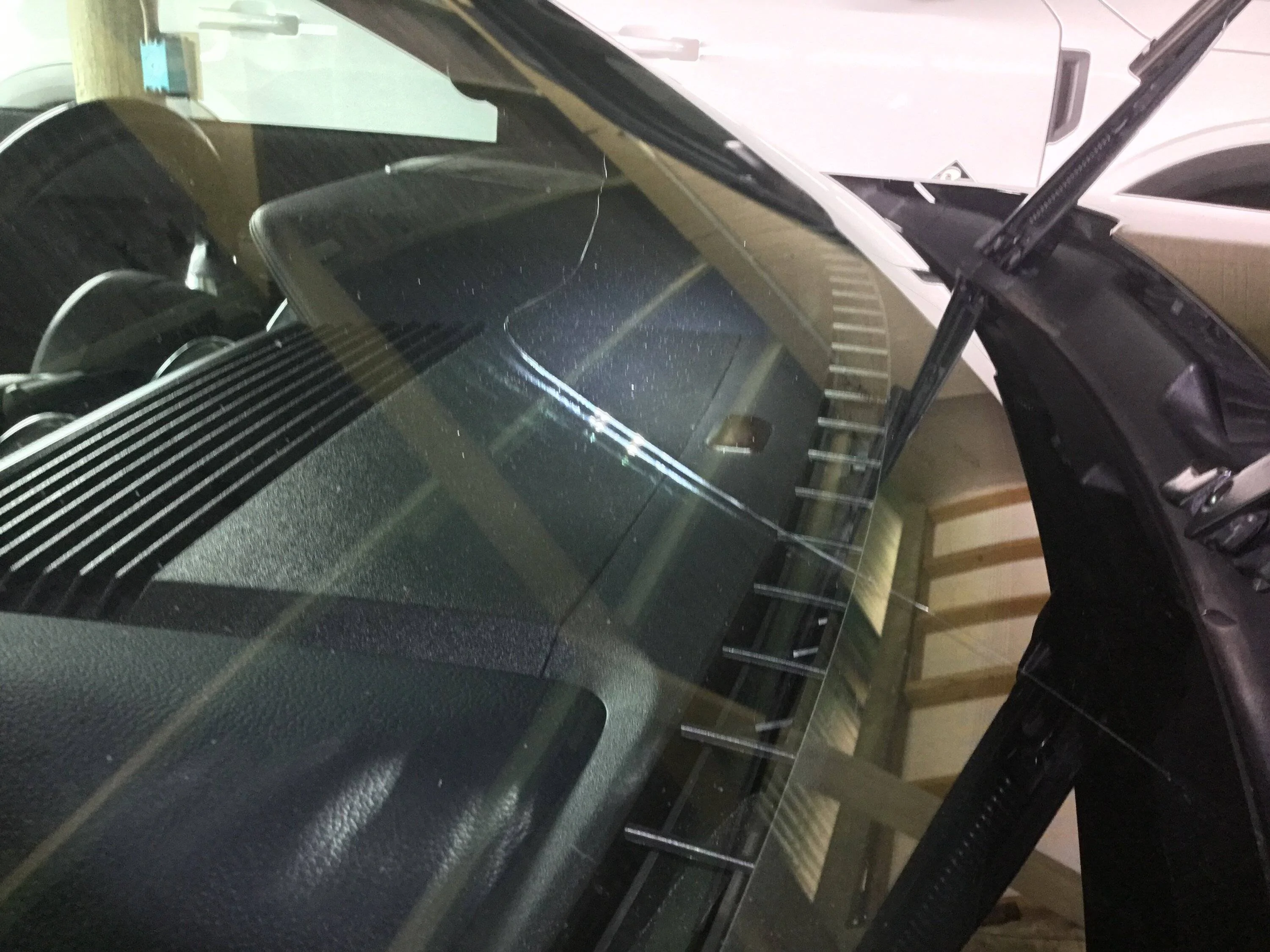

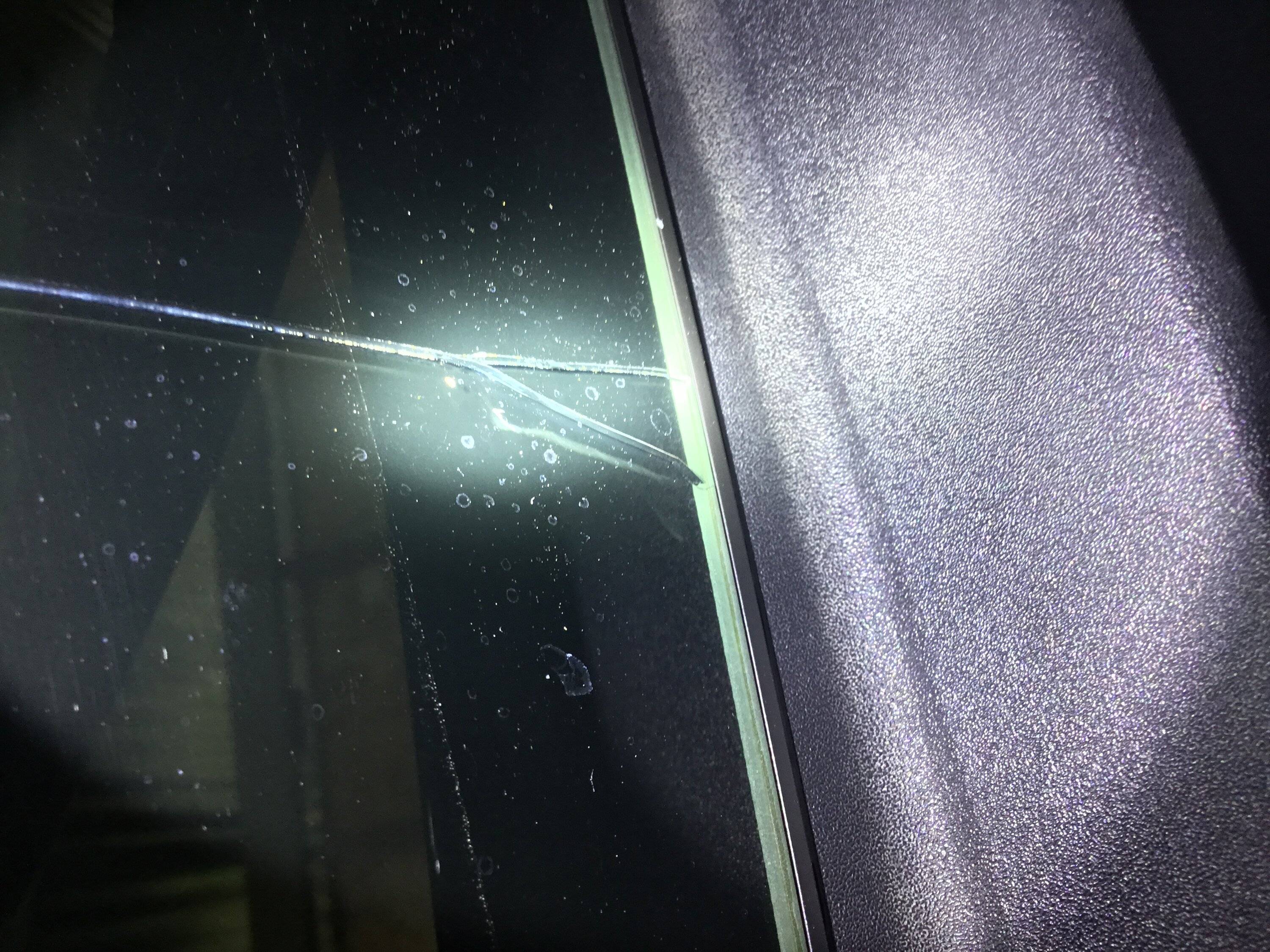

Thanks for the comments guys !
This happened Friday and when I posted this morning I was to lazy to go out and take a picture. I raised the hood and could see some more detail. There’s an upside down V at the base of the window then continues up in a single crack. The V is behind the hood and I can’t see a chip, but I don’t know. Here’s a couple of pictures, I think it grew overnight !
