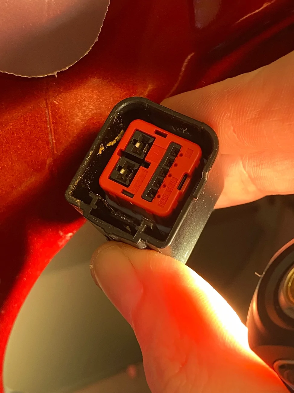

Not to doubt and whatnot, but how well did you clean it and pack it with dielectric?
I had to do it just about every other year until I filled that plug to the brim. I’ve never had to replace a motor on mine as the clean and pack with dielectric fixed it every time. Albeit, it did come back. But after that last pack it’s been a year or two.

Oh I hit it with a wd-40 electric cleaning spray, pipe cleaners and then sealed it pretty thoroughly with Dielectric grease. I am sure I could get it cleaner. But honestly, snipping 4 wires and connecting them is much easier.

I know WD-40 is a water displacer, but I’d give it a go with actual connector cleaner. With the WD-40 it probably didn’t get dry enough.

This what I used. It was their electrical cleaner. It dried damn near like break cleaner.

There's a product called Deoxit which is used in electronics as it removes oxidation and enhances the electrical connection. It works well with switches and such on transceivers, radios, etc. and could help clean it up well. As far as dielectric grease goes, it's purpose is to prevent electrical flow (like spark jumping from the coil across the spark plug insulator to ground causing a misfire) so not sure if it's the right product to use on electrical contacts. But, I'm sure it does a great job keeping contamination and moisture out if the connector is packed full with it.

I used the dielectric grease as the later of your statement. I only put it on the rubber seal of the connector. Not directly on the contacts.

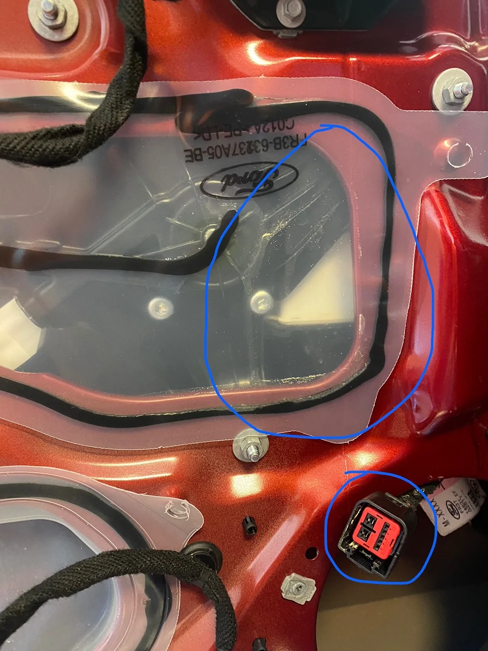

Yep. The connector is filled with it. The connector is at an upwards facing angle so water just collects inside.
Haven’t had a single issue since.

I did the same thing OP did first, which still let enough water and moisture in once the dielectric grease got hot and thin enough to no longer prevent water ingress.
You can see how it sits, and where the water and dirt was coming in before I did this the first time. Just putting a thin film around the connector gasket just isn’t enough.

So my first recommendation would be is if while driving and hitting road imperfections is causing the “glitch” as I’ll call it, then there is either a connector, wiring harness or even pins in a connector that are loose and not totally secured.
My reasoning is because if it’s doing it at a bump or jostle while driving, whatever is loose is causing the glitch to activate. If the connector was correctly sealed and pushed together firmly, the water intrusion should be rectified as well as the glitch. I would also try to mount the offending connector sideways or even upside down so water intrusion isn’t able to penetrate it as easily as how Ford positioned it.
Another trick would be to get a small balloon cut the closed end and slip it over the connector and zip tie each end - totally water proofed now…
Cutting the connector or plug head off at each end of the harness and hard wiring the wires together will work 100% as long as you wire the correct wires together exactly how they mated within the plug. The only reason the plug is there is to allow separation of the harness for servicing or replacement of the harness (if necessary)… it’s also designed as such for assembly line efficiencies when building the car and attaching body harnesses/wiring looms for XYZ body panels or modules.
