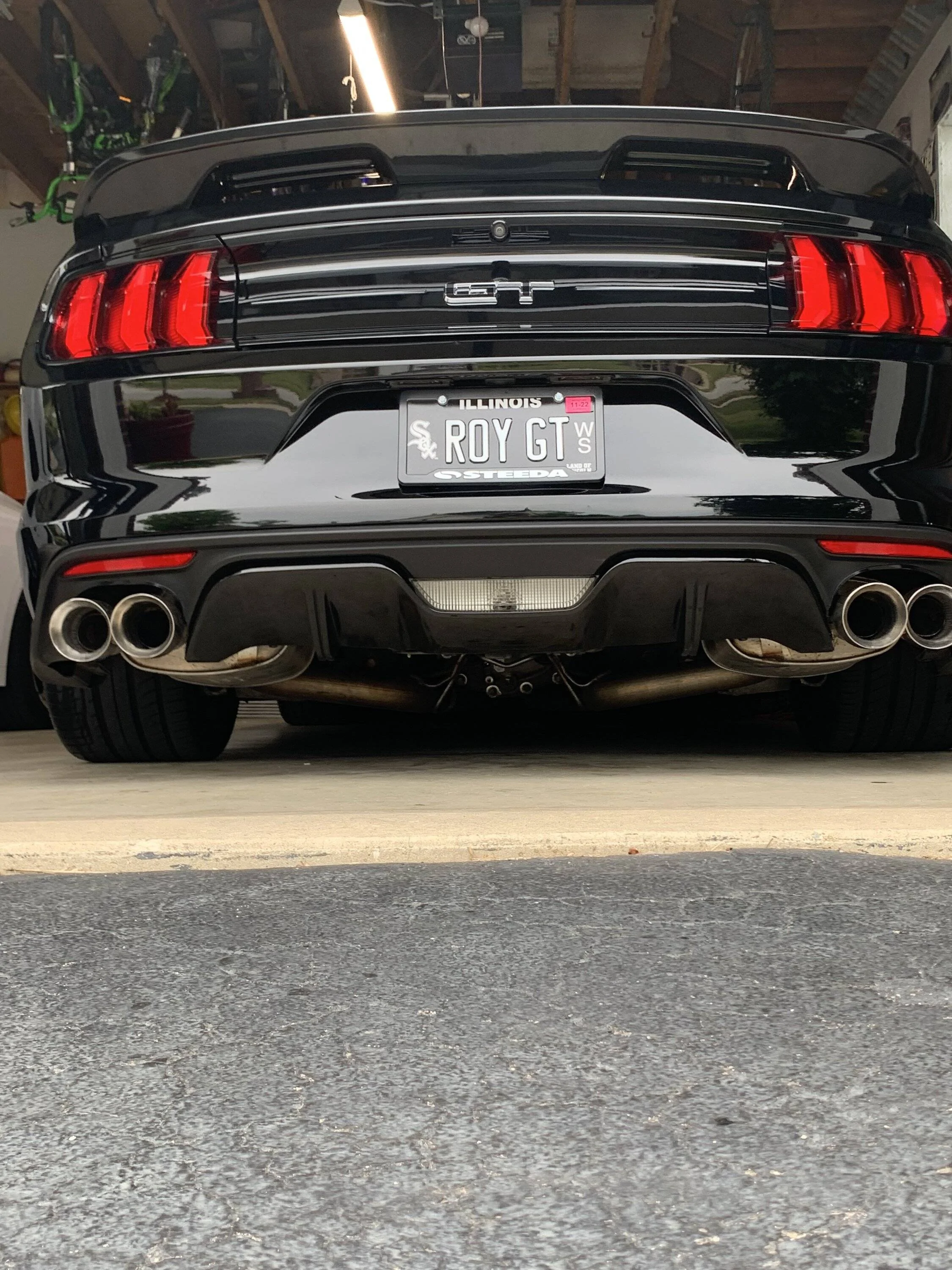

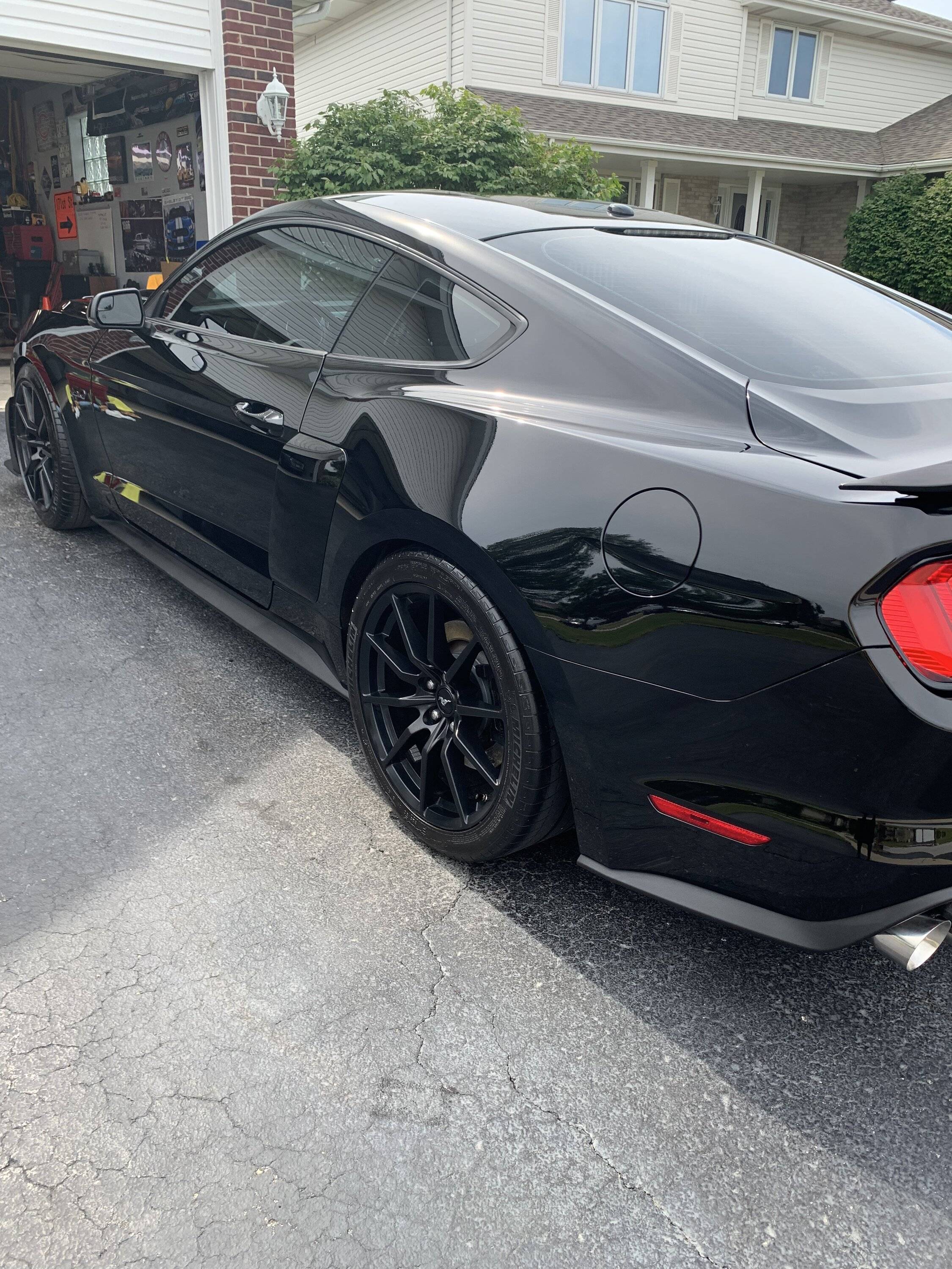

No rub here
Roy 3Fidy
May 17, 2021
309
762
Midwest
Roy
2017 Shelby GT350, 2020 Lincoln Aviator Black Label Edition
What wheels and tire combo are you running? What’s the specs on the car?
OEM Mustang GT350 wheels
Tire specs:
Front:
Backspace: 6.88""
Offset: +35mm
Weight: 24.4lbs
285/35/19
Rear:
Backspace: 7.97""
Offset: +50mm
Weight: 24.5lbs
325/30/19 rear

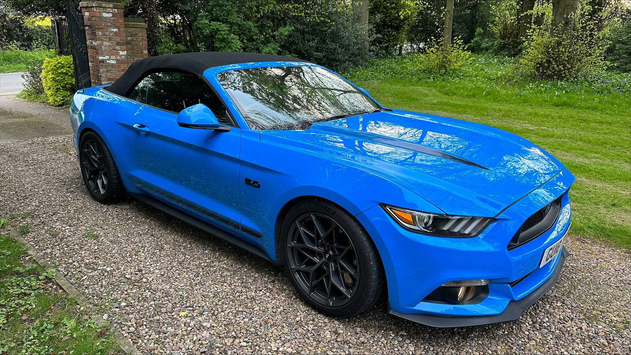

chillo
Mar 14, 2022
42
55
East Yorkshire, England
Simon
Mustang GT, BMW 840d, Ferrari F430 spider, Ducati Panigale v4r
I have the exact same setup, only steeda progressives, so the car is 1" lower. The only reason why I may have to rethink it is due to the big brake upgrade I'm about to start. Works fine if you're still running stock GT brakes, or the performance pack or bullitt setup.
285/35-R19 (35mm offset) in front; 325/30-R19 (50mm offset) in rear:
Exactly what I hope my convertible will look like when I get my 285-325 wheel and tyre setup installed this week :)

How much lowered is the car? And what’s the camber on wheels? your setup looks great.
chillo
Mar 14, 2022
42
55
Simon
285/35/19 front
325/30/19 rear
Steeda progression rate springs, 10 mm rear ride height spacer.
No rubbing.
Grip balance of the car is very even and very predictable.
