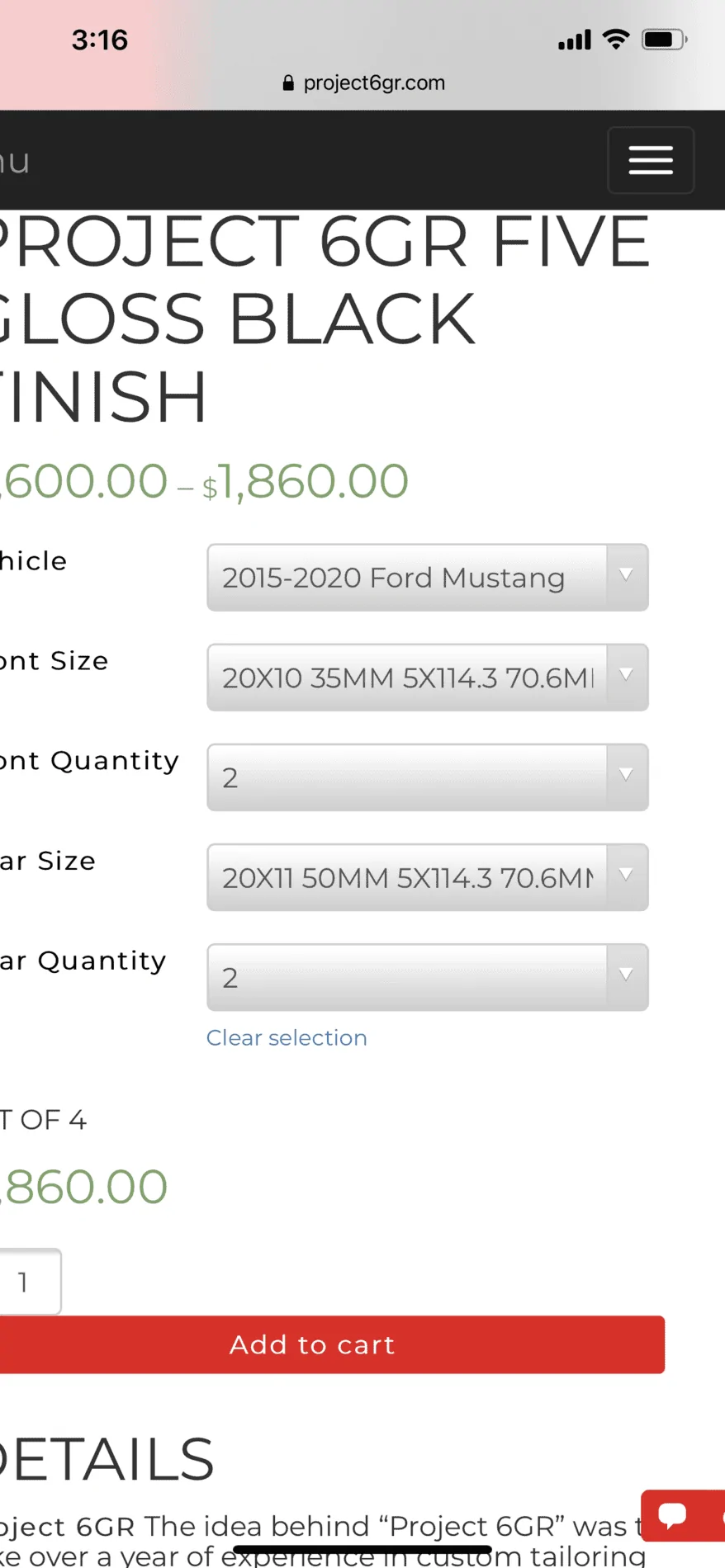

I love you so much for posting right now. My Offset will be 30 in the front and 50 in the rear. I shouldn’t have issues right ?

If your front is 30 with 285 you will rub. As for the rear you should be good with . 50. I’m on Ford Performance springs drops it 1 inch... not sure if the eibach pro kit drops it slightly more
Et for the front will be around 34 or 35 if I’m not mistaken. With 34 front 285 I don’t rub

I’m an idiot. The front is 35mm offset. I won’t rub then with 35mm in the front with a 285 tire, right?
