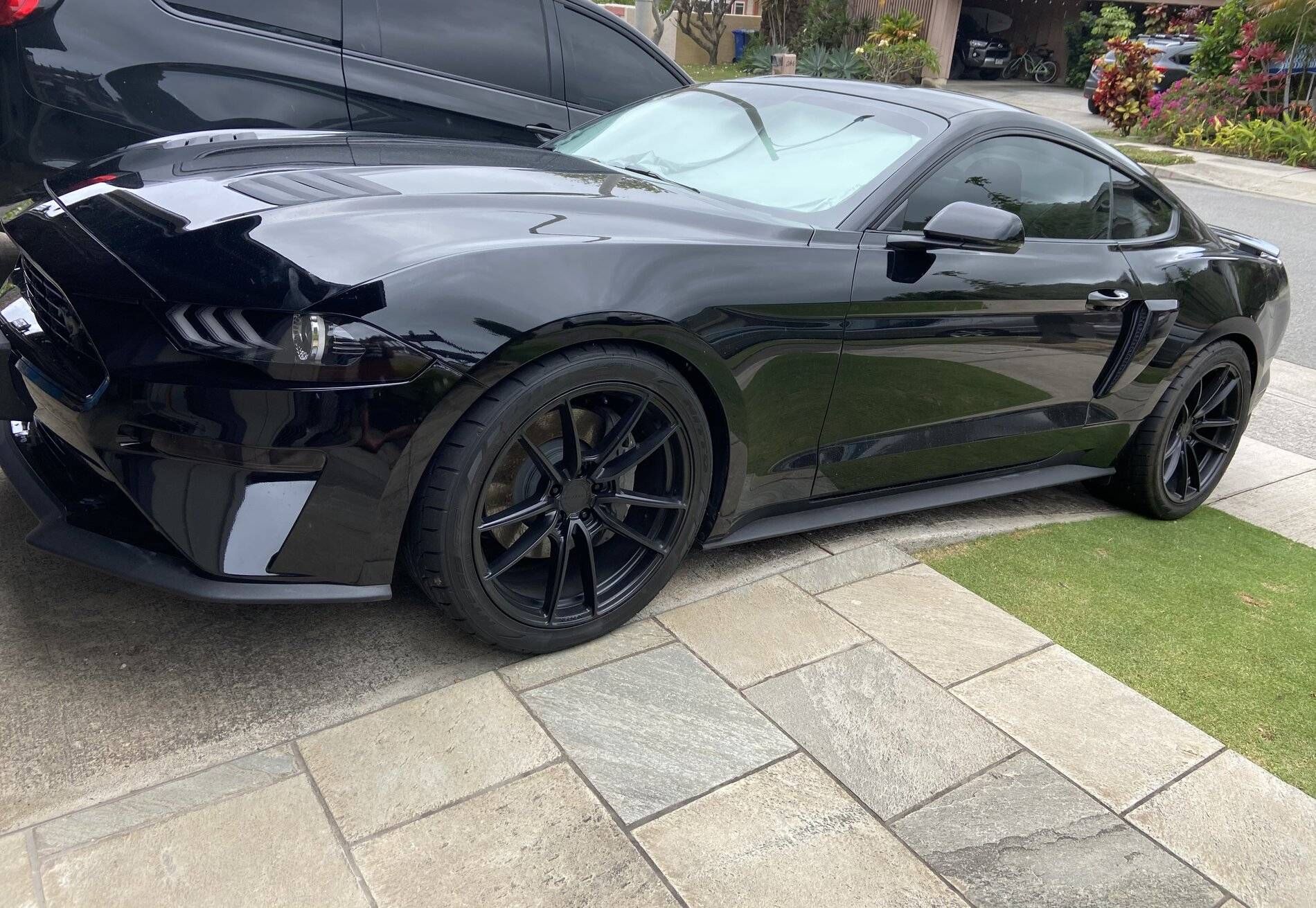

Hello I was wondering if I would rub with a 1.5 inch drop in the front?
Front 19x10 285/35/19 +35mm offset
Rear 19x11 305/35/19 +50 mm offset
Clearance should be the same as the OP. Your 285/35r19 is a full inch shorter than his 285/35r20. This would give you 1/2 inch more room with the same springs. However, you're lowered 1/2 inch more, which gets you back to even.

Oh okay thank you I was worried I would rub and had to go with lower one but I think it should be fine then.
