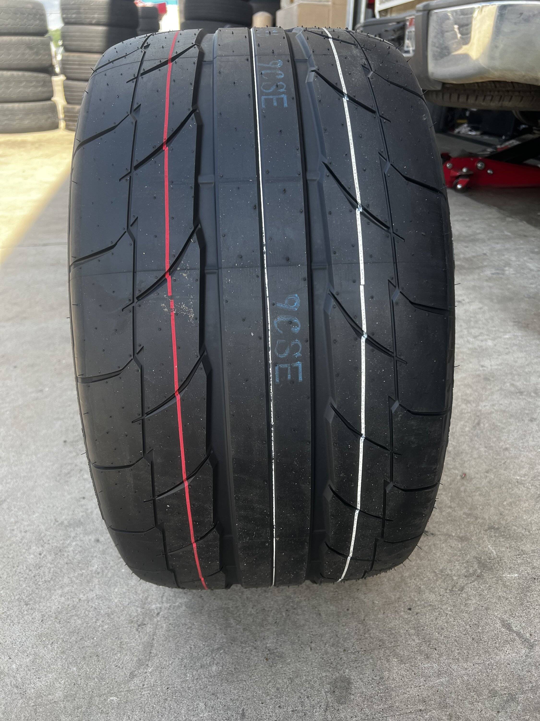

Yes and those are 305’s on 50mm offset. Mostly due to my camber set at 0. The nice thing, they never rub. :) I need the traction.

Not my experience. I have close to 900 wheel and they hook just fine. They are new however. My old MT Street SS tires did fine until they got a bit older.
I do run my tires at 17psi cold and 0 camber so that helps.

O, you know what, we are talking about two different tires I believe. I just got the 555R2’s a week ago. Different tire. 😃 not saying they won’t spin but if I warm them up and grab 2nd quickly (stick car), pretty smooth sailing. Again, only have 100 miles on them.
As a side, I did like my MT’s too other than the softer side wall at speed as the car moved around some but I got used to it. They are good tires.

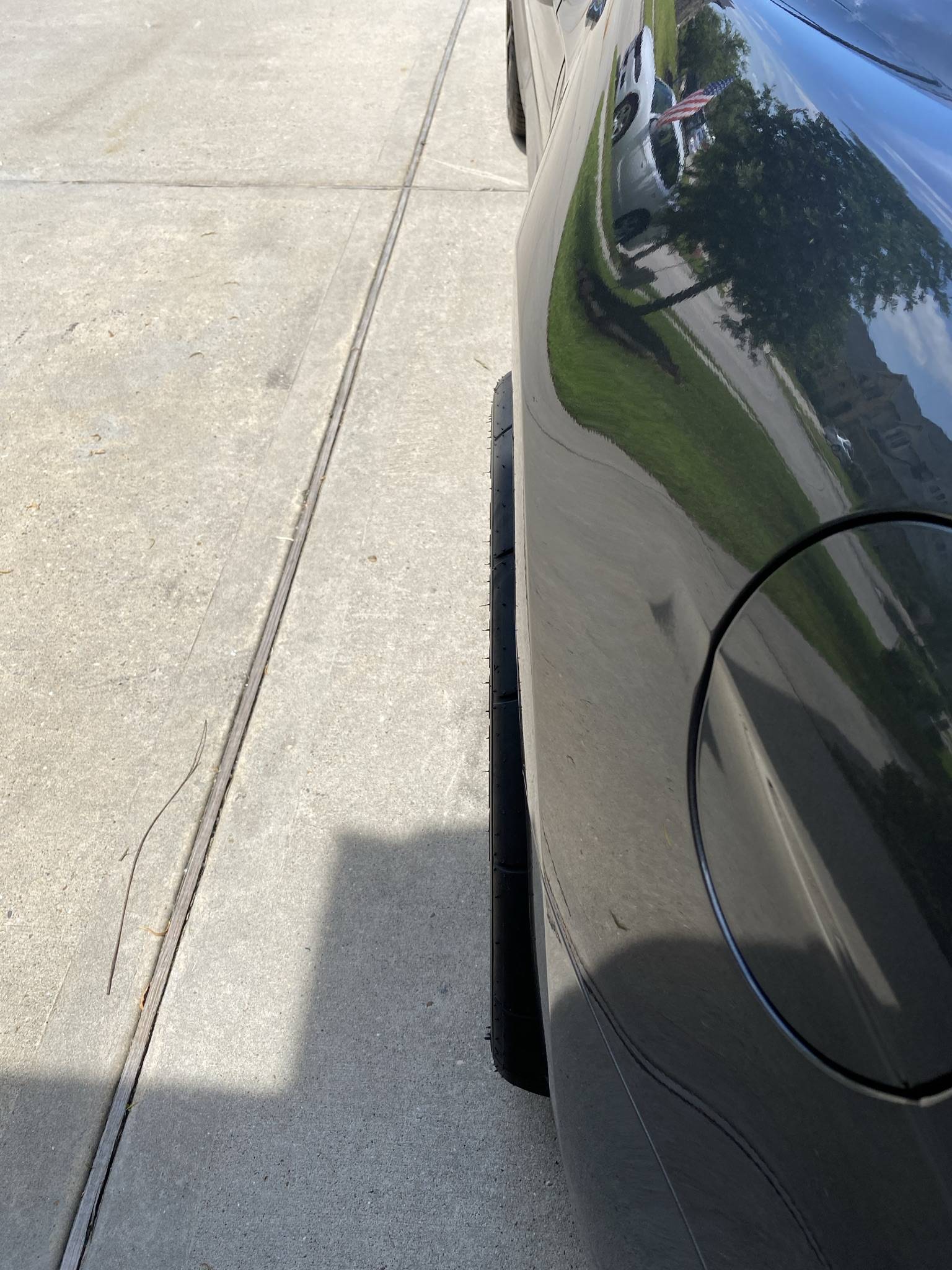

I have 325's on a 52 offset. No poke. No rub.
