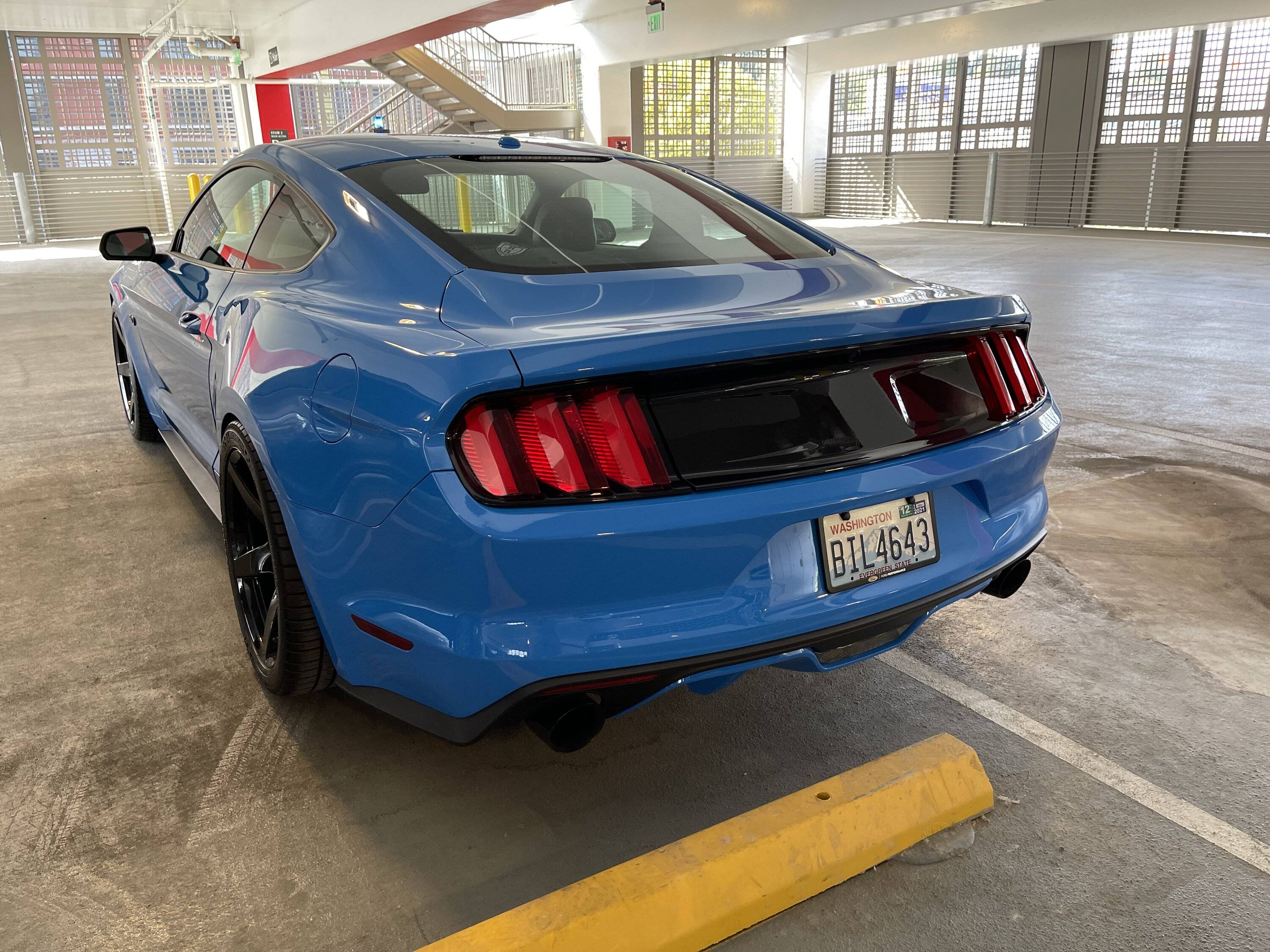

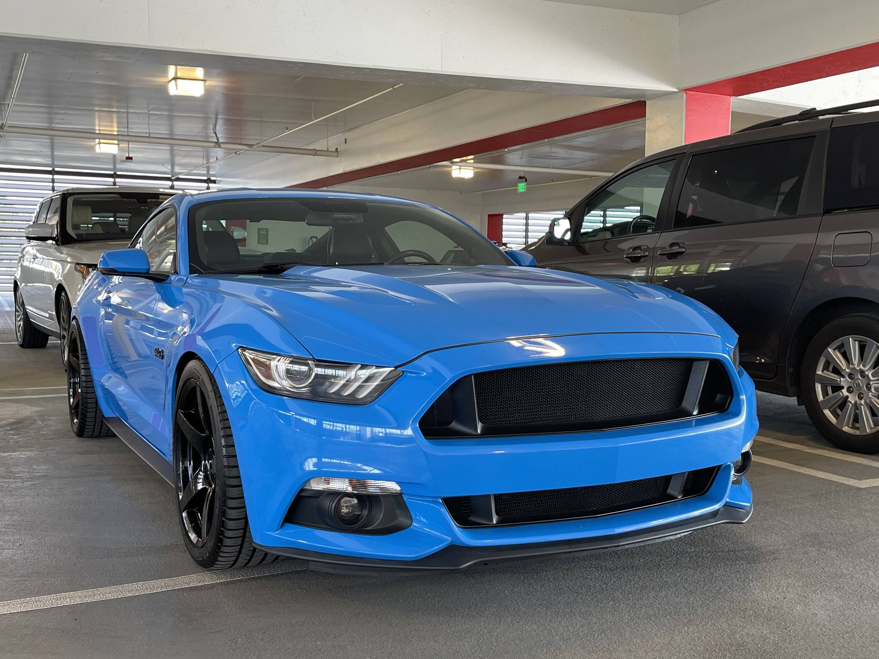

I have the exact same setup, only steeda progressives, so the car is 1" lower. The only reason why I may have to rethink it is due to the big brake upgrade I'm about to start. Works fine if you're still running stock GT brakes, or the performance pack or bullitt setup.
285/35-R19 (35mm offset) in front; 325/30-R19 (50mm offset) in rear:
Looks good!
