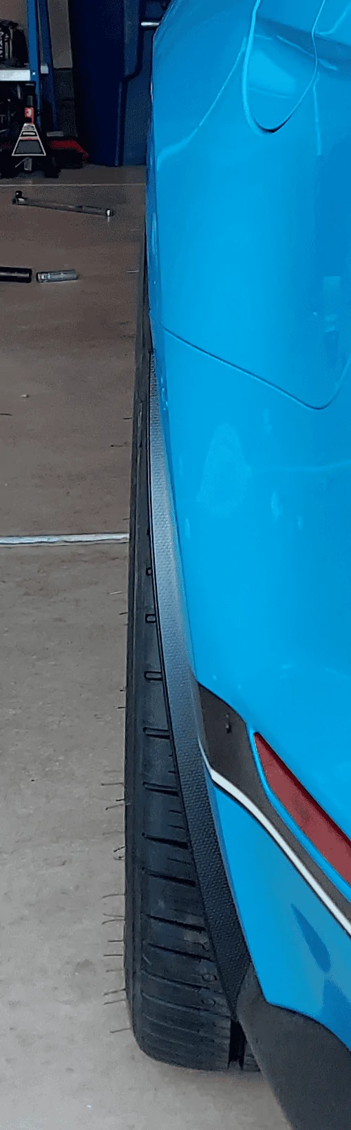

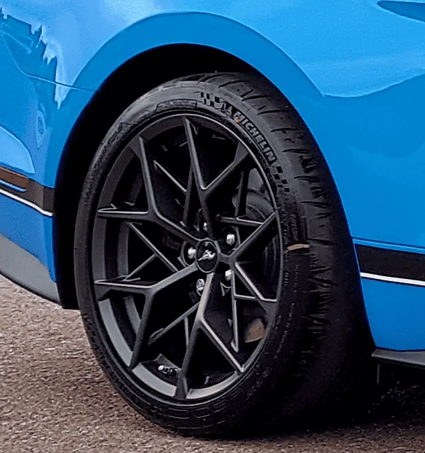

FWIW, I've attached two pics.
The rims are factory, 19x11, +52.
The tires are Michelin, Cup2s, 315/30/19.
Many, many threads exist here for virtually any rim/tire combo you're interested in.

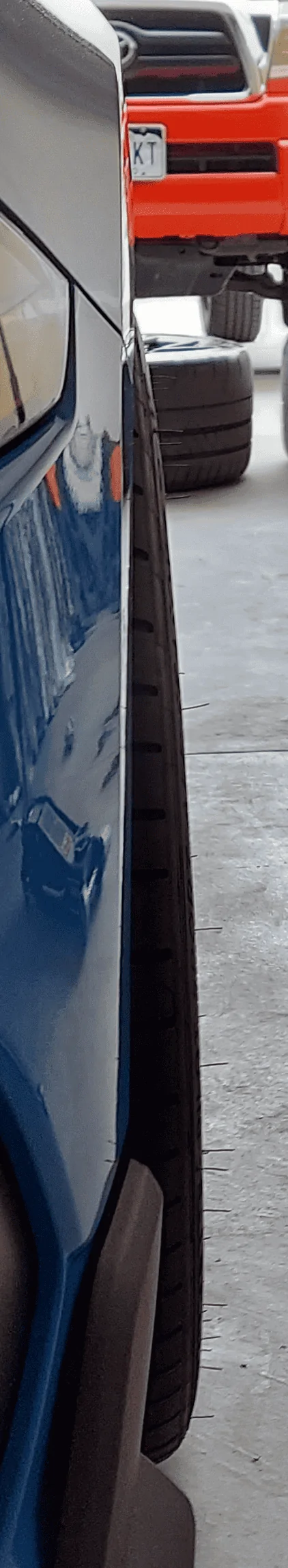

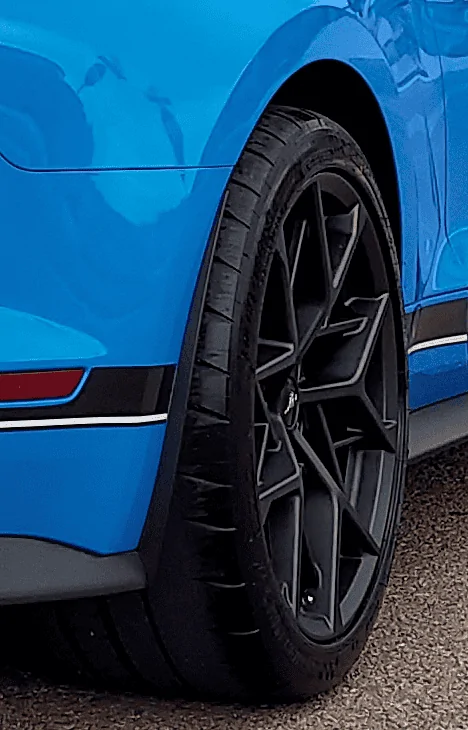

Two more.
Rim, 19x10, +35, square.
Tire, Michelin, 285.

I messed up the quote, @Skye who's car is in the image I quoted above? I've been nervous that 19x10 35mm wheels with 285 tires would poke. Doesn't look like it from the images you posted.

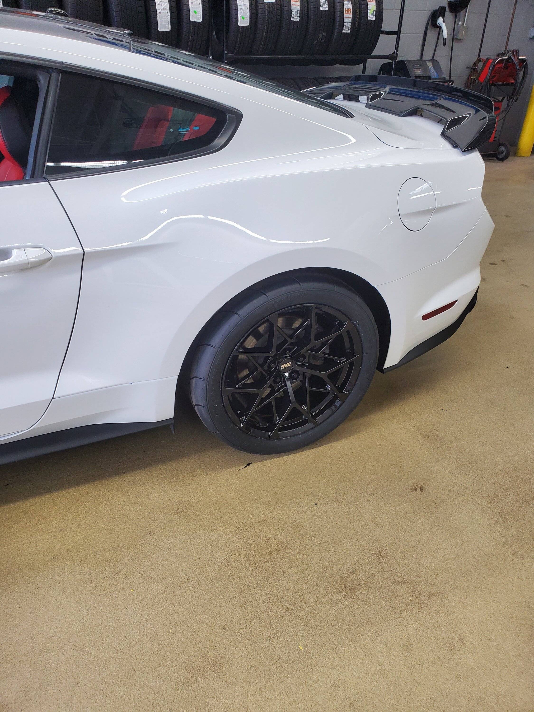

I have 305 MIckey Thompson Street S/S on the rear and I think they fit perfectly. Offset is 50mm in the rear.
I believe that’s his beautiful Mach 1
Man those fender vents are gorgeous I wish Roush sells those seperately.
That's Skye, Thanks.
I haven't encountered any negative impacts with a 19x10, +35, 285/35/19 in the front or rear, stock suspension and setup. No poke. No rub. Nothing weird. In the front, I have about a thumbs width of clearance to the suspension. In the rear, quite a bit from rim to suspension.
I can appreciate the time it takes to think things out. You have immediate needs, but later, you might want to lower or mod the suspension; some here have done excellent work in these areas.
Best thing is, there are plenty of examples and insight.
