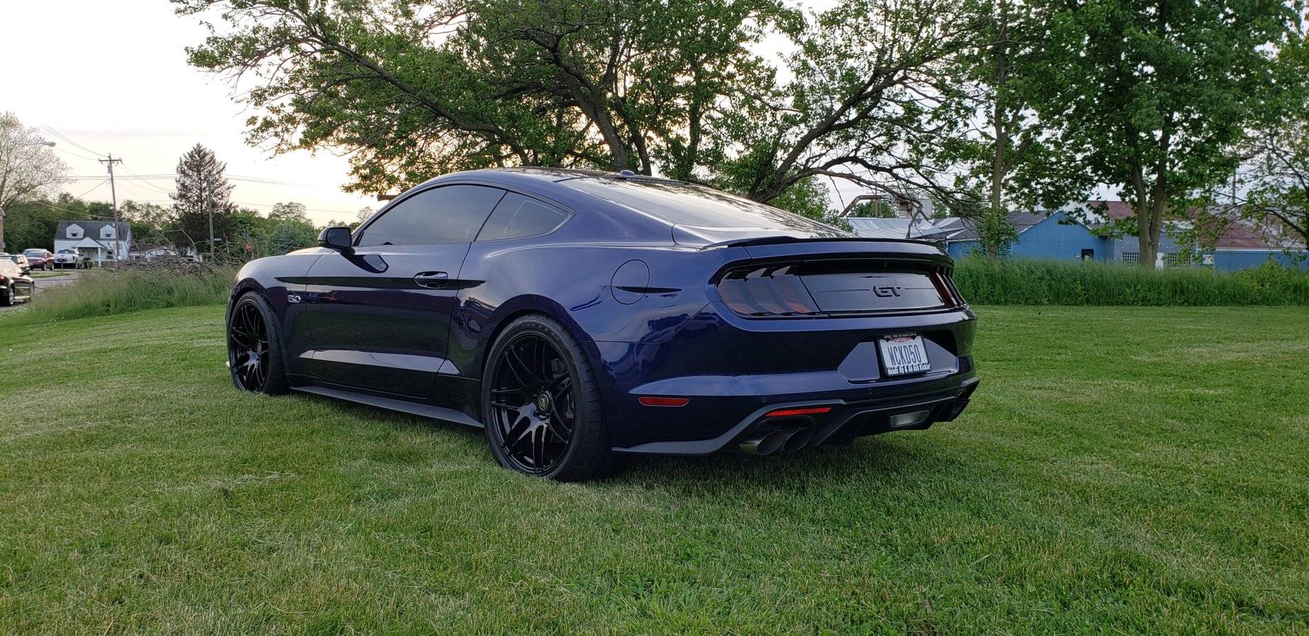

looking to get some new wheels and i have a pair of brand new 315/35/20 nitto g2s. Can anybody tell me if they will fit w either of these wheel specs? Car is lowered on BMR perfromance springs.
  • 20" diameter
  • 10.5" width
  • 57mm offset
  • 8.00" back space
  • 20" diameter
  • 10" width
  • 50mm offset
  • 7.50" back space

I know it should be an 11 wide, but im trying not buy new tires since these are like new. I have matching 265/35/20. I ran these tires on my forgestar f14s

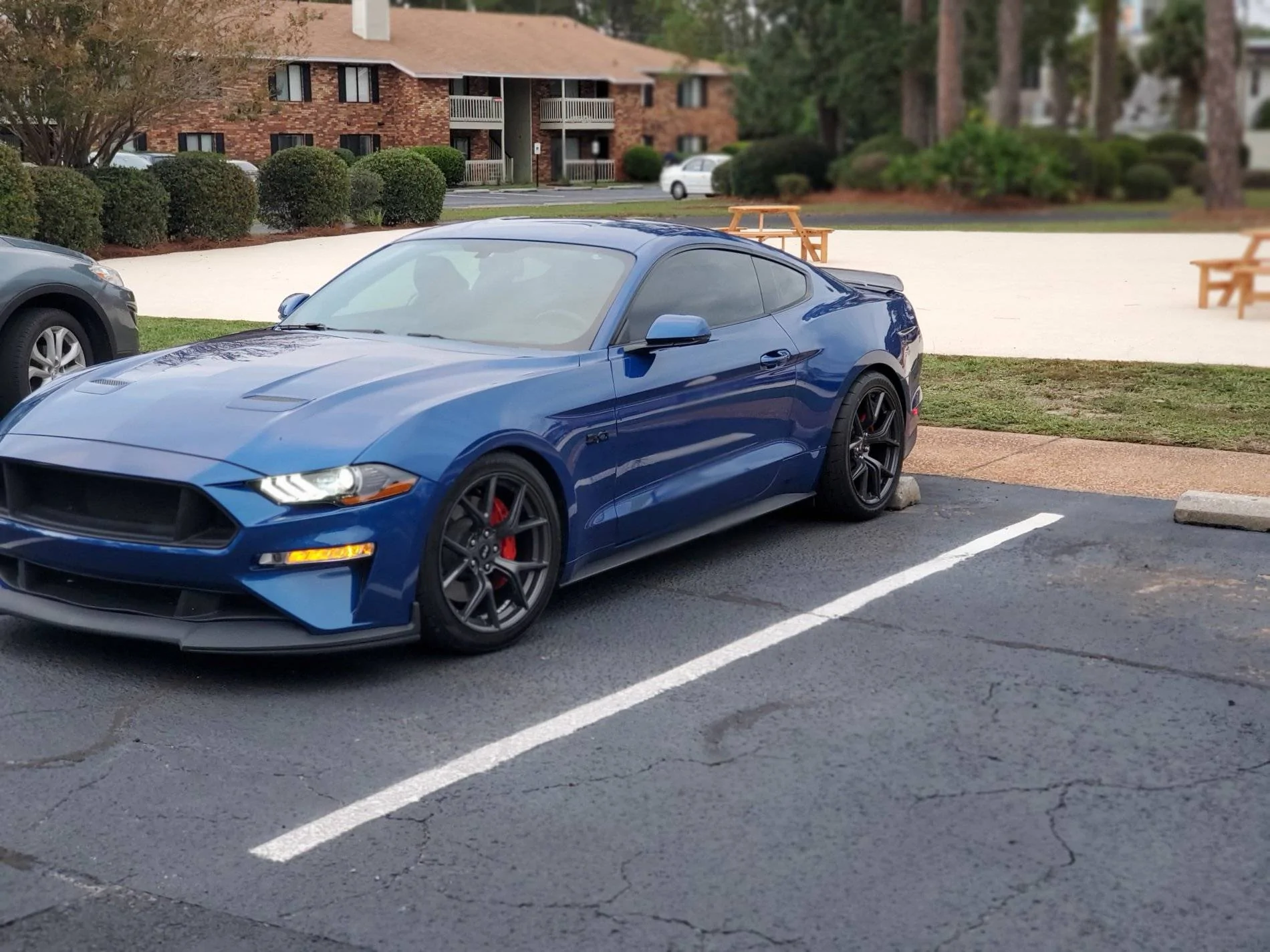

I have this size and 50 offser just for a reference

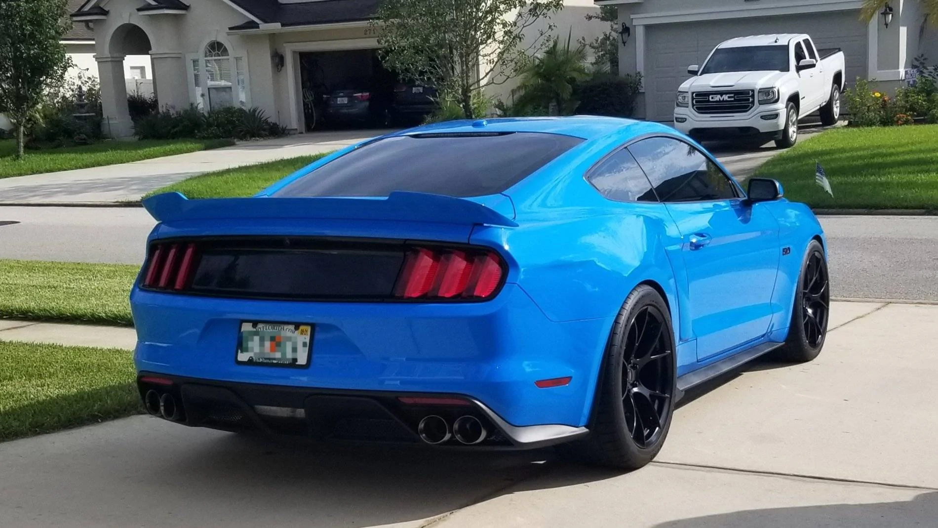

Yeah, I have MRR M600s too, same offset, 305 fits nicely, I'd suspect the 315 would be pretty good, it's only a touch bit bigger.
Though when I had my '16 (and these wheels), combined with BMR SP080s, it was pretty tight. My '19 (same wheels) I haven't touched the suspension yet, mainly because it's just so darn good with the newer PP + MR :)

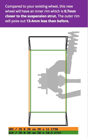

OP, here's a comparison of the 305 on my 11" ET50 vs. a 315 on a 10.5 ET57:
So I'm the orange wheel, you're the green wheel, you can see mine and @Bybcous above actually stick out a touch further (mostly to account for the extra 1/2"). It's not that easy to follow but the really squared off black lines are the 305s, and the kind of trapezoidal black lines are the 315, you can see how they're slightly bulging on the wheel. I mean, I'm sure this visualization is a bit rough, but I think it's close enough to get a sense of the fitment.
The only thing I'd point out is that inner clearance on the 315 on the 10.5 ET57, up at the top (that's not a specific Mustang suspension or anything just a generic reference).
(Backspace isn't input as that's just calculated from offset and width ...)
Hope that helps, especially combined with the photos above!

A 315/35/20 tire is almost 29” tall. They should fit but that’s going to be some goofy looking stance unless you’re running a similar size up front. Even so, that’s a large diameter wheel and tire regardless of what it’s going on. I’d consider a smaller size

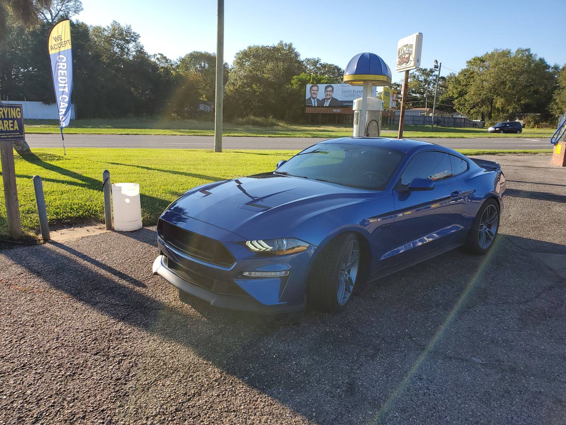

Yea i hated the way my car looked woth that tire size, happy i switched to 19s and thinner sidewall

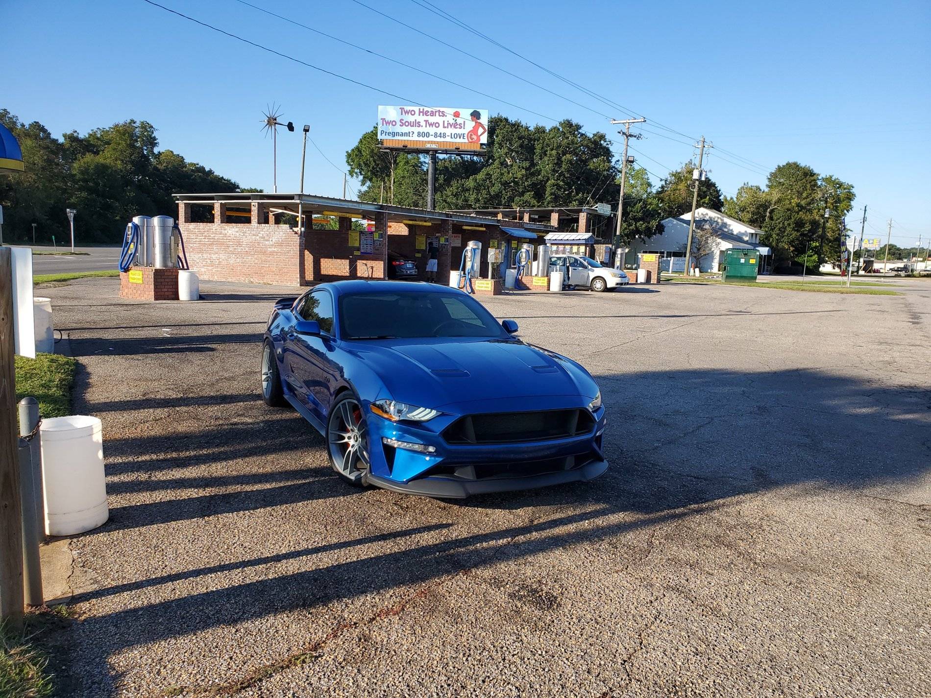

20x11 50mm. 315/35/20
Wanted as wide as possible for the whipple. Taller size helps too because I have 3:73s.

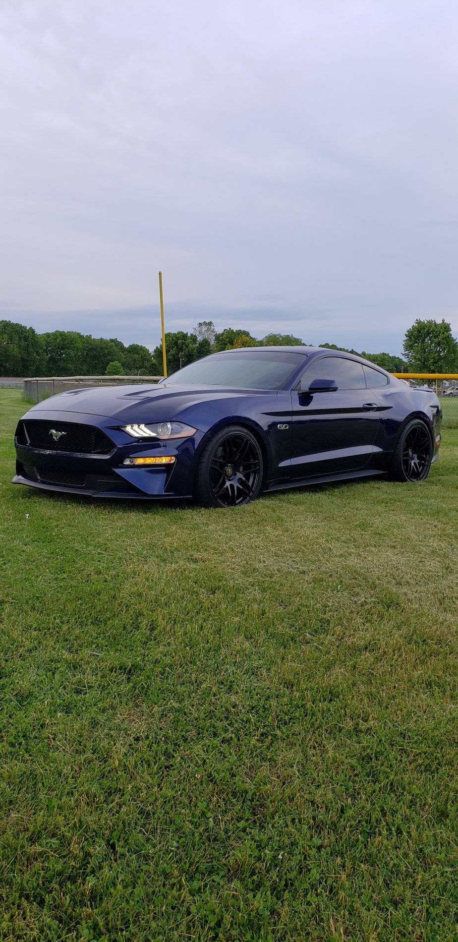

20x9.5 and 20x11 i know the 315s are technically to wide for a 10.5 but they are like new, still 9/32 tread. So if i dont have to buy new tires that would be better lol. The wheels im looking at getting are 20" weld rts
