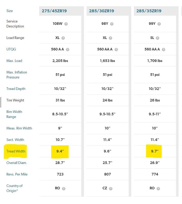

You don't need to do any hand waiving, look up the tire you want and see what the minimum required rim is.
I'm running DWS06's 265 up front and 285 in the back, that's the maximum allowed width for that tire on the PP1 rims.
But here's the thing, you need to consider the aspect ratio, I was so wrapped up in getting the "widest tires possible" that I selected an aspect ratio that was "close enough". I did 285/35/19 in the rear and 265/35/19 up front. The tires I wanted didn't come in the 40 aspect ratio in the width I wanted. The result was that they don't fill the space as well and the fitment looks wonky. I'm stuck with that until I wear them out. I would gladly trade that small amount of tread width for more sidewall and a better look. The extra cm is doing basically zero for my traction.
Look at the actual tread width (this is also in the manufacturer's data for the tire) You'll find that its not a big difference between the two overall width options. On some of the tires I looked at there was no difference at all between a stock sized tire and a "maxed out " tire.
DWS06+ shown below for an example:
Only .3" difference here, its not really worth it.
