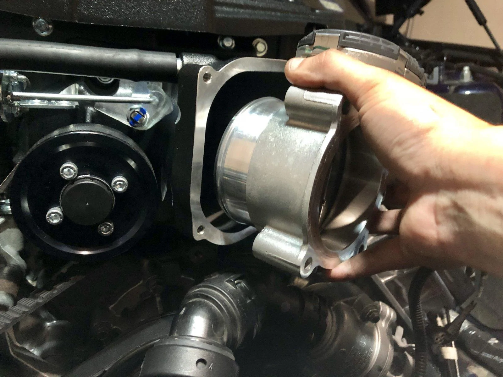

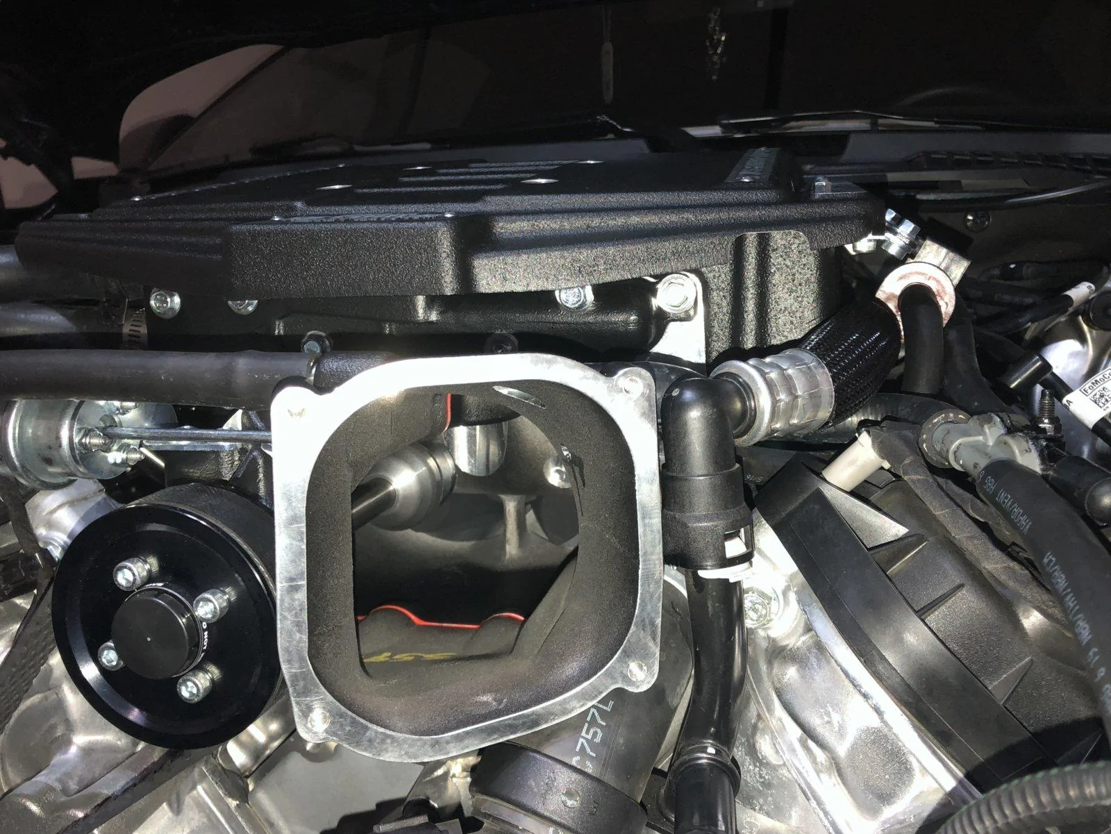

Edelbrock has posted that they have cars making 900+whp on the 103mm, that is more power than most people will ever push their cars too. Sure the 132/150 rovals can support more, but most people don't ever use them to reach those levels. Also the 103mm is 103mm round, not an oval like the twin dual blade TBs(looks to of been pointed out above). I actually asked @Edelbrock Tech about why they choose 103mm over something much larger like Whipple and they mentioned that during their testing the larger TBs were getting diminished returns as they went larger and larger. I mean, you do eventually get to the point where pressure drop is negligible and you just wont see anymore power from a larger TB.
Here is some pics of the inlet, they even made is so you could make your own adapter and run w/e TB you want, the opening is pretty large
