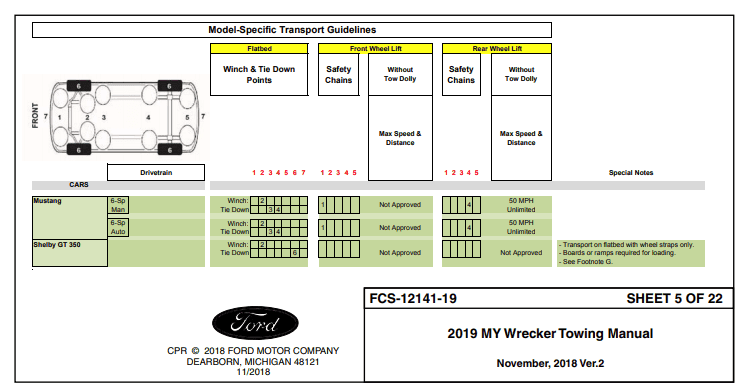

Never tow from those areas. The issue with those specific spots is this:
Once the hook is inserted and force is exerted while pulling the vehicle onto the flat bed - 99.9% of the time that hole in the subframe sheet metal will elongate or get distorted. In worst case scenarios that force will also cause metal fatigue or cracks. The subframes on any Mustang are not thick, they are boxed.

I should have made clear that I was referring to winching it up and for tiedown on a flatbed, not towing.
That being said, the Ford wrecker towing manual (FCS-12141-19) disagrees with your statements about winching onto the flatbed and tiedown points. Were those method to cause the damage described at the frequency stated, I would expect the lawsuits and warranty claims would be fairly loud on the forum, if nowhere else.
