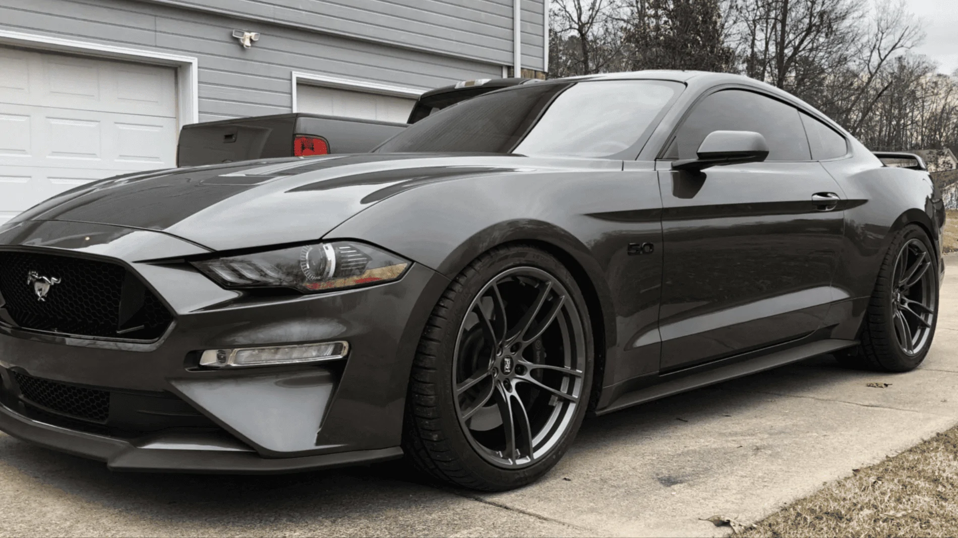

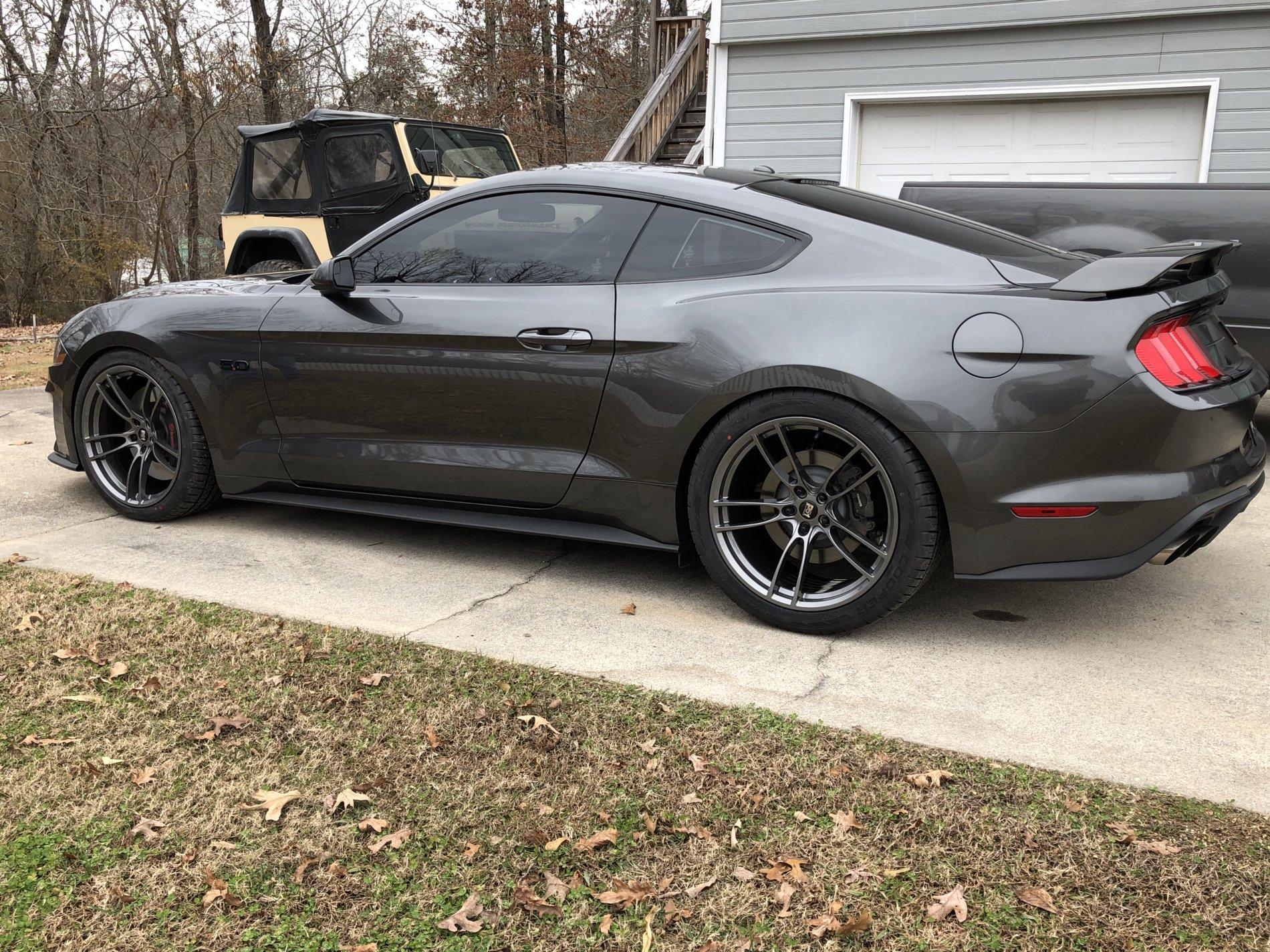

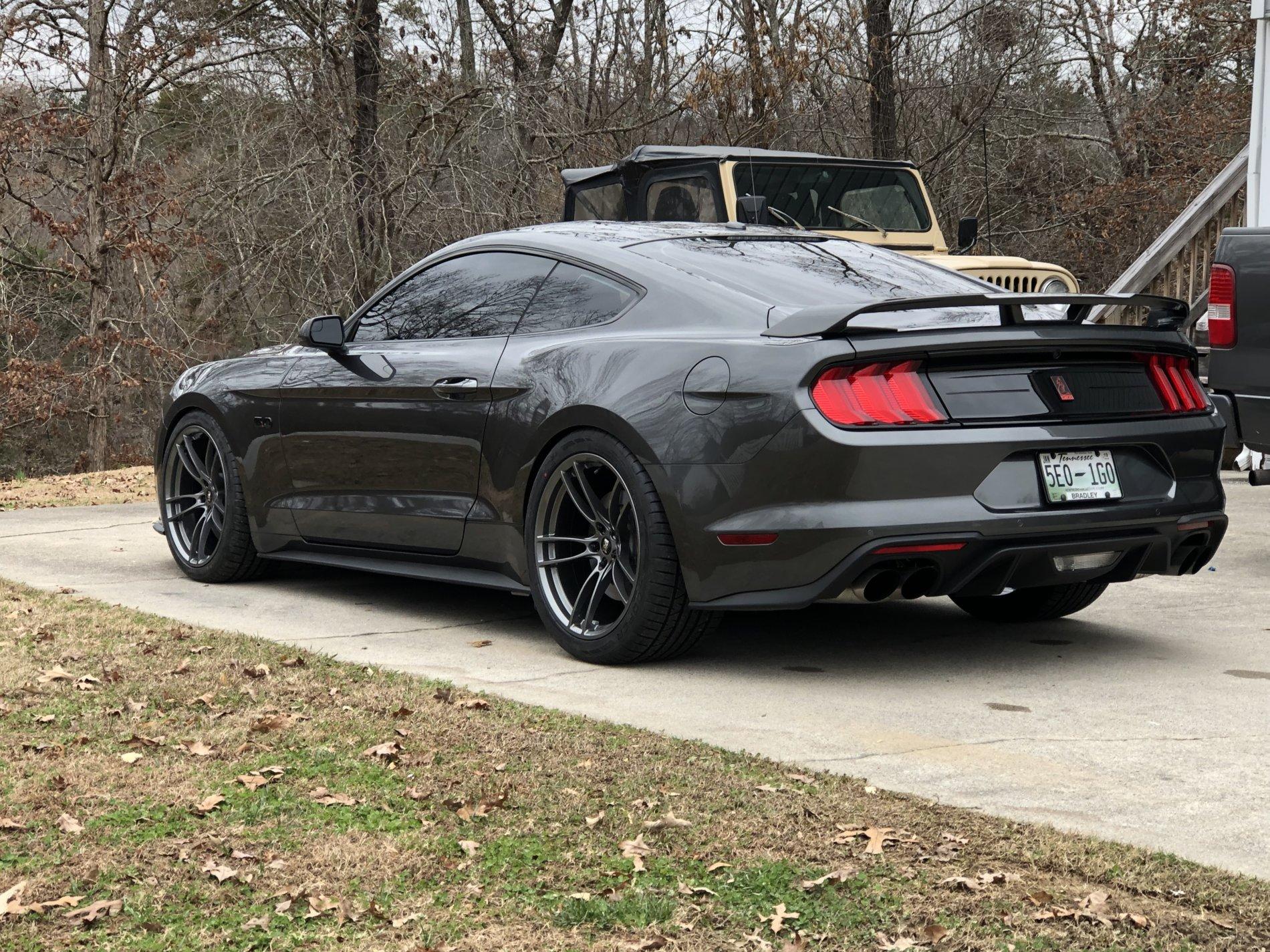

@1bad66 What's the offset on those rear wheels?
They’re + 50 and are perfectly flush..will tuck that 305/35 with no issue.
Fronts are 10” wide and +35 offset. I run a 275/35 but should fit a 285/35 if they made it in the tire I run.

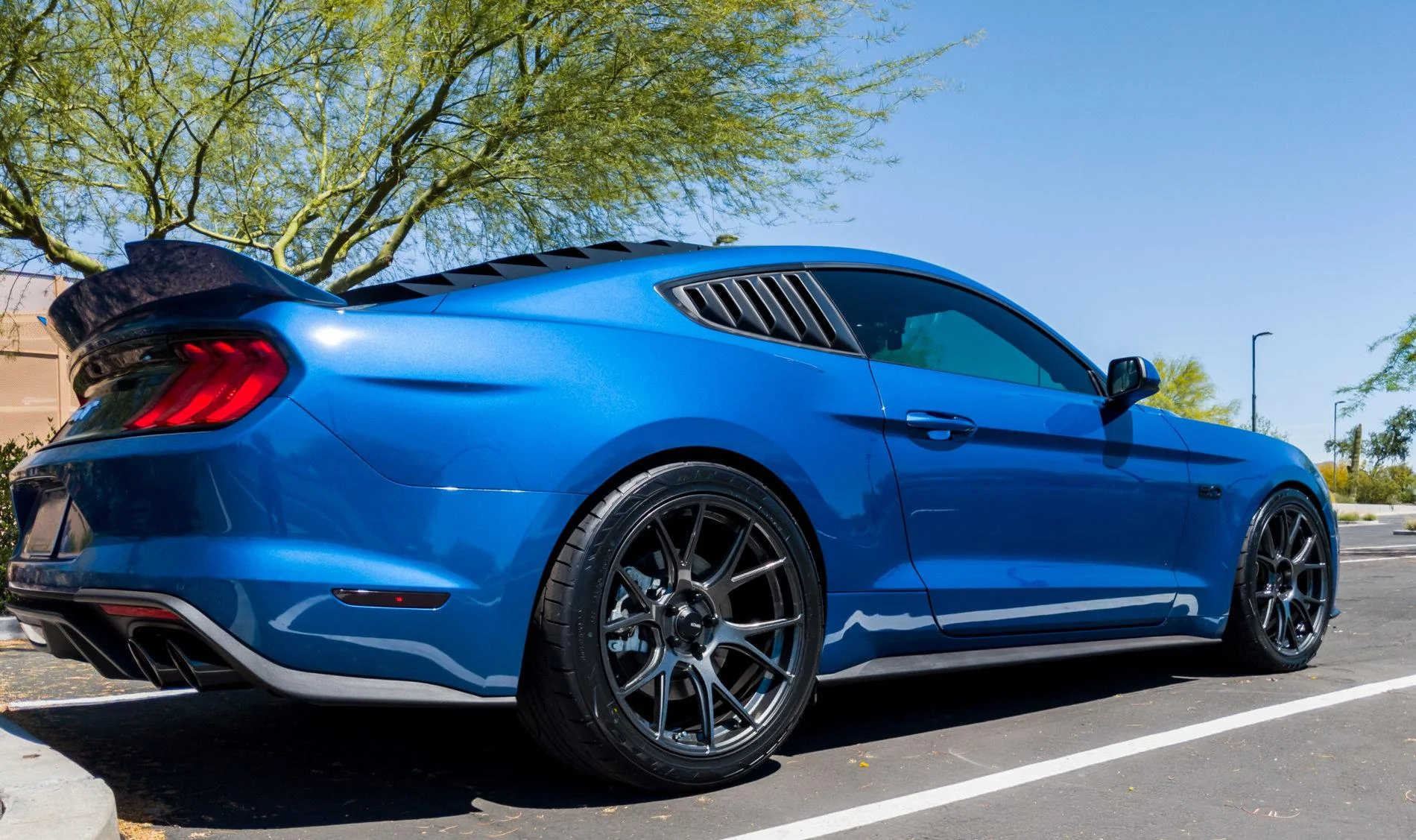

Put on 20x11 +50 with 305/35 on the rear. No spacers, sits very flush. Combined this with BMR performance springs, which have a 1/2 inch drop or so.
Went with -2 camber just to be safe with rubbing on hard bumps....
