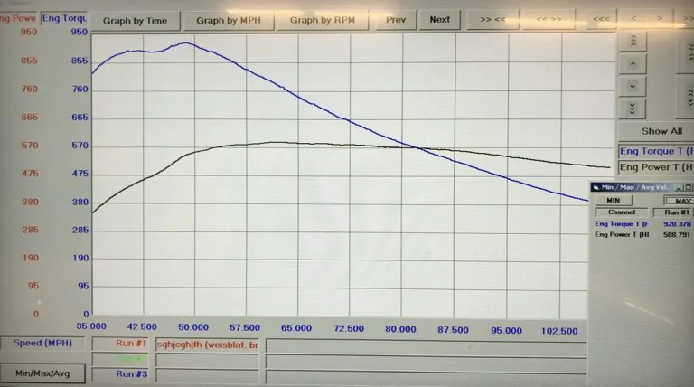

Wrong. It's about peak horsepower. What's faster 1000 hp and 100 ftlb of torque or 100 hp and 1000ftlb of torque. Drag racing requires gear ratios to keep the rpms as close to peak horsepower as possible.
Man, you really do need to do some research before you keep going down this road. Instantaneous torque is what matters for your 60'. Ever heard of the formula F=ma? Or how about a=F/m? You see, it's instantaneous torque that gets you moving. Once you're in motion, then horsepower can be used to determine how well you're going to accelerate.
How well does the GT350 do on the dragstrip with the first 60'? Ever wonder why it's such a PITA to get a decent launch?
Have you ever seen a Tesla P100D's horsepower and torque curve?
It's not the HP that get's you moving, it's the torque.
Now with all of this said, it's RWTq that matters for the launch, so gearing absolutely can play into the equation. The difficulty with higher rpm cars (GT350) is that as soon as you gear for a better 60', you make the first few gears EXTREMELY short. This is a contributing factor to why the A10 makes such a HUGE difference in the mustang and such a small difference in the camaro.
Holy cow. You said something that's correct. You even flipped your stance and said that area under the curve matters.

Listen, I have no problem with the way you read Joe's quote. It was however ambiguous enough to require more information to determine why you or I support that. Many people in here have not done that.
I fully understand what your saying about this not be a high revving engine. I think however you are underestimating that the huge amount of torque this engine is going to make will dictate it having a respectable horsepower number. Remember, HP = Torque x RPM ÷ 5252.
You also have to keep in mind that performance is a relative term. Performance on the track? Performance on the drag-strip? How about stoplight to stoplight? 0-60? Hell, what about which car feels faster?
Huh? Go back and read my posts my friend. I've always said it's area under the curve.
Actually you're both "wrong" but I think "over simplified" or "incomplete thoughts" are more appropriate. AVERAGE max power wins assuming all other variables are the same like gear ratios, weight, etc.
