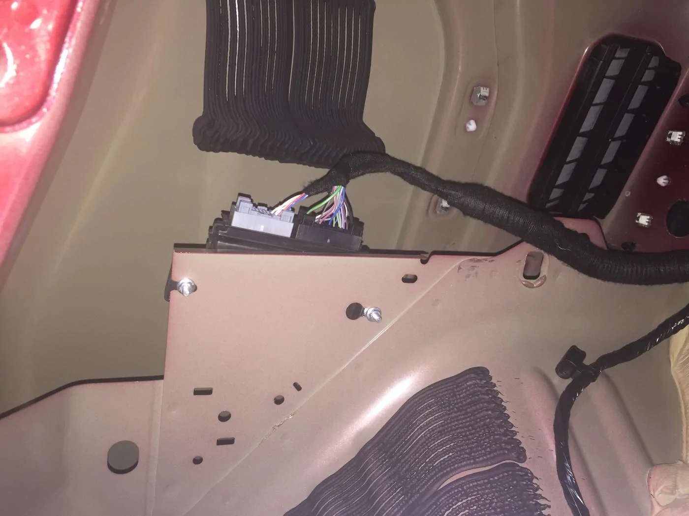

So, I did what CobraJet did. I tore the trunk carpet back, and sure enough that little module was easily vibrating and making noise. The module itself was tight on the sheet metal, but it can easily vibrate, because that sheet metal is so thin. When I would flick it, the sheet metal would make a noticeable bit of noise. Also, the plastic bracket holding the wiring was loose as well. So, I tightened it all up the best I could.

Here's the pic from CobraJets trunk to show what it all looks like.
Now, imagine a cheap pillow stuffed back there behind the module filling that whole void.

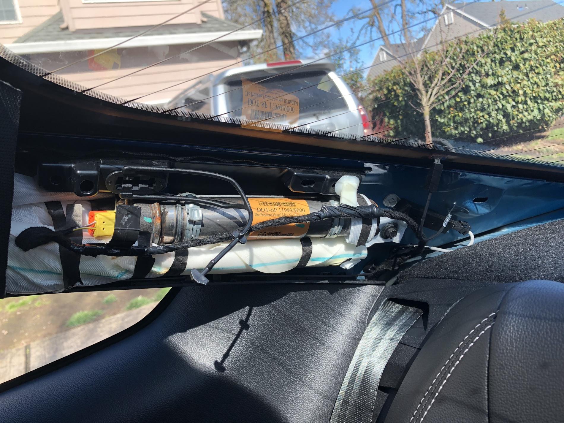

When you take the pillar cover off, you'll see the airbag and gas cylinder. Those are strapped to a metal plate that is actually bolted to the metal C-pillar of the car to prevent movement. However, between the C-pillar and the airbag mounting plate, is a plastic piece of framework that the pillar cover snaps onto. That plastic back plate is what tends to move around and rattle. Here's a pic of the guy who used felt.
You see the little dangling plastic connector that holds onto the pillar panel? That is connected to a plastic backing behind the gas cylinder. It has those holes where the panel cover snaps into. That plastic backing is what makes noise. Now, if you look carefully at the gas cylinder, you'll see the edge of the airbag mounting plate behind it. That plate holds the bag and cylinder to the metal framework of the car. It has a black bolt literally bolting the plate and the airbag itself to the car to hold it solidly in place.
Just fill the foam behind the metal airbag plate, and the fill the gap between it and the plastic framework. As the foam fills that gap and expands, it will push that plastic backing against the C-pillar and keep it from rattling around. Sorry guys, wish I took a pic. Just fill behind that metal plate with lots of foam, and just make sure you don't put any on the airbag itself.

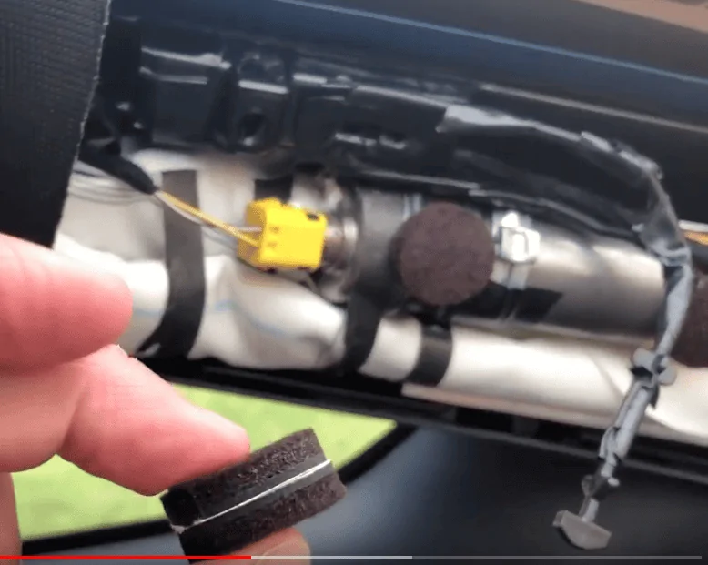

Hey guys, new member here. Proud owner of a 2019 GT, Velocity blue. I had the C-Pillar rattle shortly after delivery of my vehicle. I did not want to bring my car back to the dealership just yet (and lose a day or two of driving) so being *somewhat* handy, I did some sleuthing, found the source of the rattle, and fixed it. Posting here in case this helps anyone else. This is super easy, like 1 out of 5 wrenches. ;)
Short video here: youtu.be/XmqcKfnoUBs

That is a source of noise for some people, but definitely not the majority. I took the panel off, and even removed the plastic lanyard. Still rattled.
The noise for most is actually back behind the air bag. That's why it's been so maddening to fix.

Thanks Condor1970 - In the latter half of the video I address the rattle behind the metal air bag pressure vessel. That is what ended up solving it for me.
