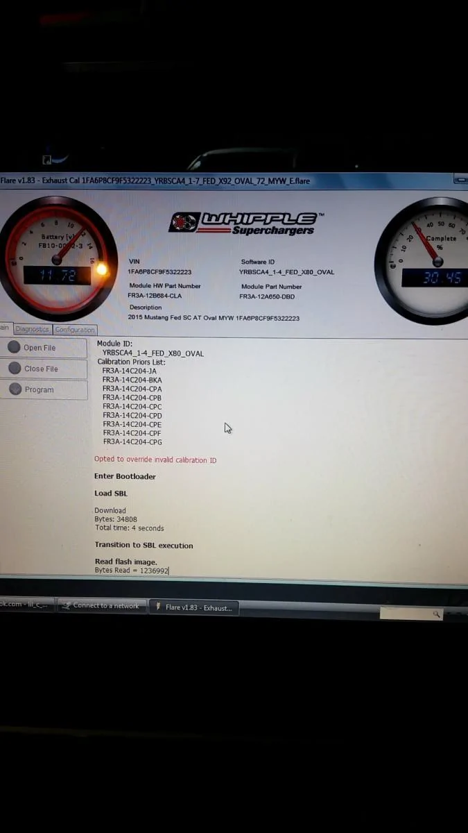

Once you make a change on a setting with Flare is it important to open the exact file each time?
So far I only made tire size changes and it didnt seem to matter if I used a file at home or one at work, but wondering about future applications.
When it reads stock file and then puts new flash I, the flare file is updated with the stores stock file. Since yours had a modified file already it doesn't really matter so no worries.
As for changes like all the new features and wheel/axle, that doesn't matter which one you use.

Got the new cal and the new v1.83 software in today. The new software has a lot of great new features, you can change certain parameters on the fly. It's all loaded up and ready to go through some tests Friday, stay tuned for the results. Thanks Dustin.

Is the flash tool still only working on PC's or have the bugs been fixed for Mac's yet?
evo8904
I'm a member???
Nov 20, 2014
2,503
778
Tampa
Luther
2017 Ram 4x4
I got mine to work with my mac but it was a PITA. Not the flash tool's fault.
what did you have to do to get it working on your mac?

Mine works with my Mac as well, after I had software developer do a correction. He did tell me that when the new software is ready that it will be fixed.

Guys, for Mac if you look at the link that's in the pdf, you can add a (.) instead of a (/) after the www and it should prompt a download. I have it running on my Macbook.
