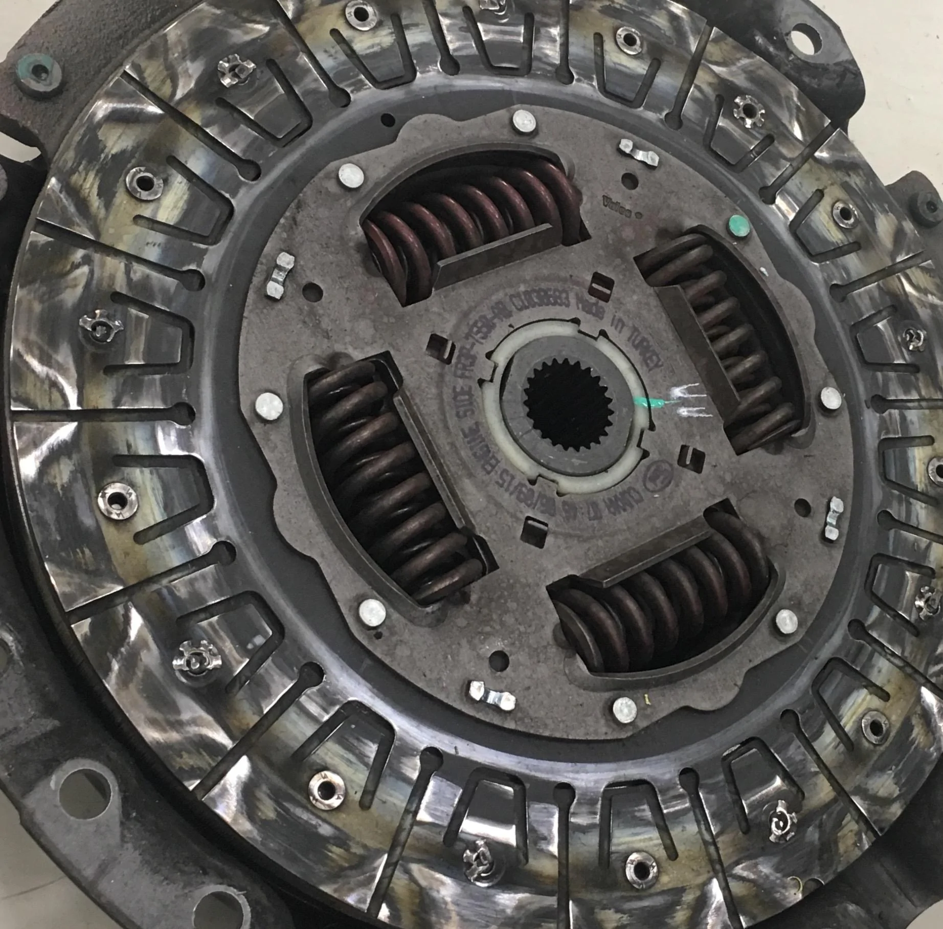

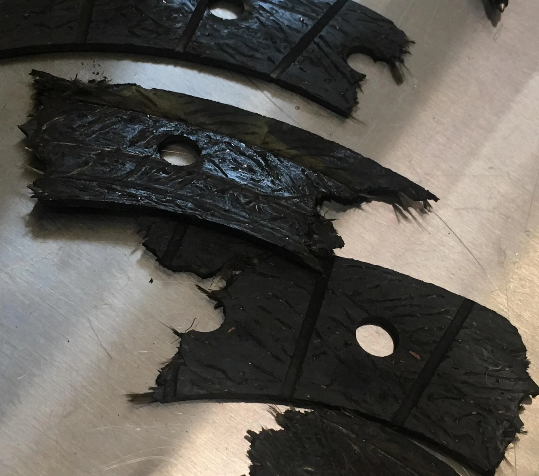

The $975 is organic full faced, rated at 800lb/ft. This is on par to the McLeod RST. It is not comparable to the RXT (solid hub, ceramic, 1000lb ft) nor the Mantic (sprung hub, ceramic, 1010lbft).
The 5.0L Force 10.5 Dual Disc 300 Series Clutch Kit is the closest in design to the Mantic, with a sprung hub and 900lb ft rating, but still uses organic full faced disc which I would argue will still fail under heavy shifting and heat. This retails at $1355
There is no ceramic with sprung hub option from Ram. Yes they have horsepower and torque ratings that cover all grounds, but I would be concerned running a full faced organic clutch past what they have them rated for.
The next step up from the Force 10.5 is their Force 10.5N but that uses 900 series clutches, which are solid hub. Its also close to $1500 and rated at 1300hp, I believe they recommend converting to their hydraulics (no idea on price for that)

... The next step up from the Force 10.5 is their Force 10.5N but that uses 900 series clutches, which are solid hub. Its also close to $1500 and rated at 1300hp, I believe they recommend converting to their hydraulics (no idea on price for that)
I think the Force 10.5N are hybrid, at least according to this ebay ad :
"All 900 Series discs use the high strength eight spring hub and Poly-coil springs for extreme dampening capabilities. This clutch disc is recommended for severe duty street and strip applications where driveability is not the highest concern.
Centerforce DYAD Clutch Kit maybe similar
High torque capacity up to 1300 ft/lbs at the flywheel
Fully dampened clutch system developed for vehicles with extreme power levels
Smooth engagement and light pedal effort
Sprung Hub Discs. Centerforce Clutches were engineered with sprung hub disc centers. A sprung hub helps dampen gear rattle and allows for smoother engagement with light pedal effort. This not only provides excellent driver control, but increases the longevity of your Mustang's transmission; when compared to standard rigid center hub discs.
