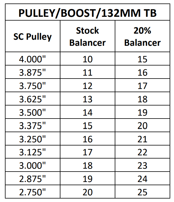

From the whipple install manual for a Gen5 3.0 stage 2 kit:

The stock balancer size is 6.57." The overdrive (from ATI) of 20% is 7.88."
You could do the crude 20% and trust it so, 3.75*.8 = 3.00"
Or you could do the actual math and go 3.75*6.57 = 7.88*x: X = 3.12"

True, BUT: I could just use the chart given below. LOL
