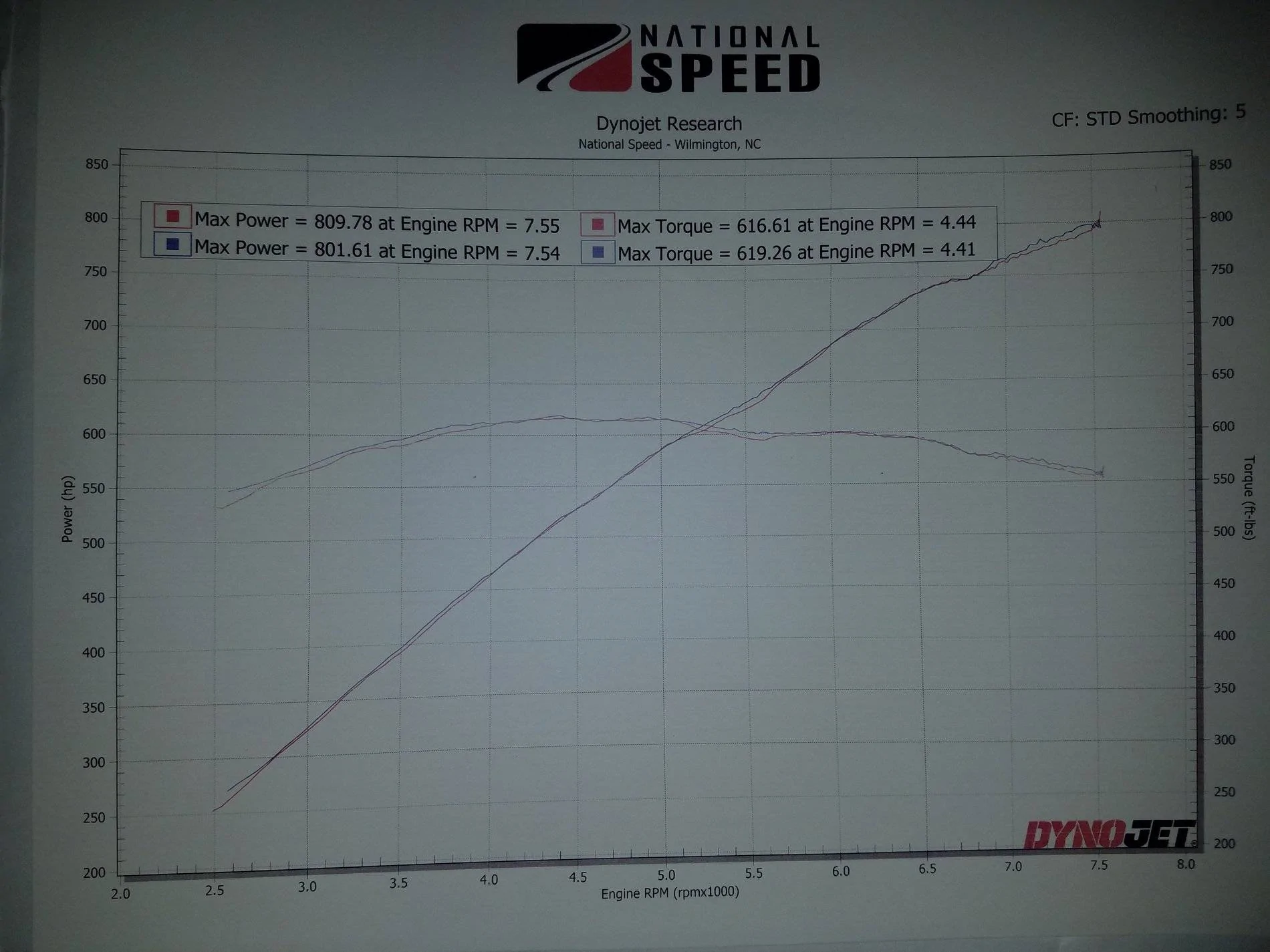

I made 809 wheel on 93 with one 16oz can of Boostane. Stage 2 whipple, 72lb injector, VMP BAP, 3.65 pulley, full 3in exhaust, headers, no cats. 22° timing advance, 0 knock around 7700 rpm
Nice numbers! Curious what gears you are running in the rear? Your torque looks great.
