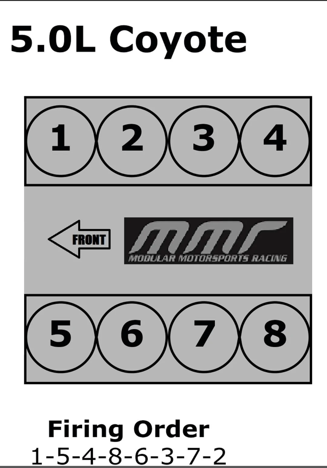

Another question. I am coming up on a step where I have to cut a hose. The instructions state it's best to cut it between cylinder 5 and 6. Is this diagram correct for number cylinders on a Coyote engine?
