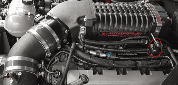

I was wondering if anyone can post a pic or explain how they ran the EVAP extension wire?
Its the wire that goes to the EVAP circled in red.
Thanks!

I think Your MAF should point out towards the front instead of straight up

Mine does, this is a pic i found online is all.

The pic shows how the wire is run. It is tucked in between the supercharger body and the evap hoses.
