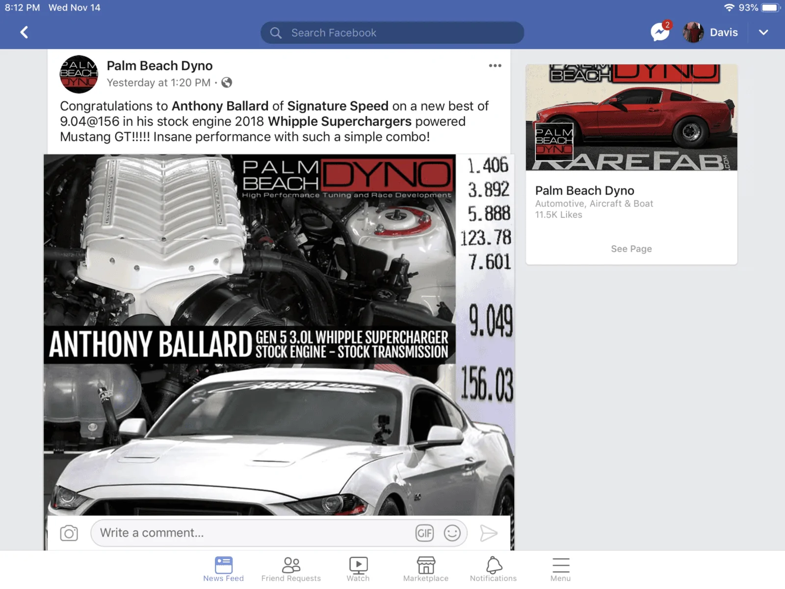

Anthony Ballard owner of signature speed ran this at 4020 lbs. at the Mod Nationals last week. Goes to show that a properly built blower car can compete with the twin turbo kits out there. That MPH speaks volumes at that weight.

Yeah, these new larger displacement blower put in work, from what I've seen there have been a lot of 2.6 TVS and 2.9/3.0 Whipple's running 150+mph,

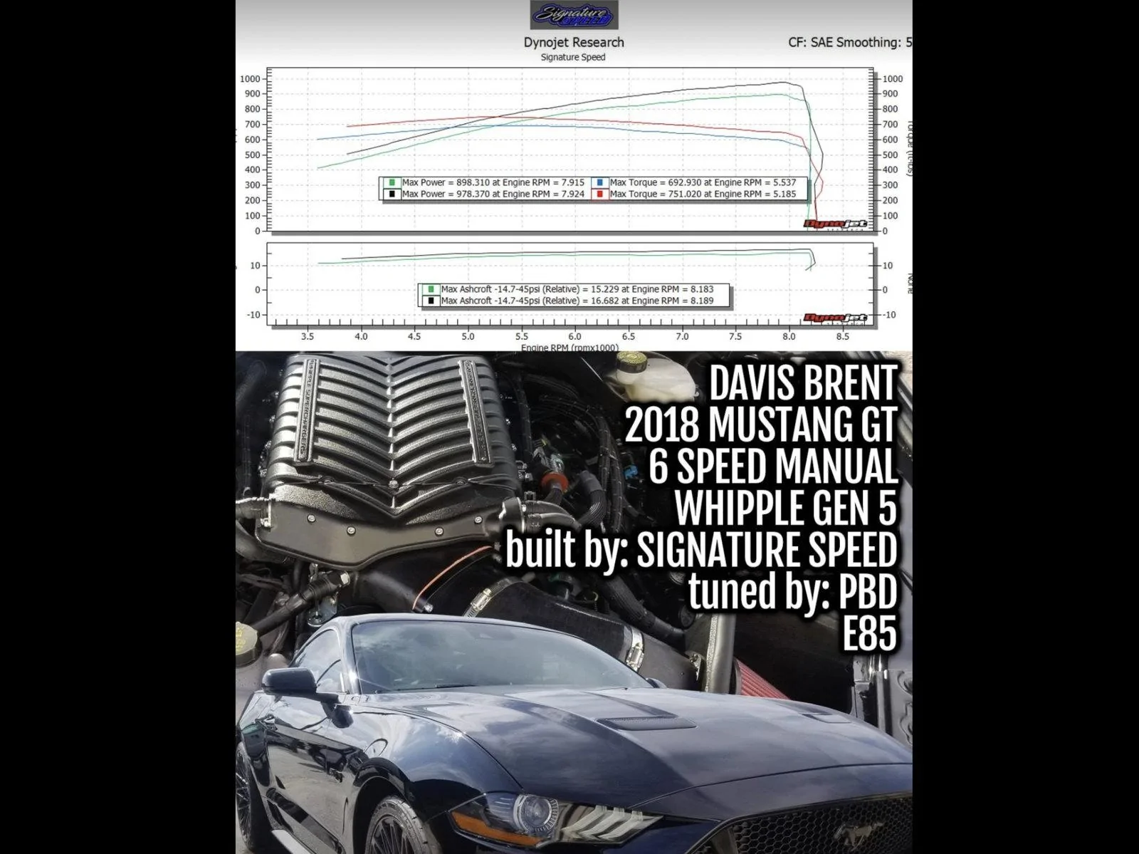

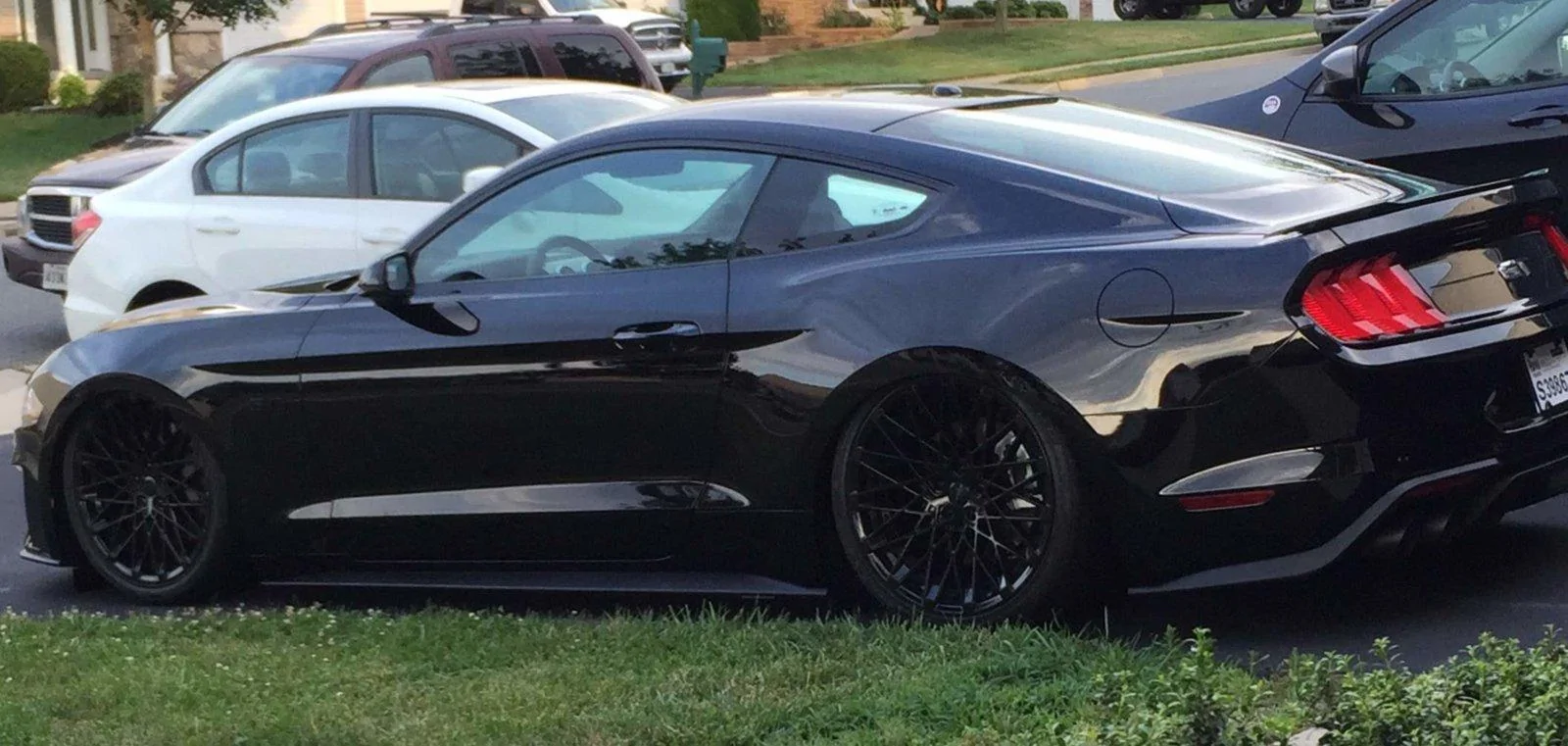

Yeah that is flying. Anthony put my ‘18 together as well with the same parts as his except I’m a M6 car. Just didn’t want another automatic this time.

Awesome car, man!

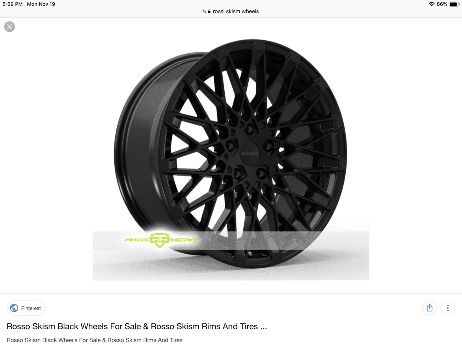

Off-topic, but, what kind of wheels are those?

Full mods on OP car?
Stock Engine with Boundry OPG/CG
Stock M6 transmission & clutch
Full Fore fuel system with controller on E85
ID1050X Injectors
Whipple Gen5 blower with 20% lower & 3.625” lower pulley
10 Rib pulley system
Standard heat exchanger
MBRP 1 7/8” LT’s
3” H-pipe with cats
3” MBRP cat back and mufflers
Full Steeda Stop the Hop kit
Airlift air bags
