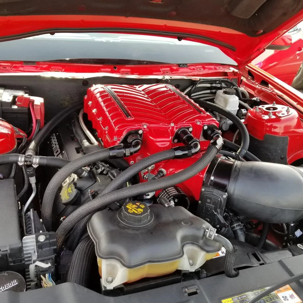

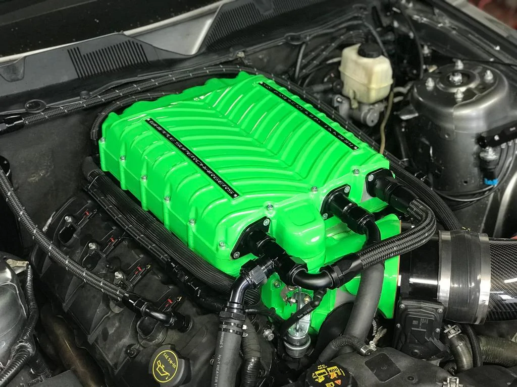

Here's a few pics of the Gen 5 kits on the 11-14 cars. They'll look identical on the S550. Let us know if you have any questions in the meantime.
Looks awesome!
But, both those pics have different intercooler line set-ups going into the blower. What’s the difference? I see one is T’d off and the other is not.
Heat exchanger bolts up ok? Still recommend the larger HE and does it actually fit with the adapative cruise on a 16?
