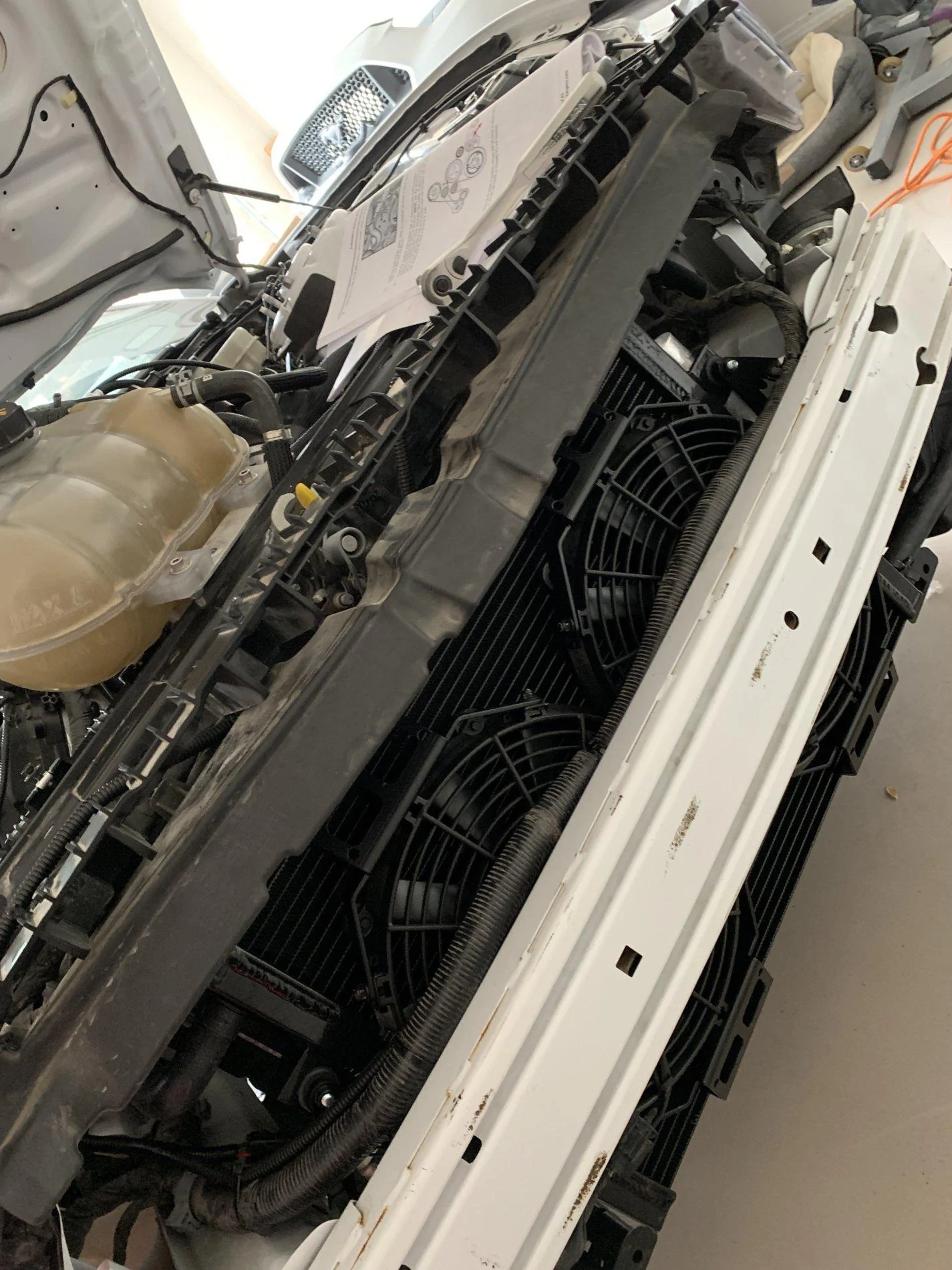

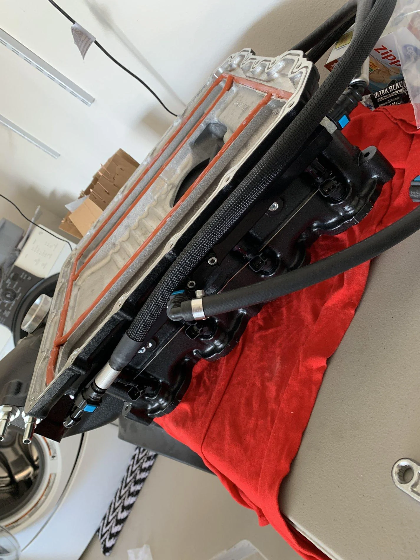

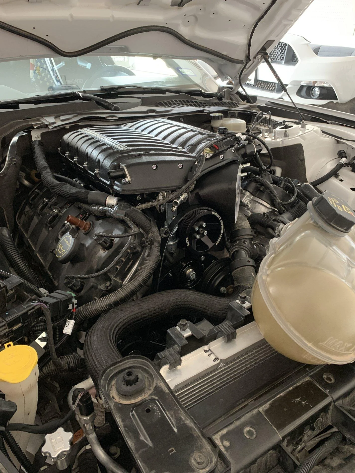

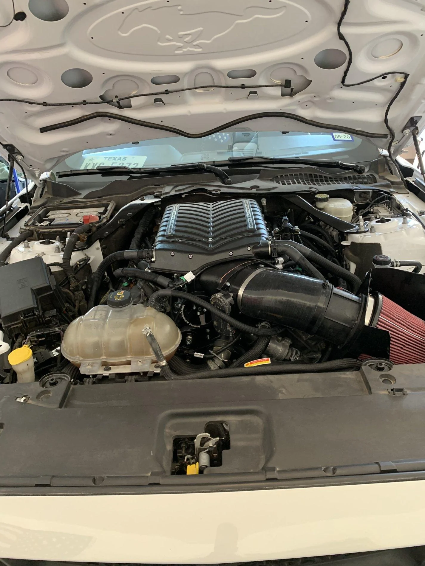

Ok so some more issues I ran into during this process.
I had an sct livewire that decided not to work anymore so I got a BDX from a friend. Luckily SCT helped me out with a recovery file and I was able to use it since the livewire was still married to the car.
I was able to load to tune to the car (tuning by Lund)
But when I did my OPG and CS I messed up the timing
So I had the car towed to a shop down the road from my house and I should have it back sometime next week. I just want to drive this thing!!
But here are some update pictures and besides all of these things going wrong it was pretty fun doing all this work myself. I just couldn’t bring myself to take everything back off again.
