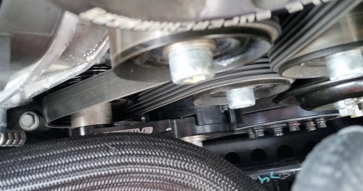

For those of you who installed the new tensioner, did you keep the original belt routing or the "new" belt routing with different belt? I had my shop put the new tensioner on during the week and the clicking and squealing noise went away. However, I started the car this morning and the squeal came back. I popped the hood and noticed the belt is only riding the edge of the pulley above the tensioner. I'm taking it back first thing in the morning for them to readjust and throw a new belt on as mine has been worn.
I have seen mentions of a "new" shorter route method to run the belt. I want to pick up a new belt today from one of the local stores so that I will be ready to go tomorrow when I drop the car off. Just need to know which belt to get.
Any help would be greatly appreciated!

Did you instal the new plate stands as well, they help with alignment. My understanding from whipple is the longer routing is more forgiving than the short. I would call Whipple and get the new stands if you haven't got them.
New plate stands were installed to my knowledge as they did come with the tensioner. I'm going to try one of the duralast belts and see how I make out tomorrow. I'll keep you guys posted.
