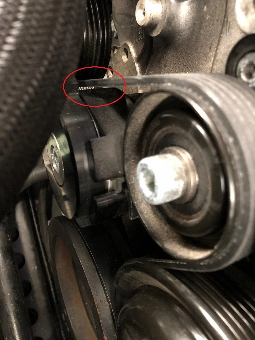

So I decided to try the RPM again. The only way to get clearance from the tensioner is to set it at about 45% of of travel. No way you could hit the 20-30% that's recommended. I'm a little concerned about this tiny gap I have now.

Are you running the 106.6 or a longer belt?

106.6 in this case Same as the Green I had on it but now I had to move the adjustable idler all the was towards the crank to get it where it is.
