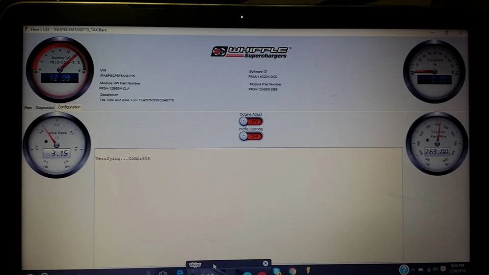

I am very pleased with my Whipple Flare Device. Now I'm only using it to correct gear/tire ratio in the BCM (Body Control Module) but this is very important info when getting an automatic to shift when you want it to.

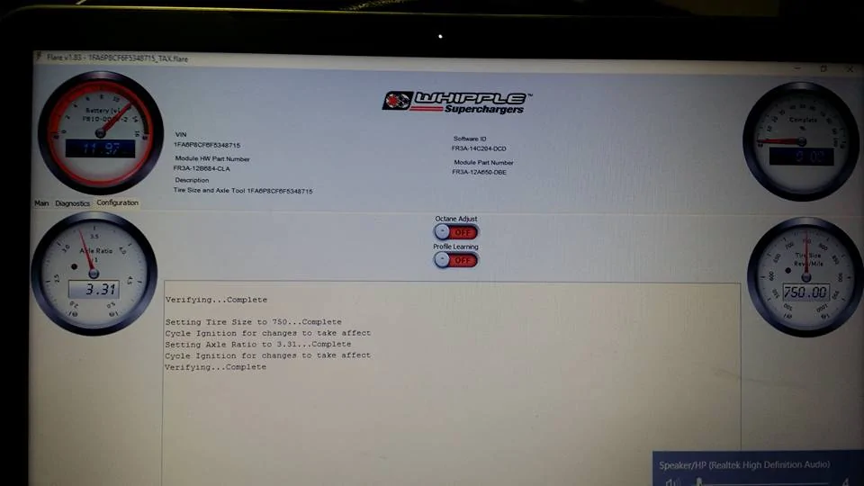

It was very simple and quick to correct. In the pics you will see I went from 3.15 gear and 763 tire revs to 3.31 gear and 750 tire revs. And after some road time I can hone in the tire revs even closer if need be.

Because this info change is done in the BCM my LUND Tune is not affected.

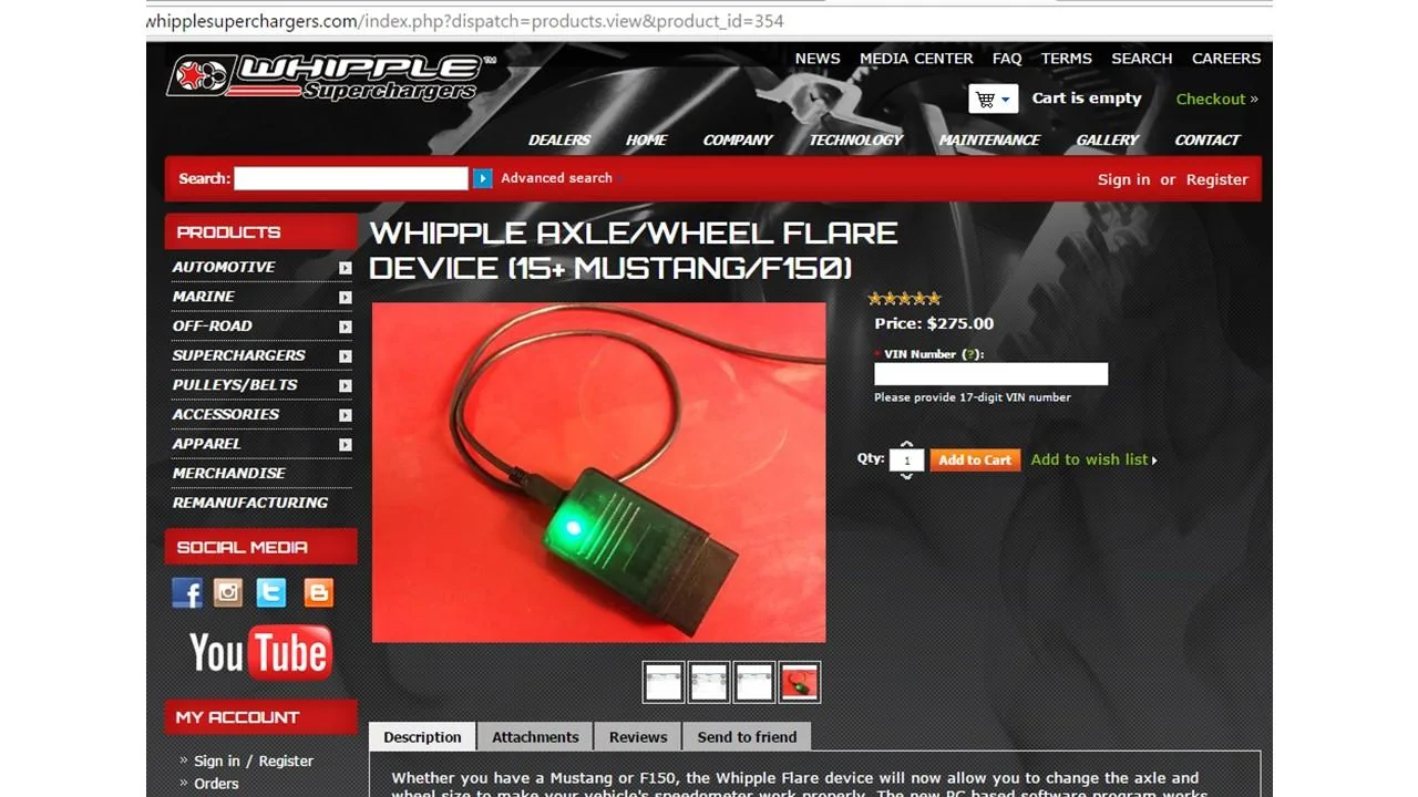

Interesting. I may have to pick this up to fix the speedo discrepancy. Pricey for what I'd use it for, but useful nonetheless.

Buy a Whipple also while its on sale, so you will get more use out of the flare tool. :cheers::cheers:

Trust me, I wish I could. Maybe by the end of the year. Gonna start saving my pennies.
