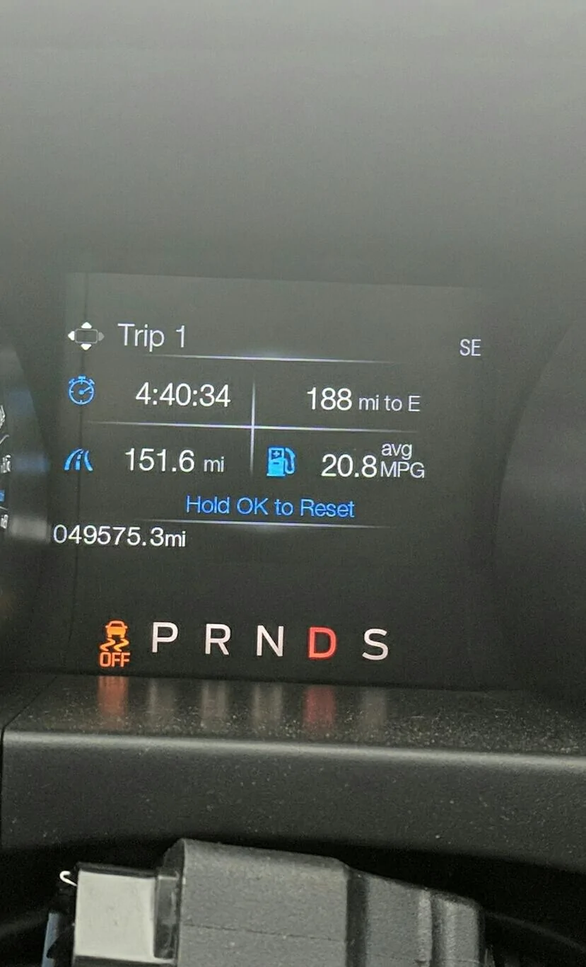

For those who have been having an issue with the Whipple tune and have replaced the cats; what kind of MPG have you been getting.
I'm curious if having the plugs gapped incorrectly would cause a significant decrease in MPG.
If I wait until my car is warmed up and reset the mileage calculator once I start moving, best city MPG I can get shifting before 2k rpm is 10.x MPG if I catch all green lights coming home. If I don't consciously try to get the best MPG and shift normally between 2 and 3k RPM I'm averaging about 8 mpg city.
Zero issues with my Whipple. I am averaging 19-21 mpg. If I didn't have to sit in so much traffic I could probably see 22-23 average. For reference, Stock I was getting 26-27 on good trips. Lund tune/steeda CAI I was getting 22-24. The automatic shift points have a lot to do with it. This is all what the gauge says not actual calculations with mileage and fuel.
