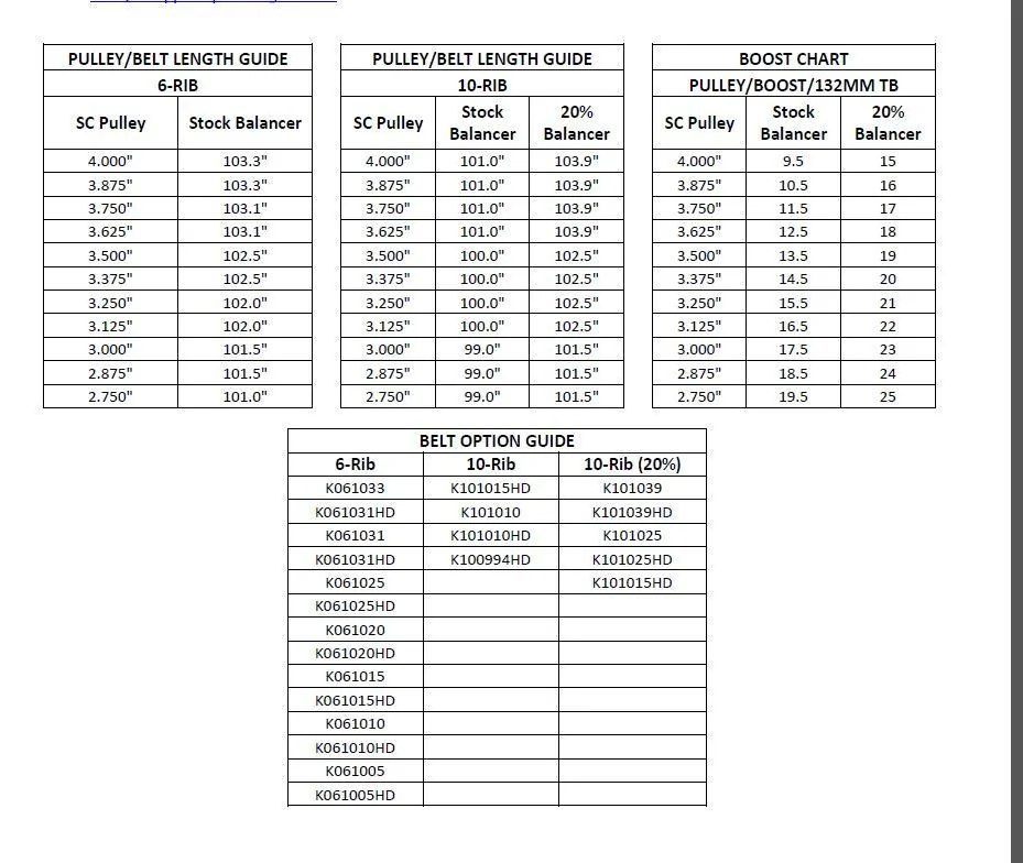

This whipple chart helps. Shows pulley size to belt length. Also the newer routing for reference.
