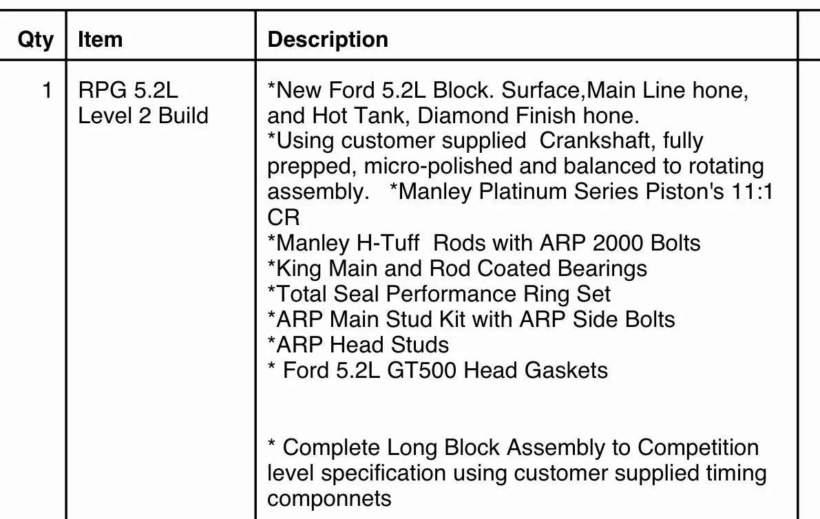

I know everyone has a budget, but if you're going all that way and paying all that money, just spend few hundred extra and get some billet I beams.I just want to see how much I can make on the gen 3 and 5.2 predator rpg motor. So I won’t have to wait for the whipple 3.8 to come out lol.
What you're buying is this:
If you EVER want to grow bigger, it'll cost you THOUSANDS to do it safely vs. if you decide not to go bigger, you've spent a few hundred (but you've also got some additional safety and peace of mind)
