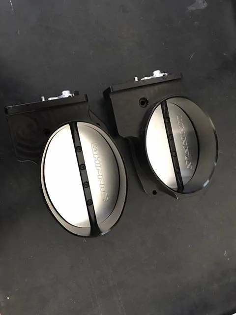

Exclusive pics of the all new Gen 3 2.9L all setup for the massive 150mm throttle body.

Whipple Wednesday here at Lethal Performance! Exclusive new picture of the Whipple 150mm throttle body and Gen 3 2.9L supercharger.
Give us a call if you guys have any questions and we'll be glad to assist you.

As far as I know right now you will need to buy the 11-14 throttle body separately to swap over the electronics. Whipple is still putting the kit together, so we will know for sure when all of the information is released, but I've been told you need to source it.
Which 11-14 TB would be need?
LethalPerformance
Sep 5, 2014
332
3,271
2,033
Fl
2020 Shelby GT500 CFTP, 2021 Whipple'd F150
I believe just a stock 2011-2014 mustang GT throttle body is what you need. You're just using it for the electronics.
Is that because the 11-14 had a stronger motor in the TB or is it something else?

Do we send the tb in for them to swap the electronics or would we have to do it?
You'll do the swap. It's very easy to do.
The 11-14 uses different electronics than the 15-17. So the throttle bodies for each of those models are machined differently to accept the electronics for that specific model year electronics. At the moment Whipple only has the 11-14 style TB in stock. The 15-17 is a few weeks out. However if you want the 150mm setup now for the 15+ you'll just purchase the 11-14 model from whipple and use 11-14 electronics onnit.
