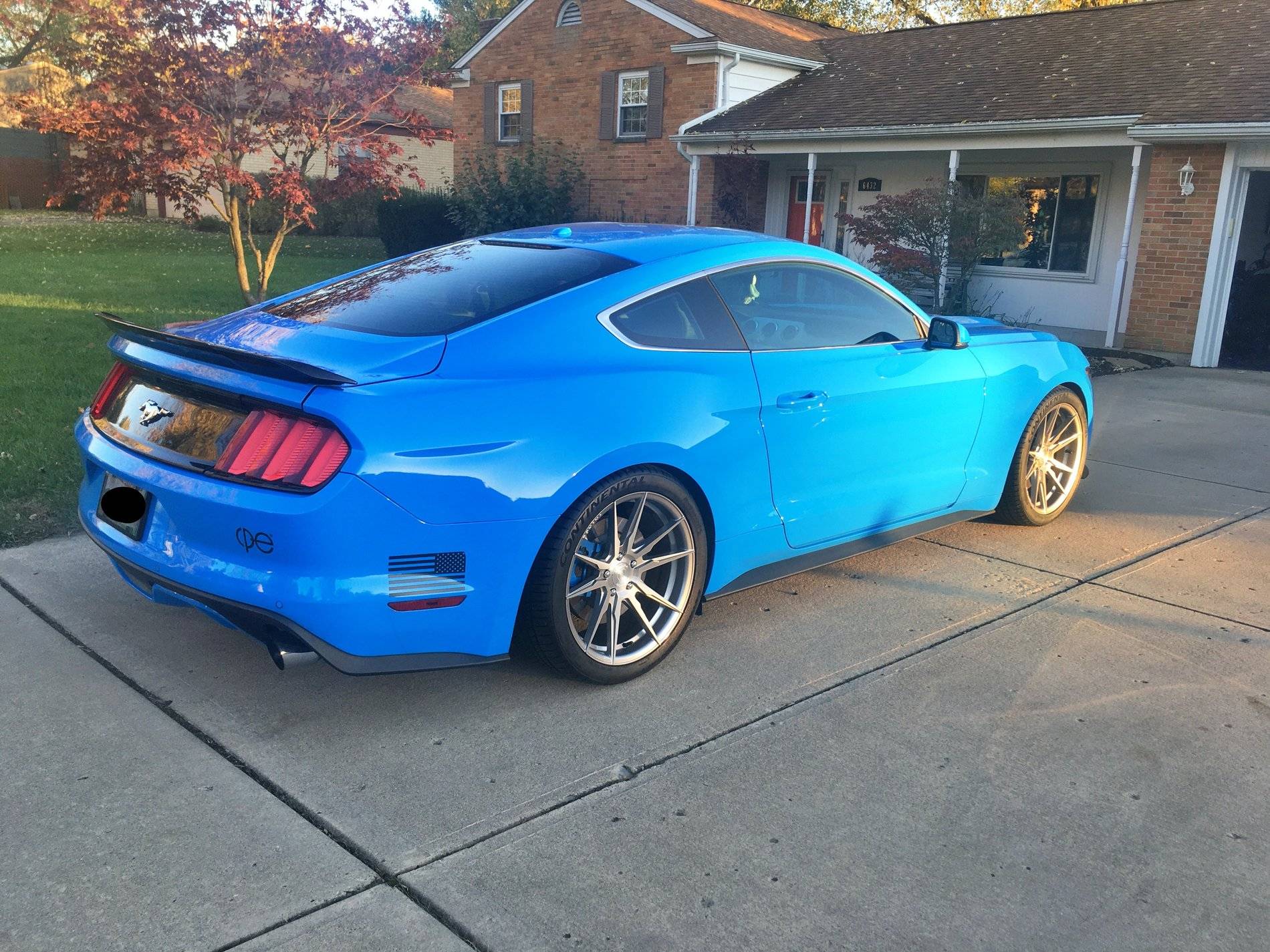

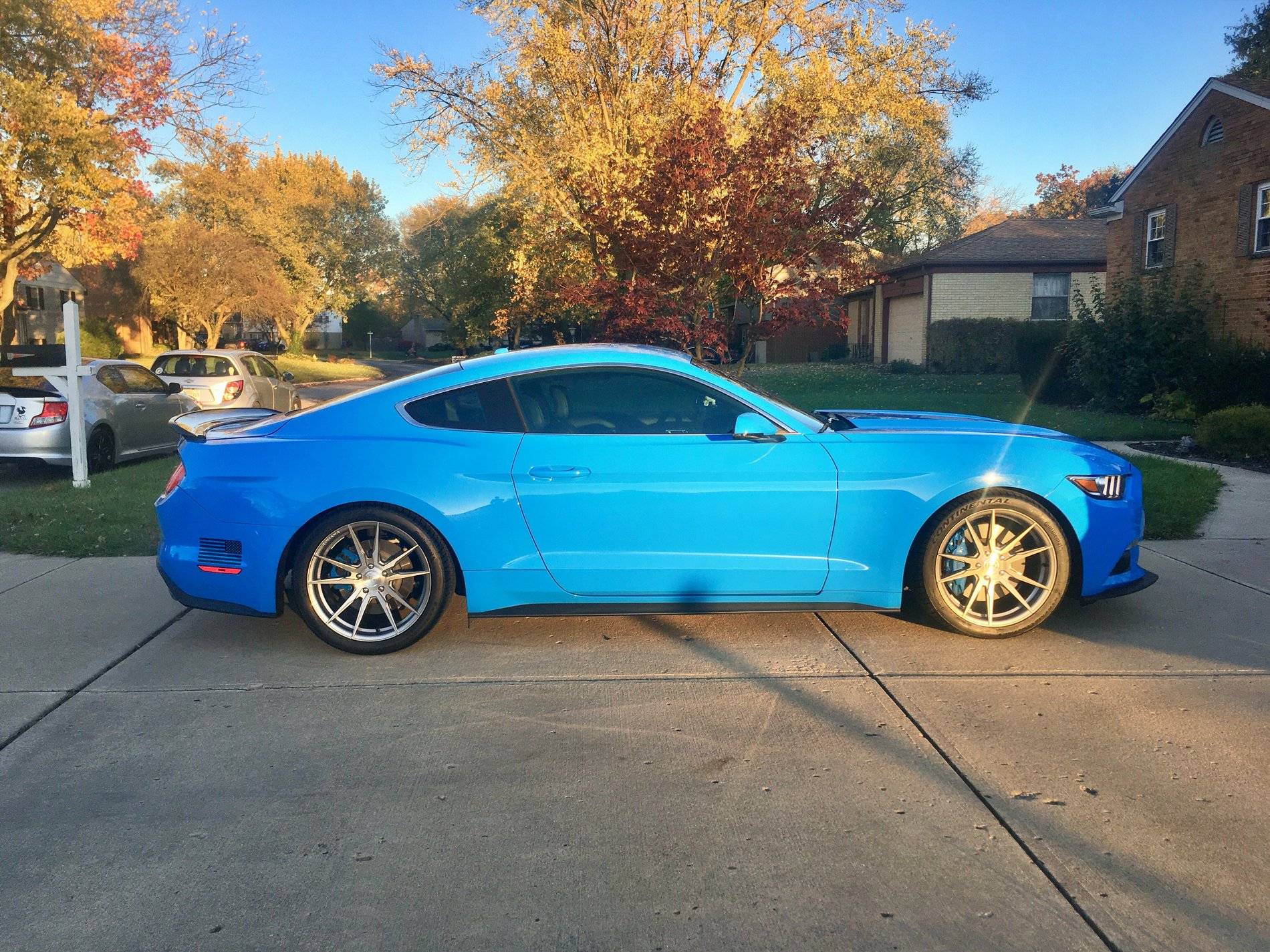

Steeda all day. if cost was the same Steeda rocks it. I am on 285/35/19
Steeda pro struts/shocks + progressive springs. EcoBoost are a little difference stance in front due to lighter engine though. you should be a hair deeper than me.
