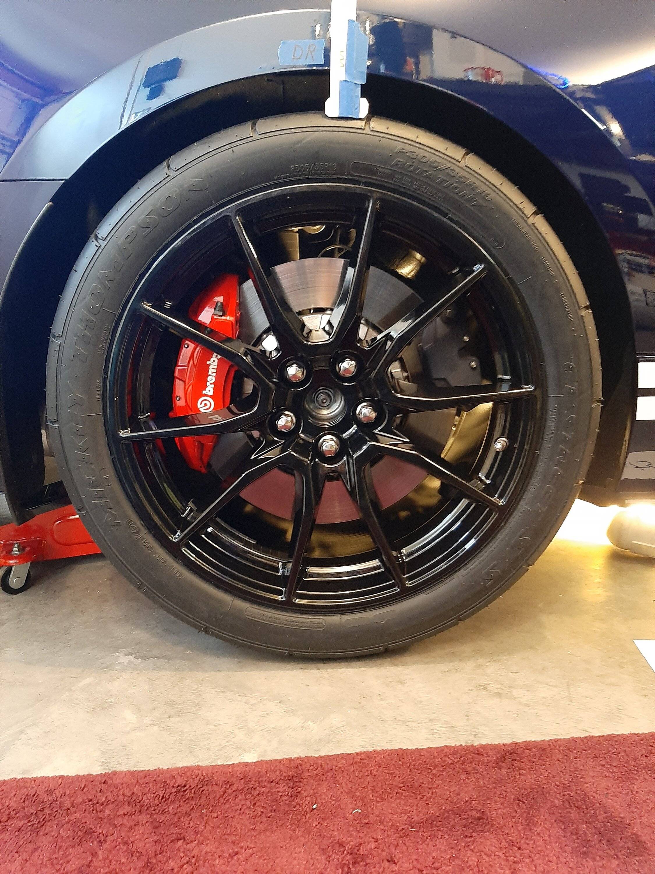

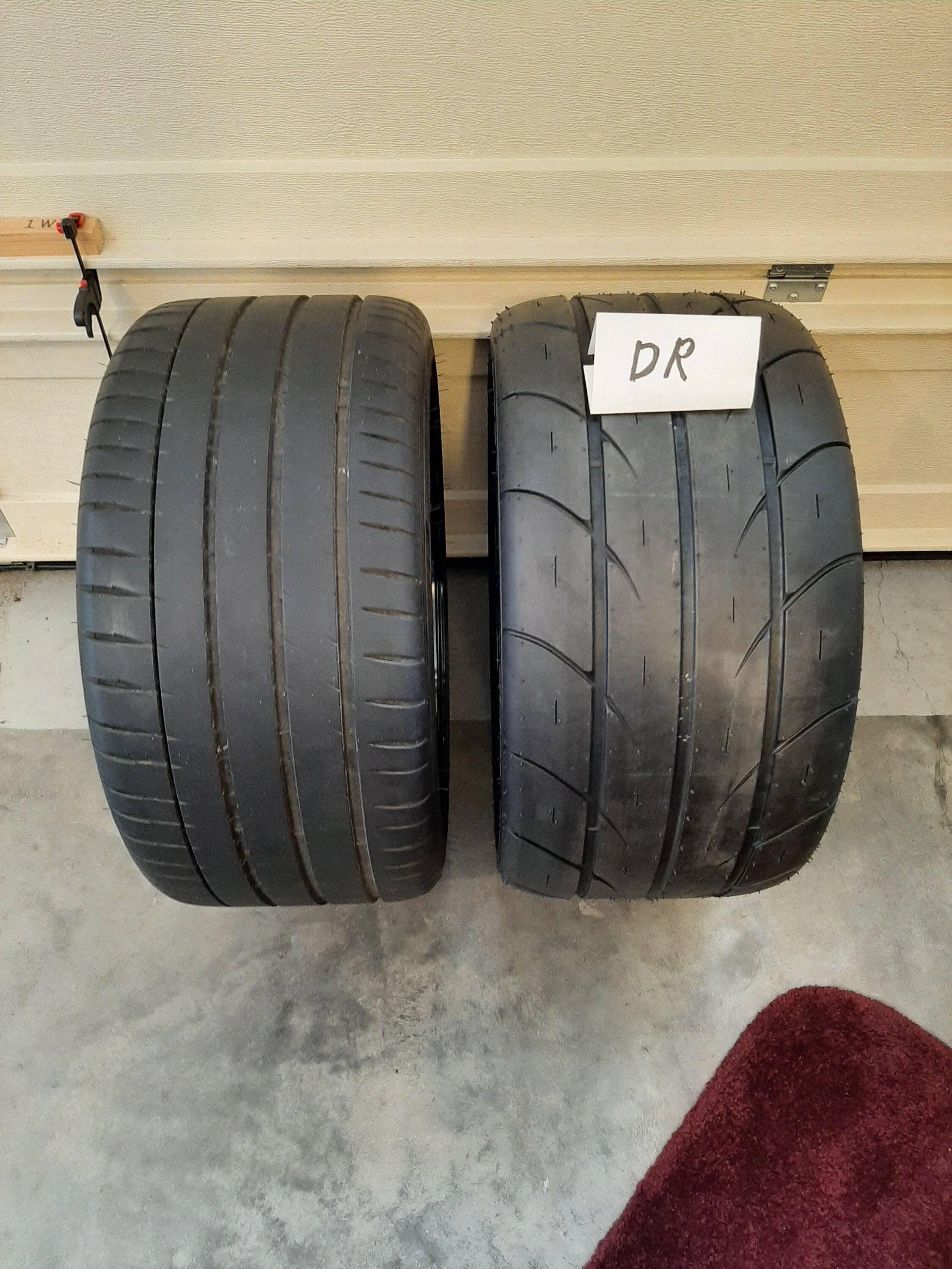

To get a stickier tire, I used 11x19" gt350 wheels and mounted MT ET Street SS in 305/35-19 DRs.
Their height is 27.2" and when aired down, their width is very close to the to the stock 315-20.
I was going to use MT 325/30-19, but MT discontinued manufacture of them.
