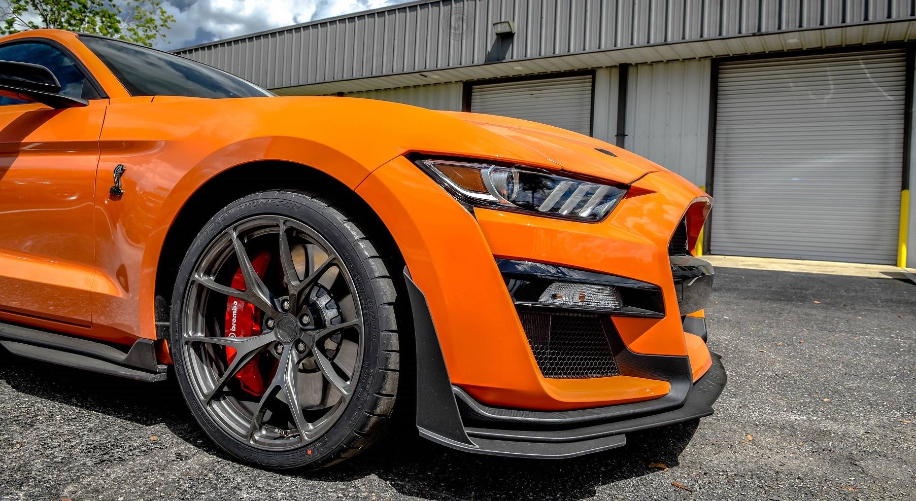

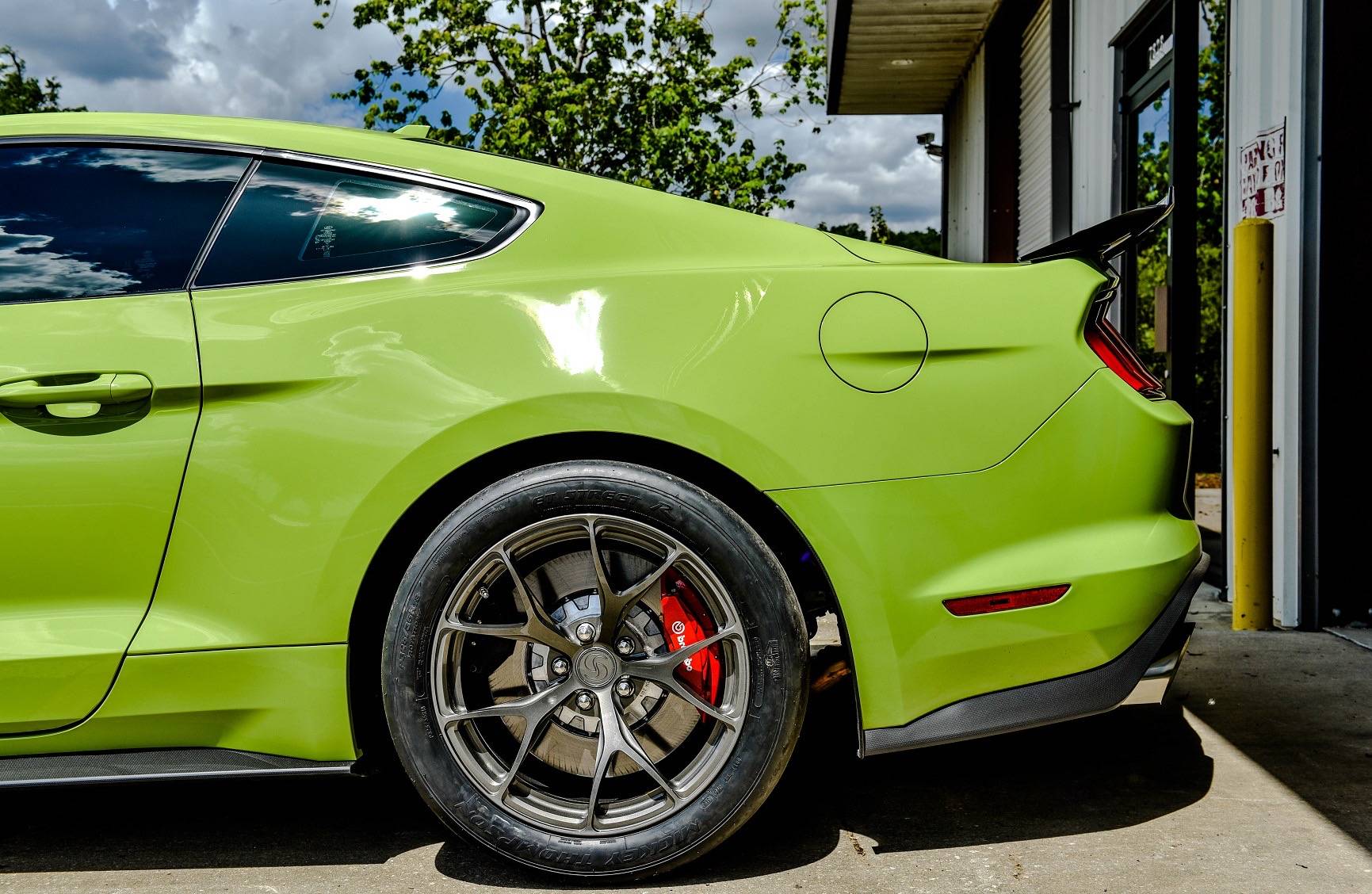

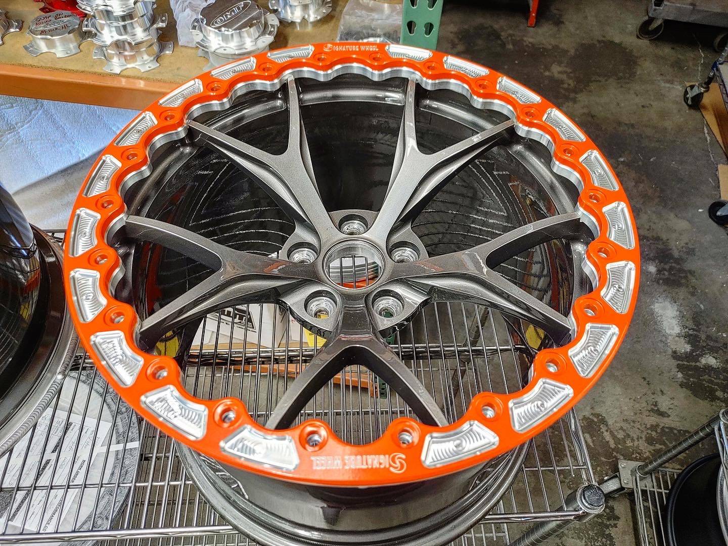

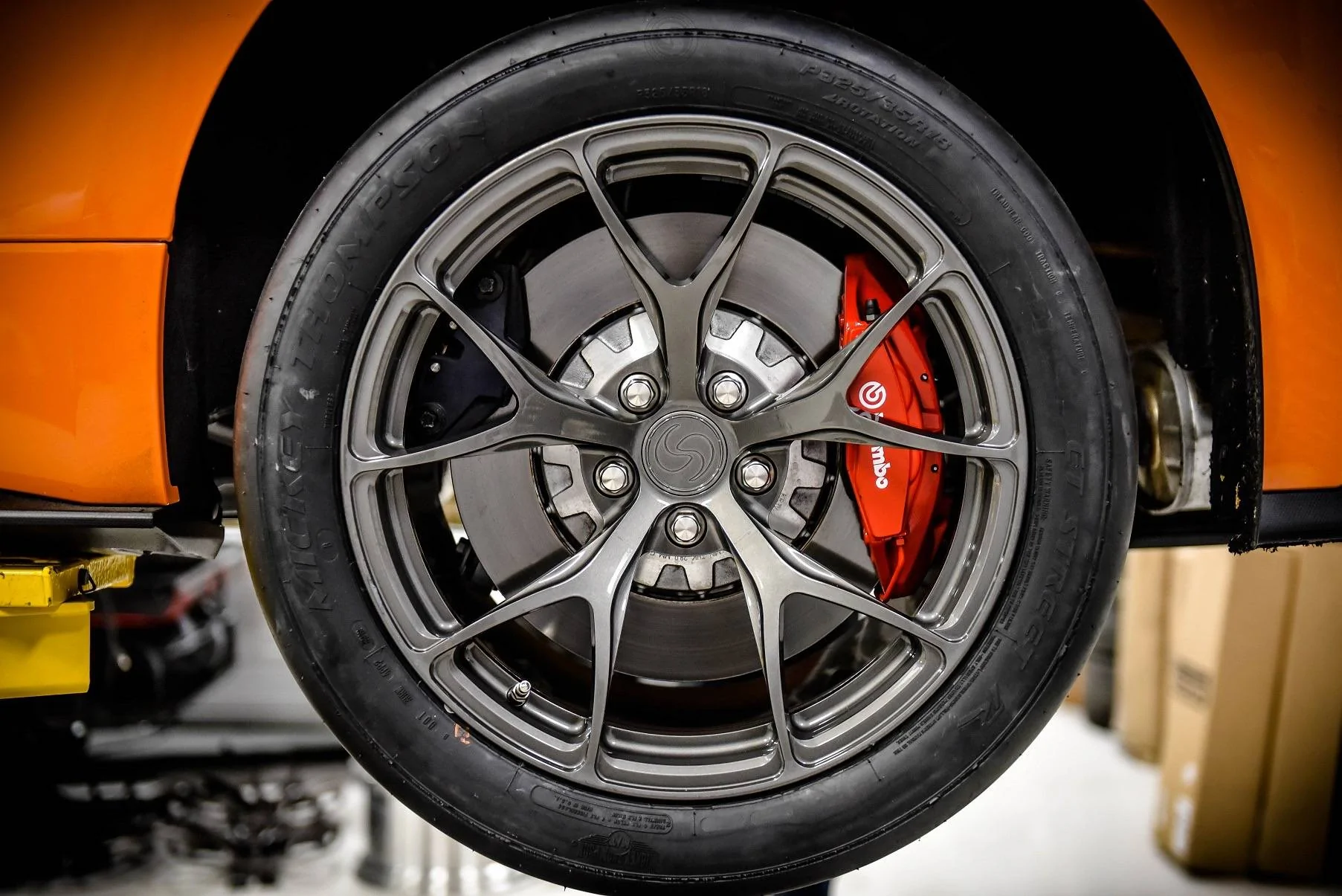

I can build you any of our Signature Wheel 18” Monoblock wheels to clear the rear brakes on the GT500/GT350. If the car is drag focused we can also build a 20x8 front runner.
Wheels are customizable for any width and offset you need. No modifications needed to the brakes or lug nuts. We have even gone so far as to add a bead lock option. Also working with Cortex to develop a custom low profile vertical link to add more clearance at the wheel barrel and reduce deflection/wheel hop
