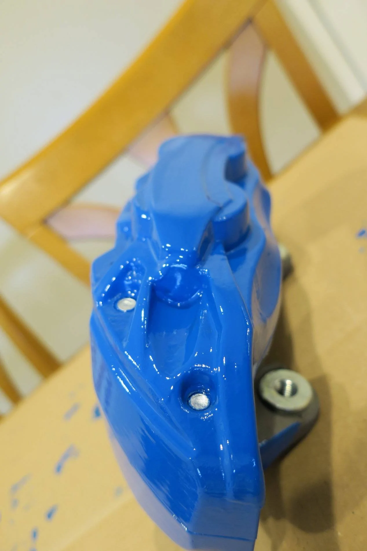

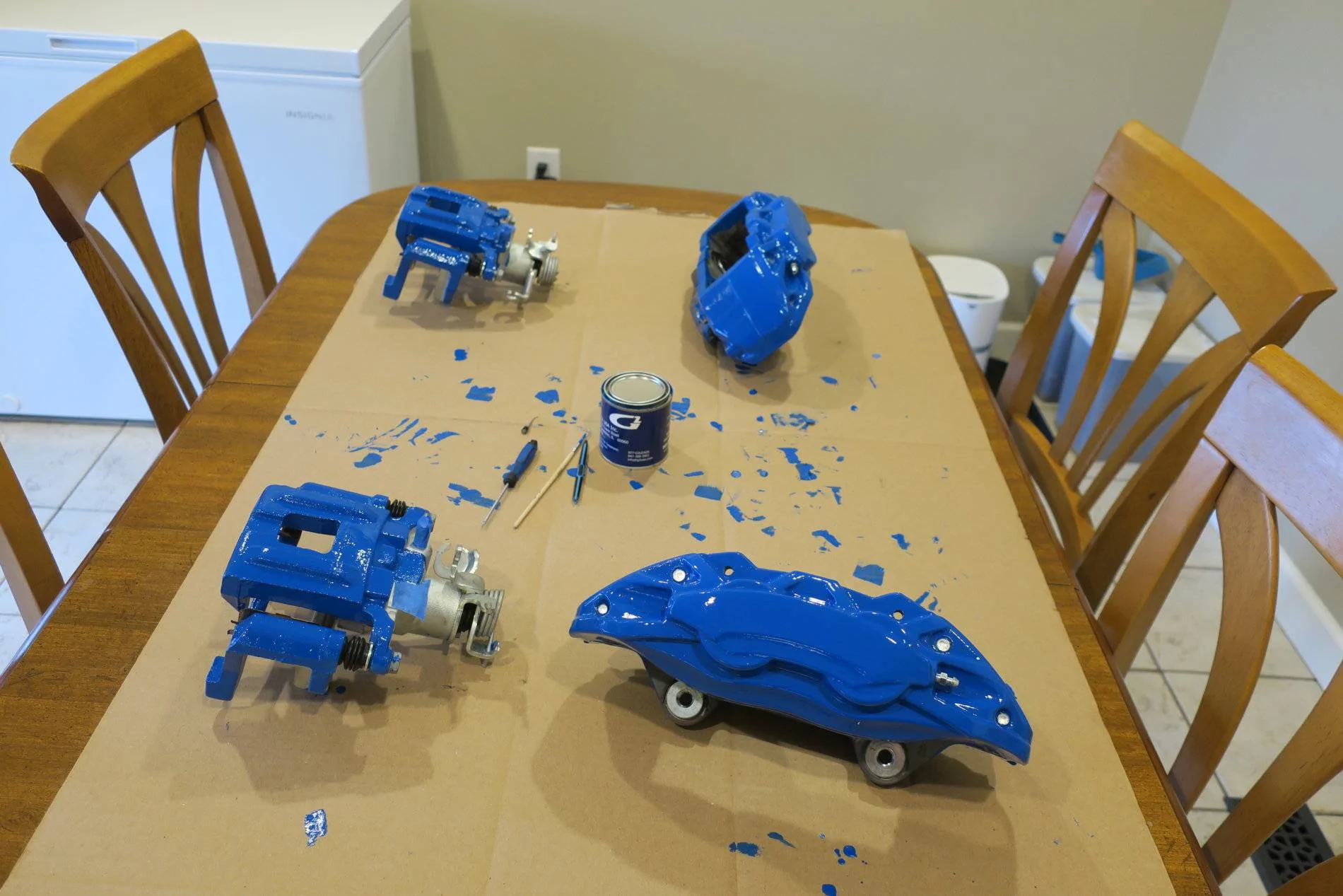

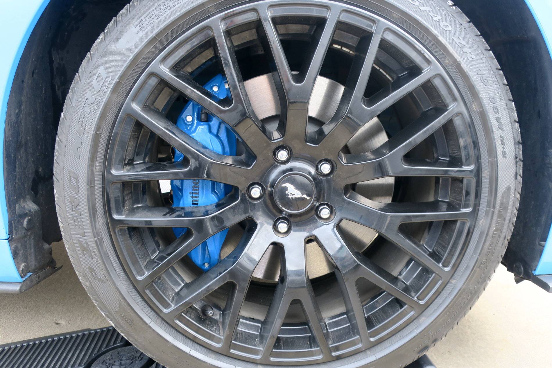

I plan to brush paint mine red, with that two-part epoxy paint. I’ll do them on the car, without disconnecting the brake lines so I won’t have to bleed them when I’m done. I’ll probably pull them off the rotors so I can reach the back sides.
Did this with my front Brembos G2 Red and they look great. I would recommend getting a couple more cans of Brake Cleaner besides the one that comes in the kit and also better brushes - I used the 1" wide foam brushes, was easy peasey. Just clean them REALLY well and you will be good to go.

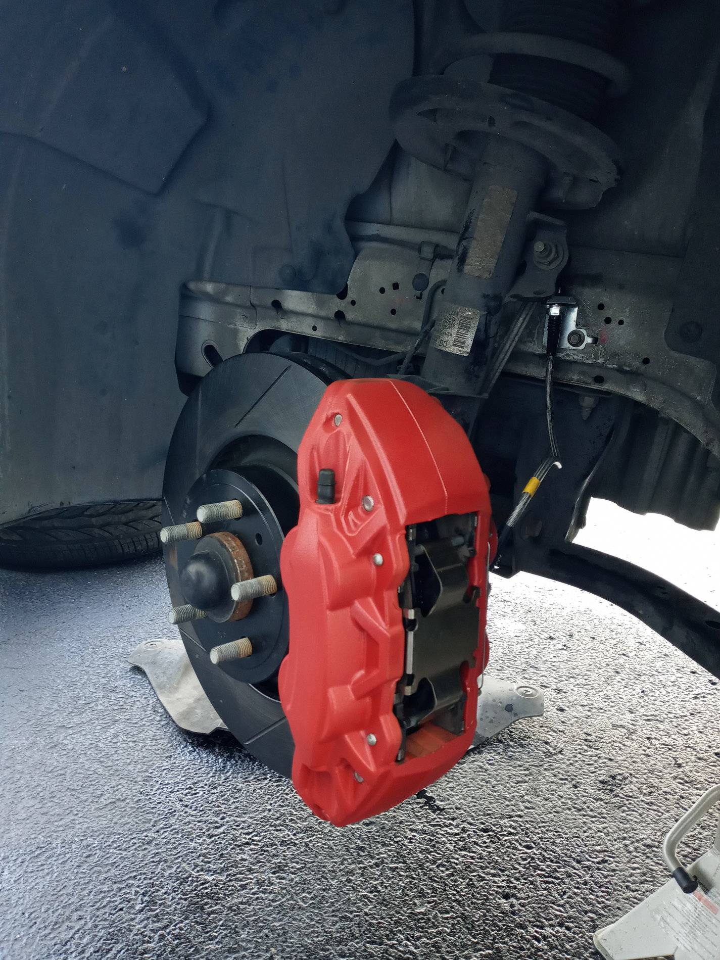

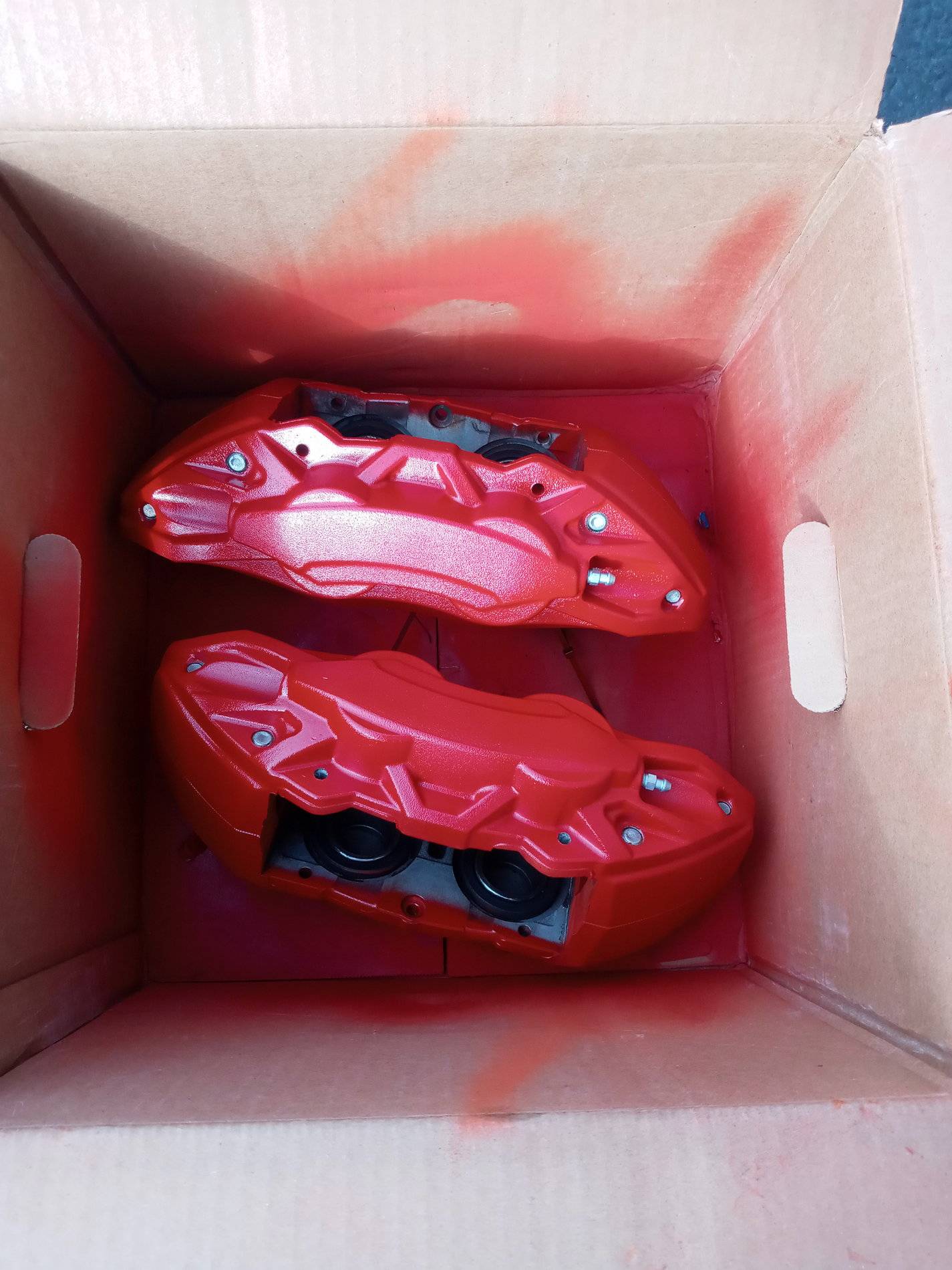

I did spray on, 2 coats of VHT engine flat red and it was more orange, so did a coat of VHT caliper red.
Masking off the through bolts was a PITA though.
