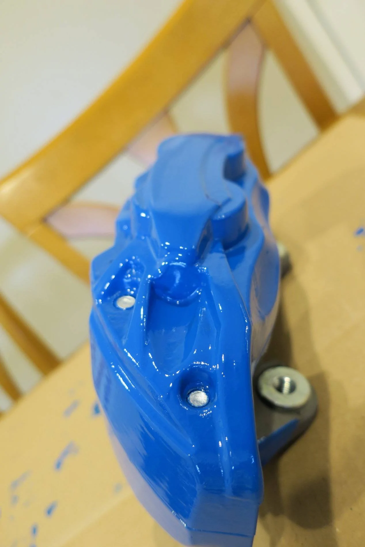

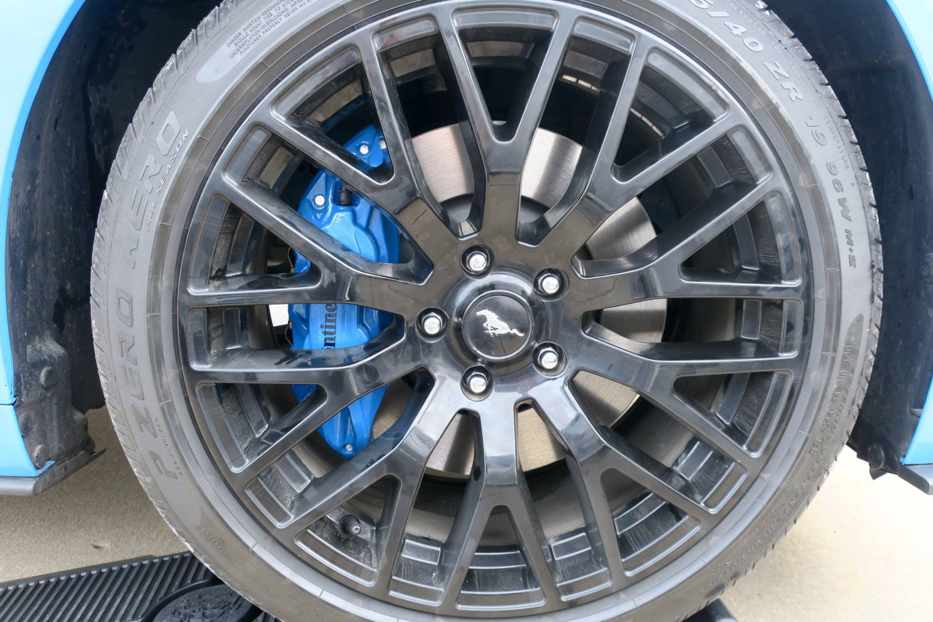

Here was mine and how I did the g2
Still looked perfect til I sold it. Was super easy to clean too. Never had any issues with chipping or cracking.
imo key is cleanliness and dust free environment, I personally just kept rotating to next one in a circle with foam brush and put down nice heavy coats and it rolled:smoothed evenly for most part.
for 55 bucks I was happy
