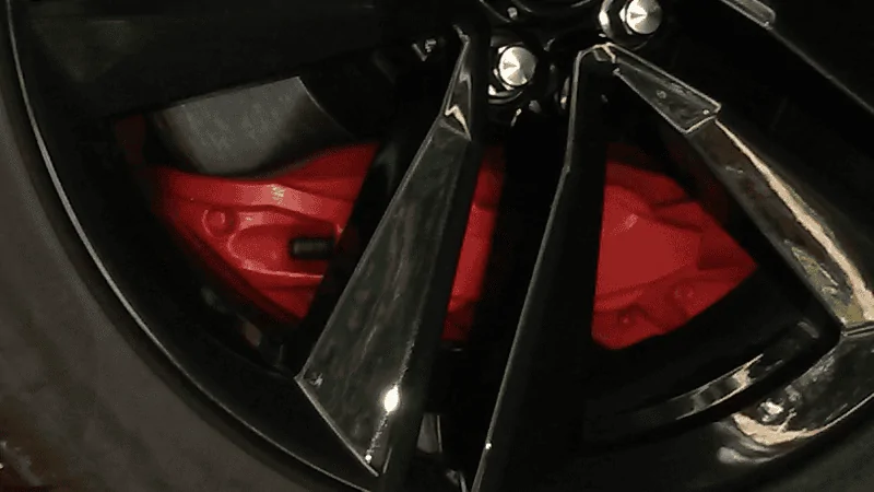

The cast surface of the caliper is so rough you won't see any difference between brush and spray.
This is brushed on;

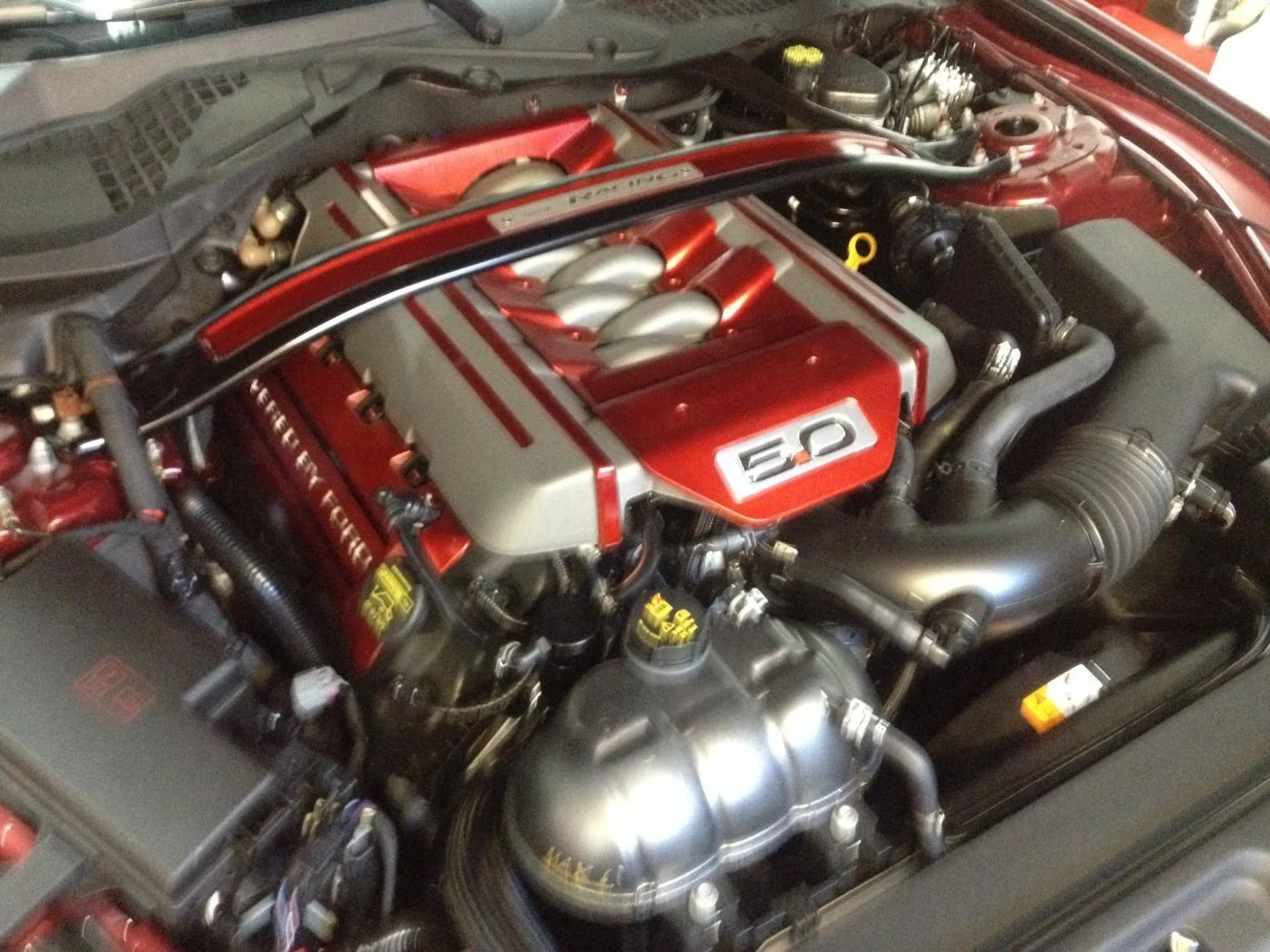

as close to ruby red is using duplicolor metal cast silver base and red overcoat

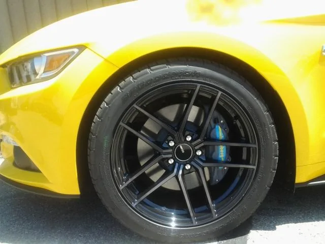

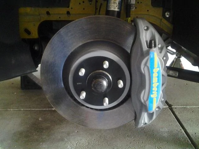

I used a high-heat primer, and then stopped there. But I would not be afraid to try any non-high-heat-rated spray paint over that.
In fact I put some graphic vinyl on my calipers! I bet they will survive autocross runs, but I am not so sure about a track event, lol.

I think I have it narrowed down to the last two colors I posted. Can you can confirm GMB Racing? The match on your shroud looks spot on.
Red Anodized Metalcast
11 oz. Aerosol
Looks good! I am going to use some hi-temp stickers as well. If I can get the RR going I am going to use a gloss black pony with a flat black GT sticker laid over it. I am hoping it looks good and it all doesn't melt off lol!
