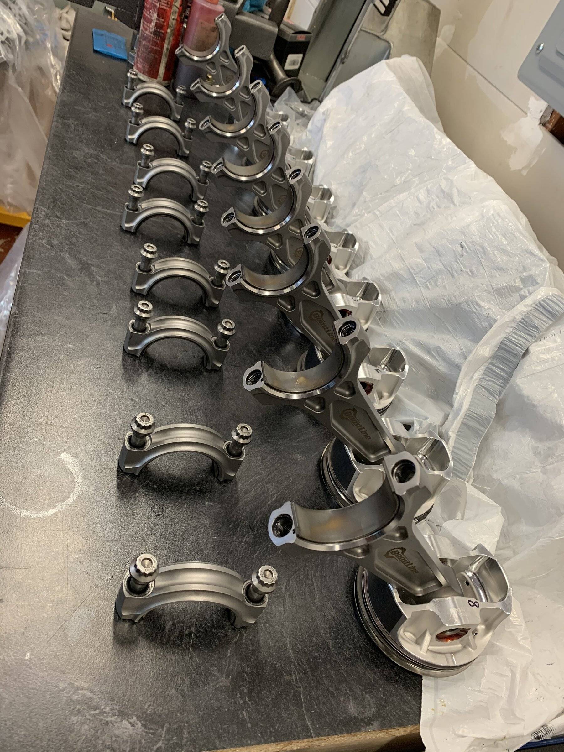

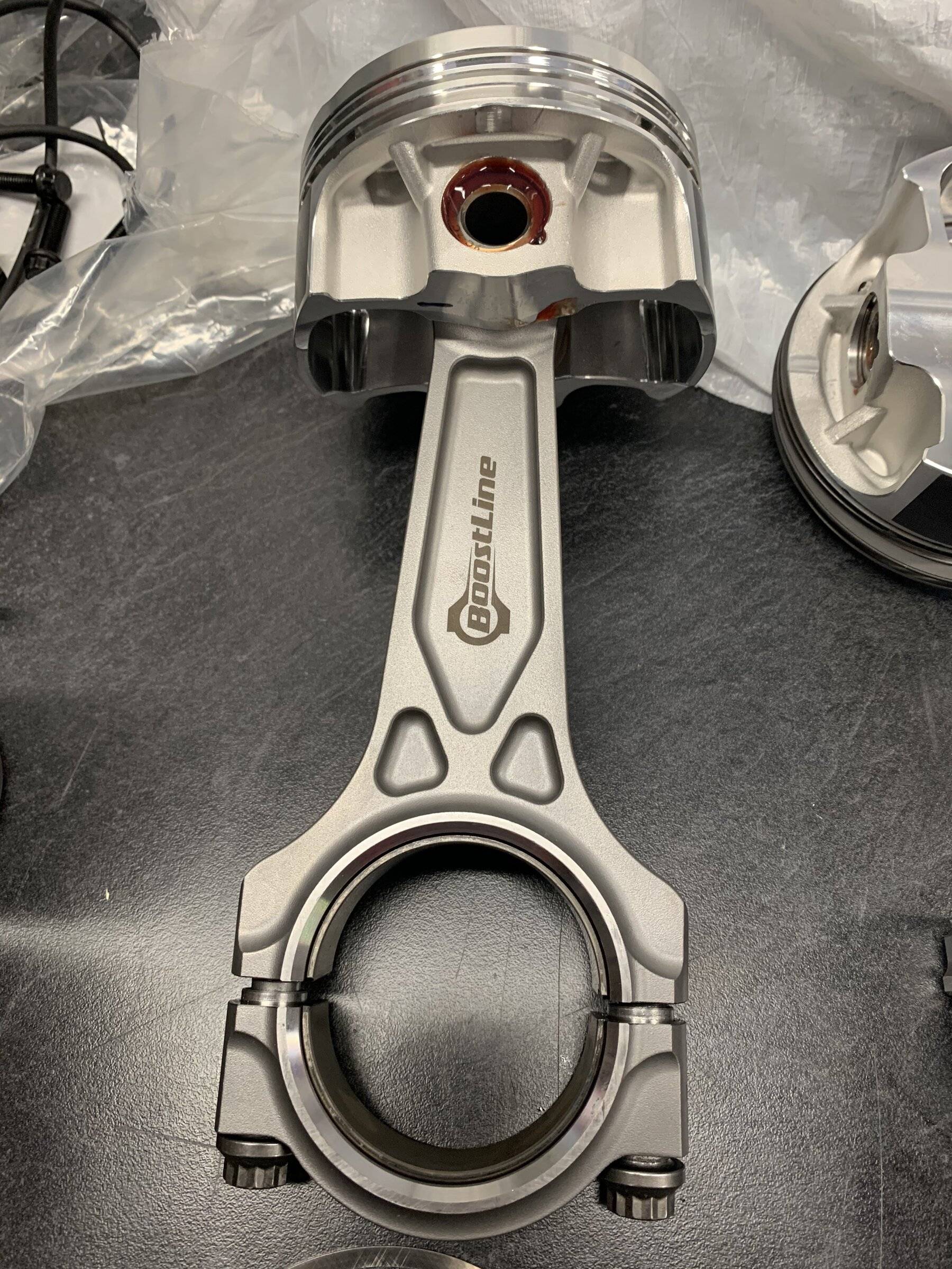

Thanks, I didn’t check the specs yet . Glad to know the pin size is different as I already have a set of Boostline Rods. i have had good luck with JE and Diamond in the past. Never had experience with Mahle or Manley other then Their Rods.

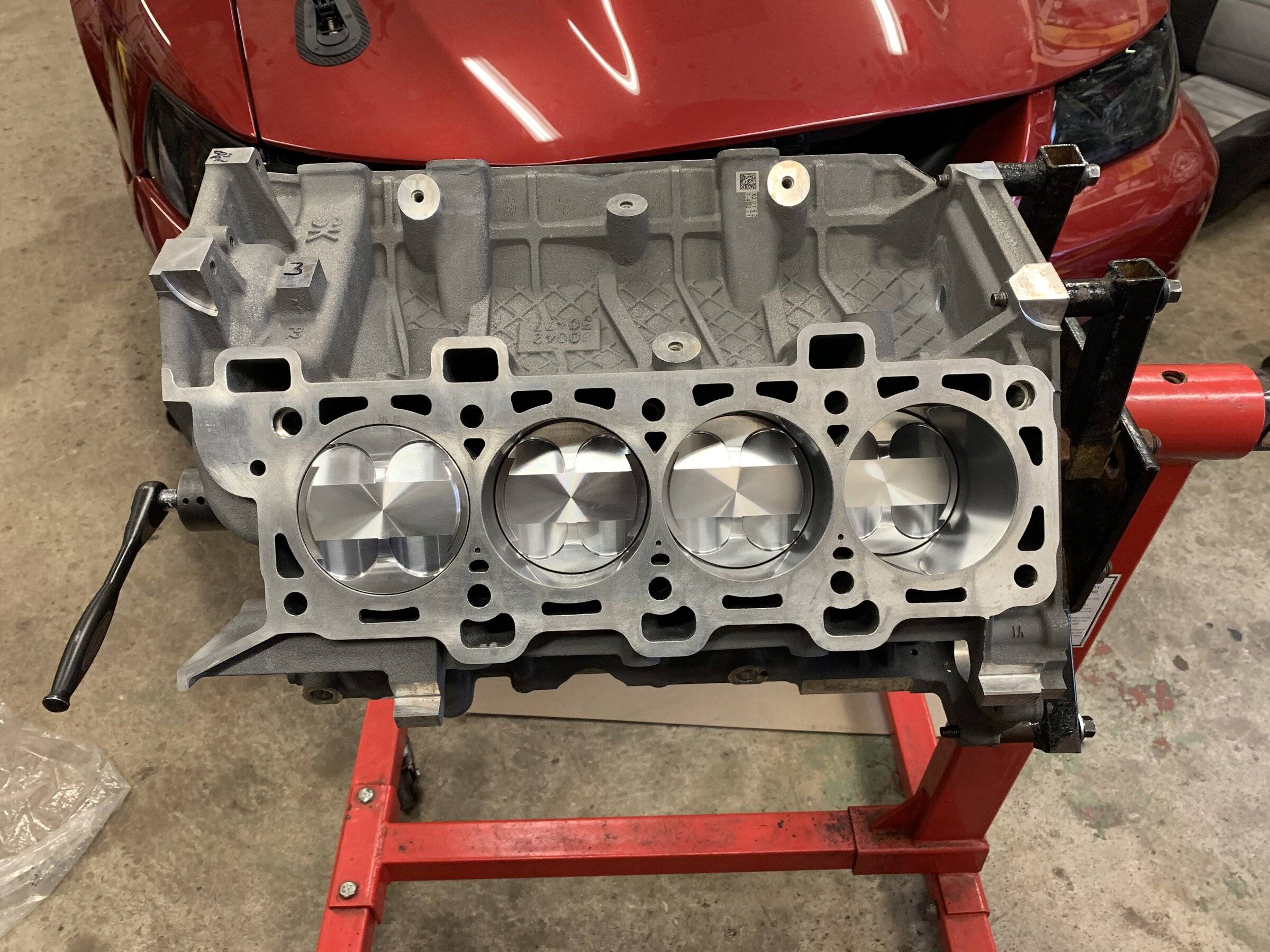

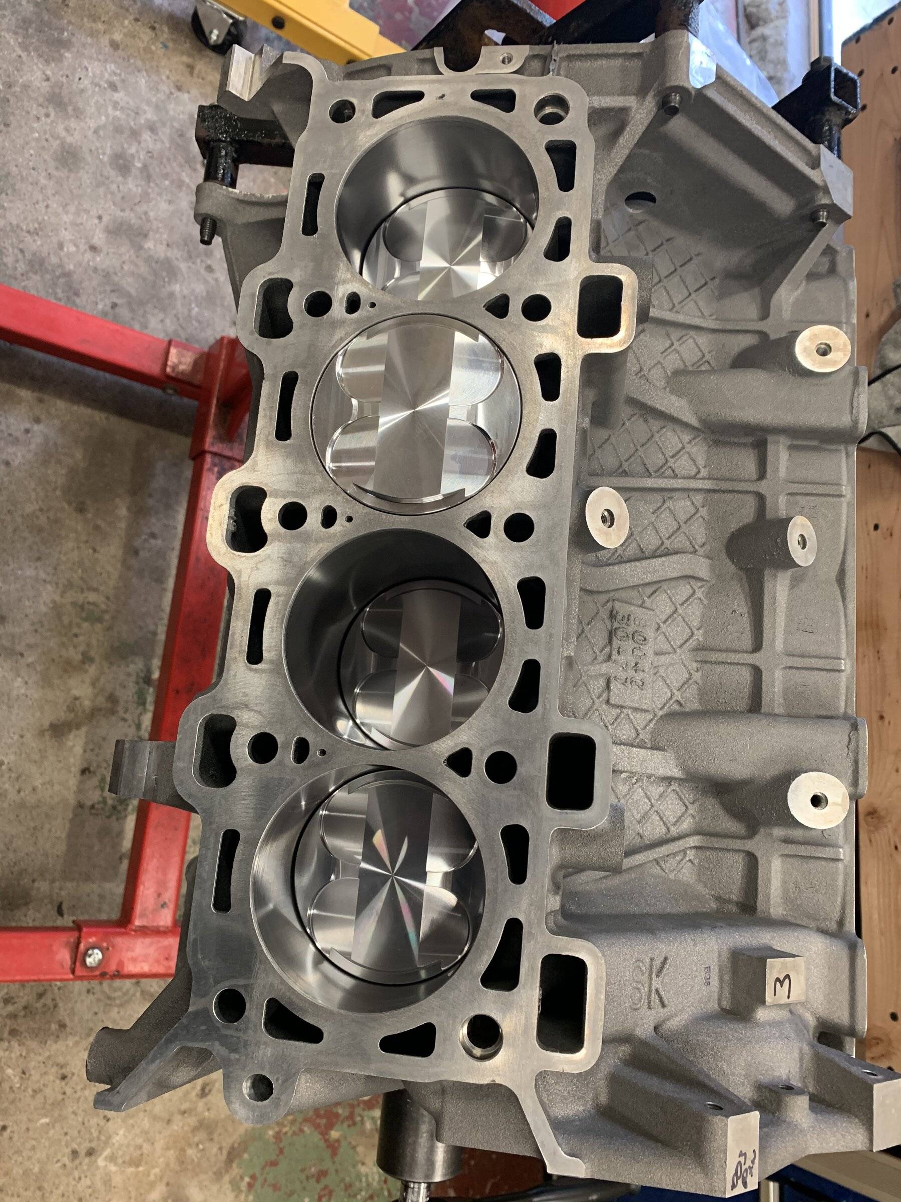

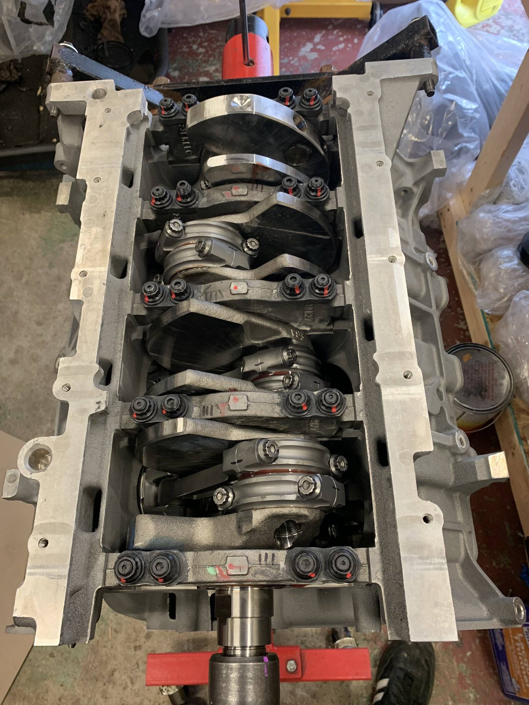

good choice - that’s the combo in my ā€œspareā€ šŸ˜Ž
